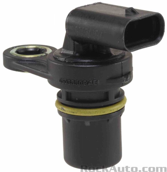

2.4journey2013 Posted August 20, 2020 Author Report Share Posted August 20, 2020 Looks like p0302 is gone but now I have p000a/b codes which is slow camshaft response. The oil looks very dirty so I'll be changing it fresh to see if that helps their response. If not looks like I'll be replacing the sensors. My question is, when purchasing the camshaft sensors are they the same 2 camshaft sensors for p000a and p000b just in different locations? Quote Link to comment Share on other sites More sharing options...
John/Horace Posted August 20, 2020 Report Share Posted August 20, 2020 Oil shouldn’t affect a cam sensor as far as I know. But oil changes are cheap necessary maint. Looks like both sensors are the same, not expensive either. Only one sensor listed on sites, says two required. https://www.rockauto.com/en/catalog/dodge,2013,journey,2.4l+l4,1505072,ignition,camshaft+position+sensor,7192 Quote Link to comment Share on other sites More sharing options...
2.4journey2013 Posted August 20, 2020 Author Report Share Posted August 20, 2020 Sounds good. Yeah the misfire code is gone and it threw a p000a and p000b. The car oil is not just dirty but was mixed viscosity, etc. I was reading that incorrect viscosity as well as dirty oil could effect the VVT Which would throw a code for Camshaft sensors in newer cars. I think I remember the slow camshaft response code sometime before and the owner got an oil change and I reset the PCM and those two P000a/b codes were gone until recently. Quote Link to comment Share on other sites More sharing options...

2.4journey2013 Posted August 23, 2020 Author Report Share Posted August 23, 2020 Update: will be replacing both camshaft sensors either today or tomorrow and will reset the PCM to verify it has eliminated the check engine codes. Quote Link to comment Share on other sites More sharing options...
2.4journey2013 Posted August 26, 2020 Author Report Share Posted August 26, 2020 Final conclusion: -replaced both camshaft sensors fresh oil change Just test drove around for an hour. *no more check engine (misfire) thanks! OhareFred and John/Horace 1 1 Quote Link to comment Share on other sites More sharing options...
