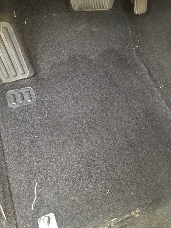

tonyswitchblade Posted August 11, 2020 Report Share Posted August 11, 2020 So i have a leak into the cabin soaking the floor. I included some pictures what i really need is were are the drains i should clean out attached are photos Quote Link to comment Share on other sites More sharing options...

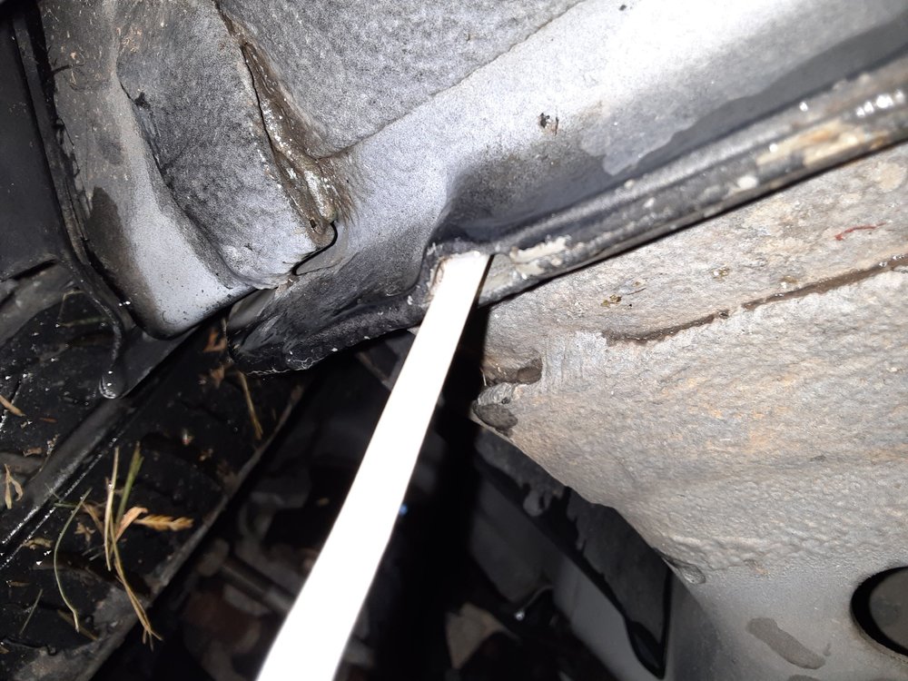

tonyswitchblade Posted August 11, 2020 Author Report Share Posted August 11, 2020 Are the drains in this picture or should i be looking somewhere else. Quote Link to comment Share on other sites More sharing options...
tonyswitchblade Posted August 11, 2020 Author Report Share Posted August 11, 2020 Quote Link to comment Share on other sites More sharing options...
OhareFred Posted August 11, 2020 Report Share Posted August 11, 2020 (edited) The white things are not drains, they are the receivers for the door sill trim Edited August 11, 2020 by OhareFred Quote Link to comment Share on other sites More sharing options...
tonyswitchblade Posted August 11, 2020 Author Report Share Posted August 11, 2020 Yeah thats just where the water comes from inside. The other pictures are under the car. I tried cleaning those holes with a ziptie but still had the water coming in Quote Link to comment Share on other sites More sharing options...

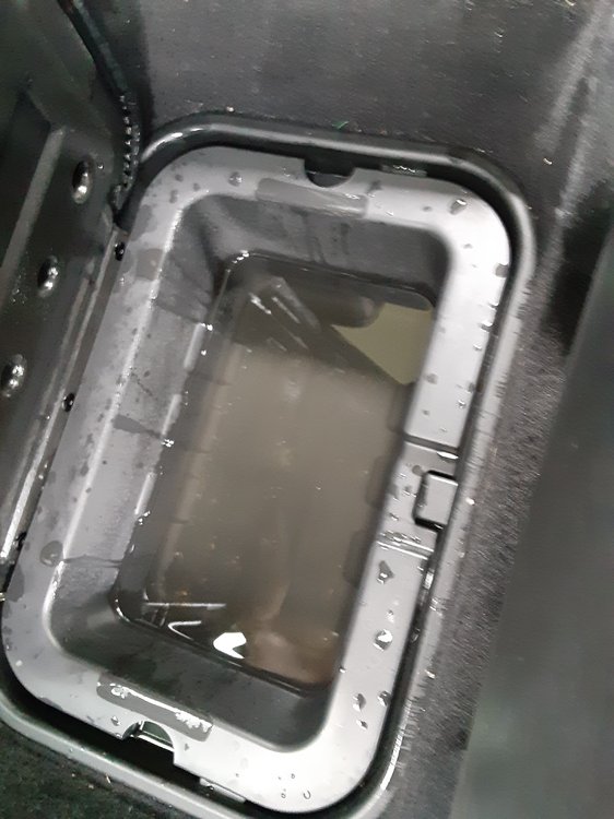

pixistick1605 Posted December 19, 2022 Report Share Posted December 19, 2022 Hello to all. I know this thread is a little old, but I wanted to add my findings to help someone out who may be searching online for an answer. I had this very same issue on my 2016 Dodge Journey Crossroad. After it rained, my car had a musty smell, soaked on driver's side (front and rear) and the rear driver's side storage bin would be full of water. I finally took it to the local dealership today and was advised it was the "Plenum Chamber." To have it replaced and including labor, it was $385 (South Florida) as that is not covered under my extended warranty. It's supposed to rain here for the next 3 days so if the problem isn't resolved, I'll take it back to the dealer and advise. If no updated post from me, the problem was fixed. I also want to note that the area at work that I park at has a LOT of trees. Quote Link to comment Share on other sites More sharing options...

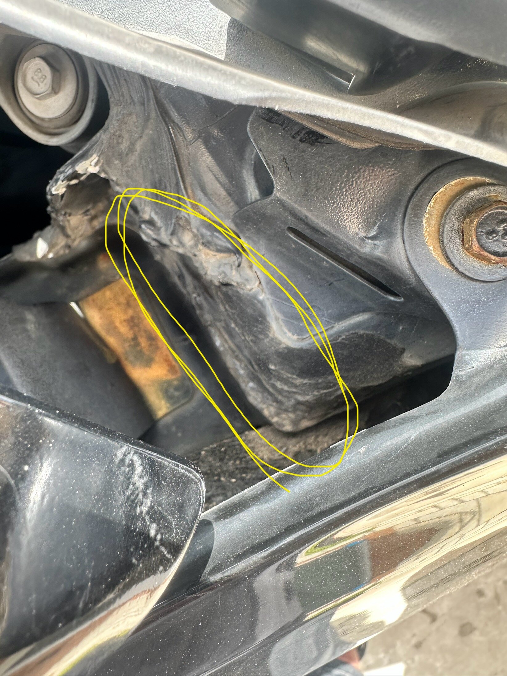

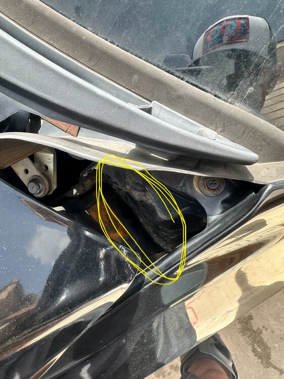

Itswiggs Posted July 31 Report Share Posted July 31 So I had this same exact issue, wet ds floor board and rear ds bottom storage full of water. After digging up an old video on YouTube I learned that it is a seam just below the ds windshield cowel. Hit it with some silicone and problem solved 2late4u 1 Quote Link to comment Share on other sites More sharing options...
