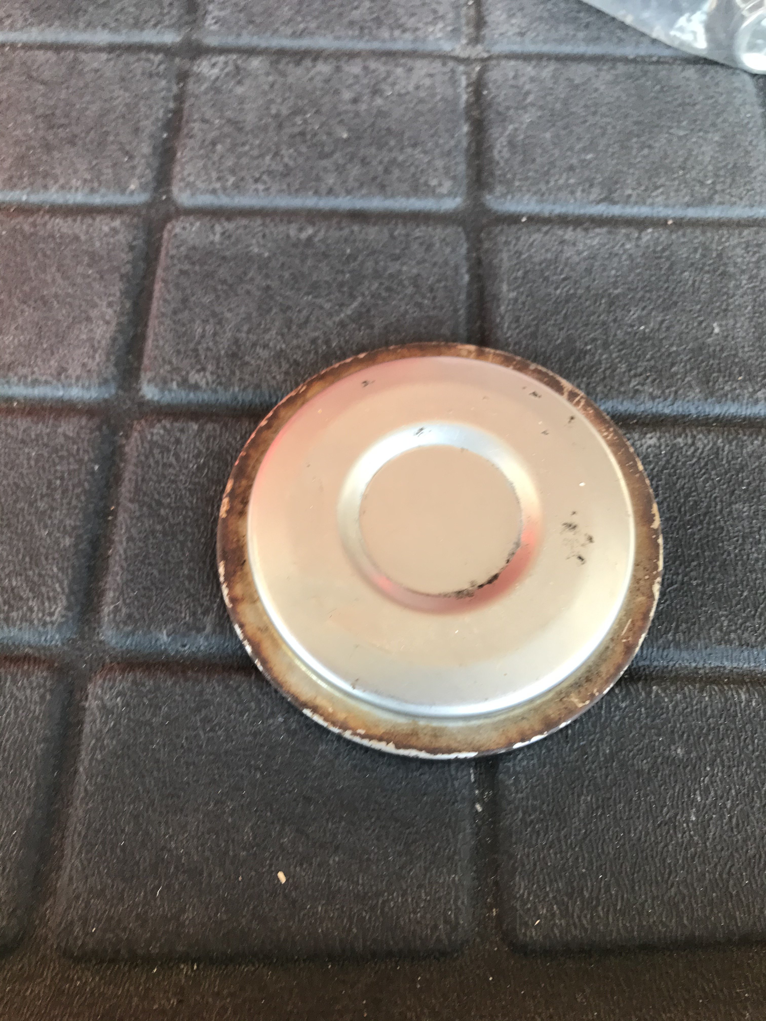

probak118 Posted November 28, 2020 Author Report Share Posted November 28, 2020 (edited) Replaced both rear wheel bearing hubs this morning with SKF not the MOOG brands. Again heavy pounding, slide hammer, and plenty of penetrating spray involved. the OEM hubs removed had a dust type cover on the back sides but none on the replacements. so, we removed from the OEM and silicone them on the installed SKF. seemed just the right thing to do, maybe not needed but we did. see attached images. Used one minute gasket material to hold cap in place and sprayed rubber sealant to seal the edges of the installed dust cap. there was no way of this dust cap being installed to the hub like the OEM hub. Is it possible the hub is universal and could be used on a AWD also ? Edited November 28, 2020 by probak118 2late4u and larryl 2 Quote Link to comment Share on other sites More sharing options...

John/Horace Posted November 30, 2020 Report Share Posted November 30, 2020 There is no separate listing for wheel hub bearing for fwd versus awd, so they appear to be interchangeable. Wheel bearings have rubber gaskets behind the metal bearing covers that you see from the sides. If you gently pry back the side covers you can see them on the edges of metal side shields. Extra McGyver cover you added certainly won’t hurt, could help a bit. Cover might fit an OEM Mopar wheel bearing hub. Double check those rear calipers for sticking parking brake assembly. They seem to have a tendency to drag a bit and not fully release, wheel should spin free with a tiny bit of drag only. If spring not pulling it back enough pads will wear rapidly. Like already mentioned, once the bearing hum starts you do have some time before it becomes dangerous. I have pushed one a month or two without any issues. Depends on distance travelled really. Some mechanics have an ultrasonic tool for measuring bearing noise to make sure bad one is identified. Quote Link to comment Share on other sites More sharing options...
