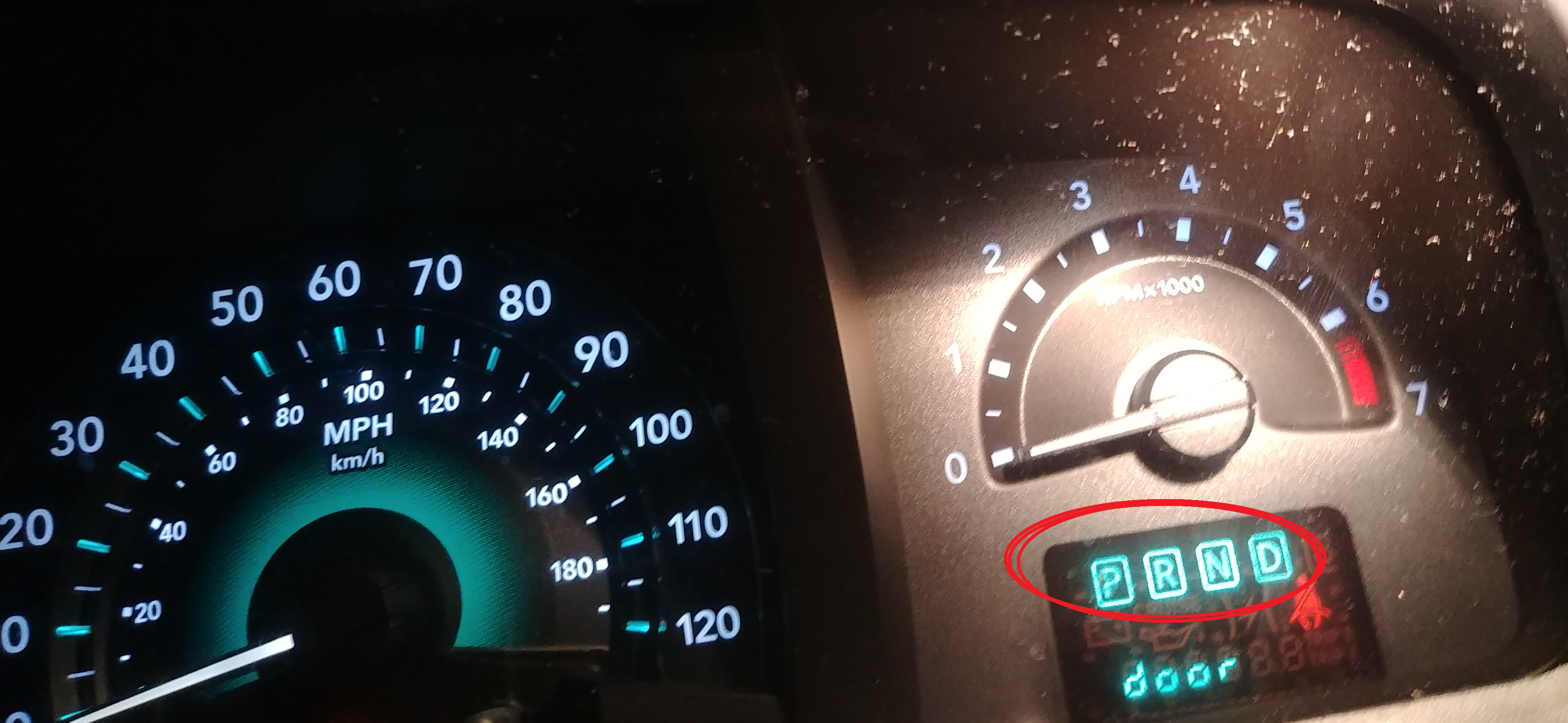

Laur Posted September 17, 2020 Report Share Posted September 17, 2020 no code, no turn over, no sound. is that panel saying my starter is dead? Quote Link to comment Share on other sites More sharing options...
2late4u Posted September 17, 2020 Report Share Posted September 17, 2020 dont know what you are trying to show us? how old is your battery that would be my first thing to check or replace. good luck OhareFred 1 Quote Link to comment Share on other sites More sharing options...
jkeaton Posted September 17, 2020 Report Share Posted September 17, 2020 No, your panel is saying your door is open and your seat belt is not on. OhareFred, 2late4u and 2.4journey2013 1 2 Quote Link to comment Share on other sites More sharing options...

Laur Posted September 21, 2020 Author Report Share Posted September 21, 2020 (edited) On 9/16/2020 at 10:47 PM, 2late4u said: dont know what you are trying to show us? how old is your battery that would be my first thing to check or replace. good luck sorry. the gear position is not normal. battery is Good, I also tried jump starting. Edited September 21, 2020 by Laur Quote Link to comment Share on other sites More sharing options...

5rebel9 Posted October 18, 2020 Report Share Posted October 18, 2020 It's been a month since this thread was started with NO response back from the OP. Stated NO code,NO turnover, NO sound. From his picture of the gear position, would lead me to think bad battery or cable connections(ground or positive). I've seen this a few times with Dodge family minivans. jkeaton and JohnnyRevs 1 1 Quote Link to comment Share on other sites More sharing options...
