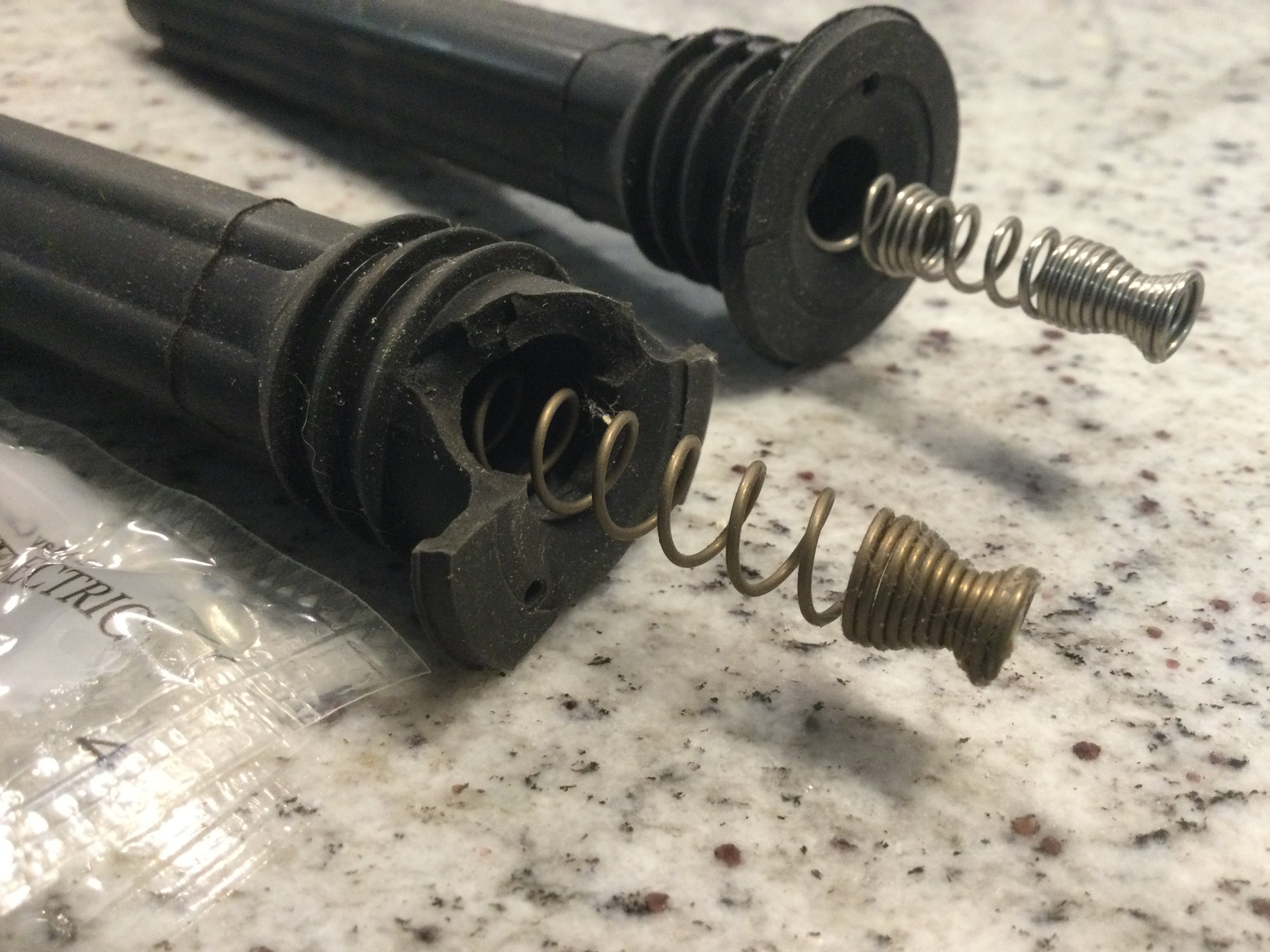

John/Horace Posted December 4, 2020 Report Share Posted December 4, 2020 (edited) Great question. I changed my wife’s 2014 plugs at the same mileage without codes. If you can’t get a good price on the dealer plugs. I used the NTK plugs without any issues turning up. I’m not a fan of Bosch parts on anything but German cars (which I have owned). I think OEM stuff is usually the best, provided I’m not getting gouged I try to use them. I reused my coils but I did have one of the rubber spark plug extension adapters get damaged during removal. They call them coil on boot plugs, they can be tough to remove; I would have a least one on hand before you start job. Pain to chase parts afterwards. The boot adaptor can be bought individually. My plan is to replace all coils on the second plug change, if we still own the vehicle. The coils are an electrical/electronic part. This type of part can experience something called electronic crib death; basically failure in the first few hours or minutes of use. The combination of Bosch aftermarket and possible early part failure would make me pass. Free advice worth everything you pay for it. Edited December 4, 2020 by John/Horace Quote Link to comment Share on other sites More sharing options...

John/Horace Posted December 4, 2020 Report Share Posted December 4, 2020 (edited) The replacement boot adapter was around $8 with tax for one of them. Lot's of twisting and a warm day helps them slide off. I have heard running the plugs beyond proper change interval can be hard on coils. Larger gap extra arcing etc. If you were at 150-200 on original plugs I would have said change coils. Edited December 4, 2020 by John/Horace John Smallberries 1 Quote Link to comment Share on other sites More sharing options...
