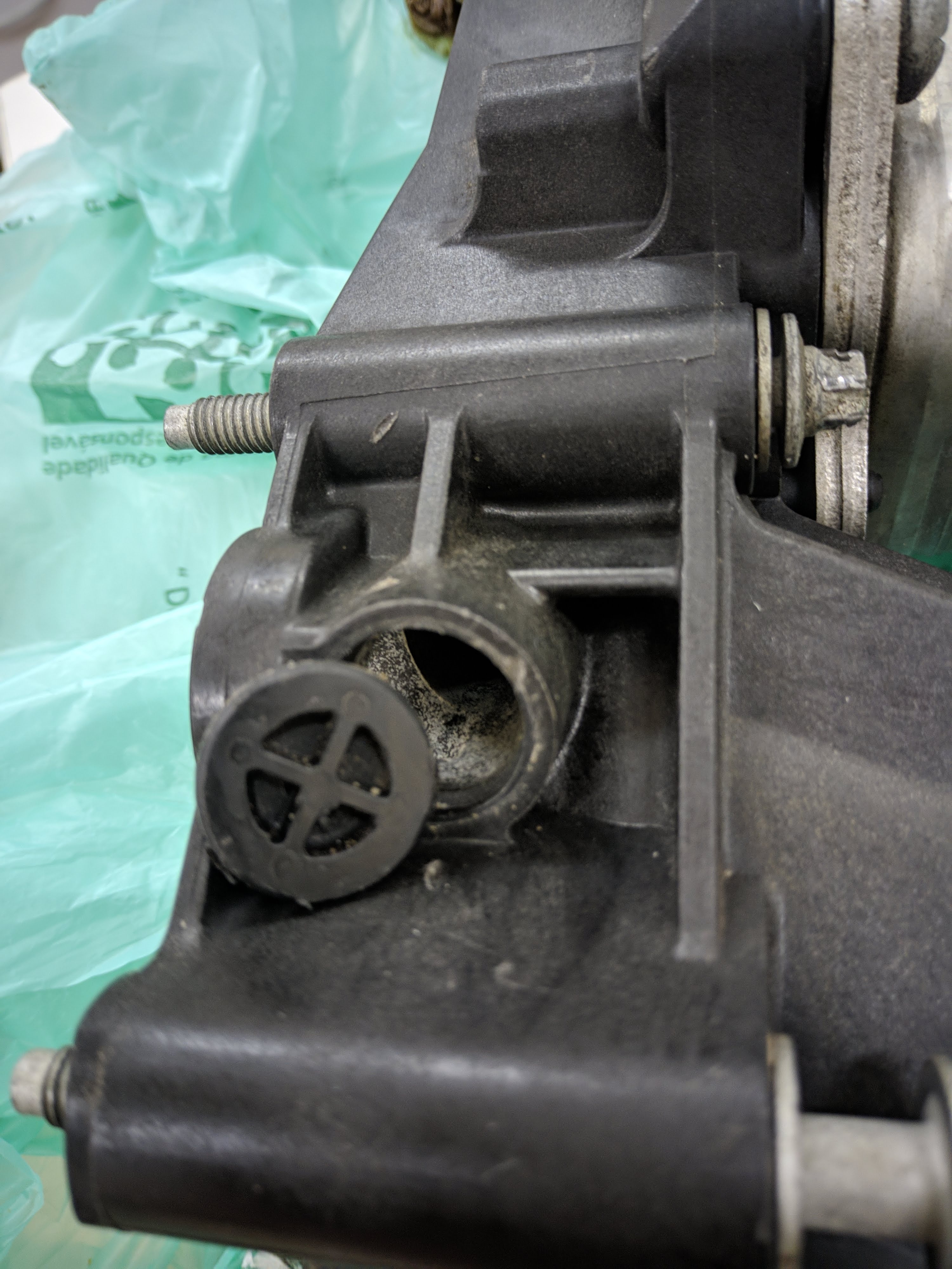

agm2112 Posted October 21, 2020 Report Share Posted October 21, 2020 (edited) Go straight to that damned oil cooler. I had this same problem, almost destroyed my engine. I believe the 2012 model doesn't have that plastic seal, but the plastic may have cracked or something like that. Edited October 21, 2020 by agm2112 added images Quote Link to comment Share on other sites More sharing options...
5rebel9 Posted October 21, 2020 Report Share Posted October 21, 2020 39 minutes ago, agm2112 said: Go straight to that damned oil cooler. I had this same problem, almost destroyed my engine. I believe the 2012 model doesn't have that plastic seal, but the plastic may have cracked or something like that. That had to be some failure! Yes I hit the point in my response to check for leak at the oil cooler(which uses radiator coolant) to be checked. Thanks for the "back up" and pic of a possible failure point for the OP. Sorry to have read your thread and what you went thru. NavalLacrosse and jkeaton 1 1 Quote Link to comment Share on other sites More sharing options...
cbeja Posted October 22, 2020 Author Report Share Posted October 22, 2020 @agm2112 had someone come and look at it today! You are absolutely right! It is the oil cooler and O rings. Any idea what cost will be looking like for us? Quote Link to comment Share on other sites More sharing options...
