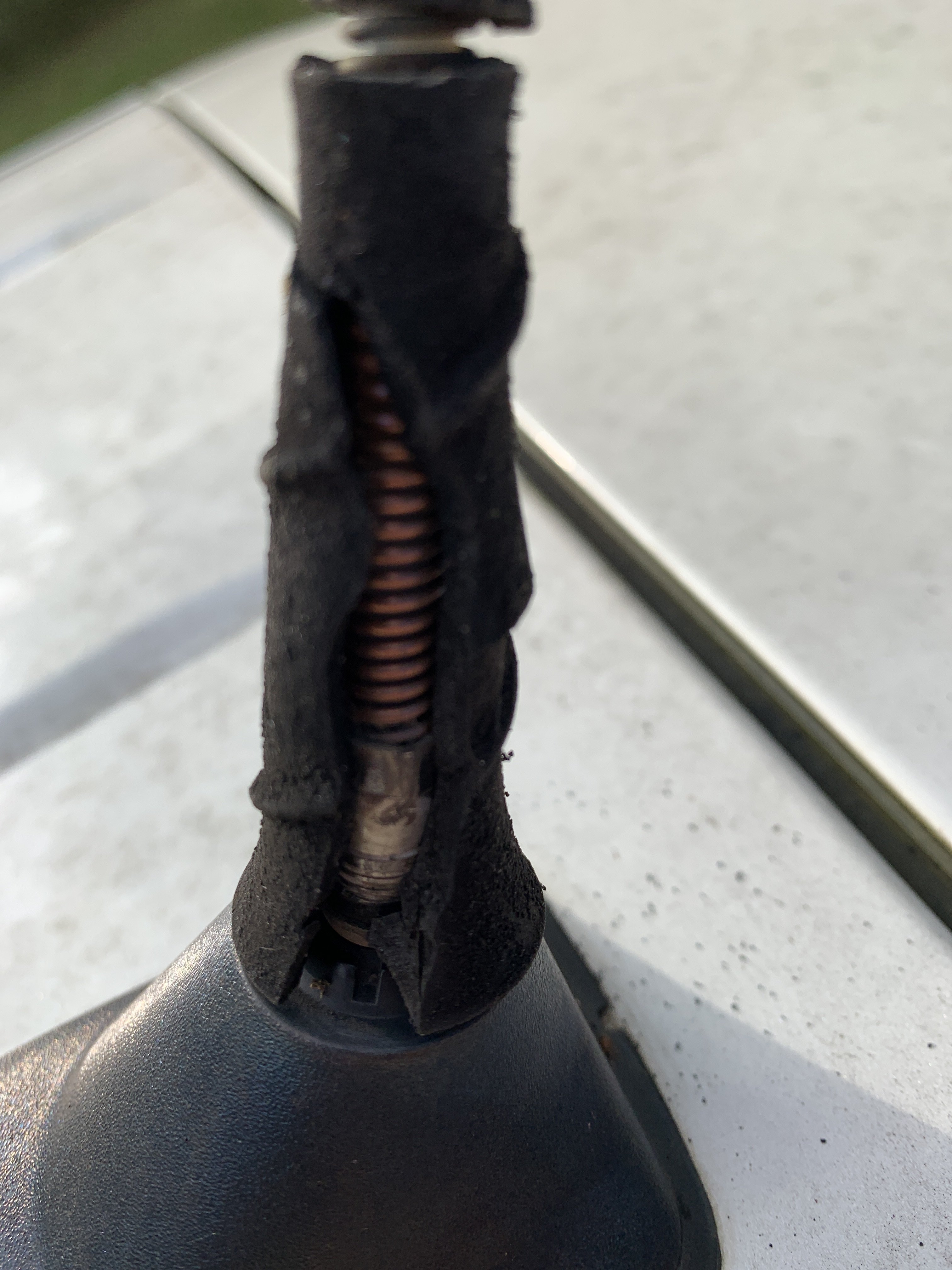

I’ve found out that my rfid module for the push button start and all that mess is under the rear mast antenna. Now I’ve seen that the mast antenna is in pretty bad shape. Would water leaking through there into the rfid module cause the issues I had?
Sorry to hear that Insurance policy would not cover it.    :(
    A good chance that that was the START of the problem, but now you will still have to repair what "smoked" under the hood. Pretty intensive to track all out and costly repair if not DIY. I'd start with the antenna  and module you post of. Then start testing TIPM relays and fuses AND the wiring that goes into the TIPM underneath it. That should be enough to keep you busy till CHRISTMAS...LOL  ;)

 just replaced my antenna that was looking like that, nut i noticed it right away as a mech was backing my journey up a bit and the antenna hit the roll up door that was partially closed,,,i doubt that their was a leak there as that whole top part is built on to a metal stud that screws into the base so no chance of a leak there..also the  antenna is about $21 at the dealership and about 16 on amazon... if you twist the rubber part above the base it will just screw out
