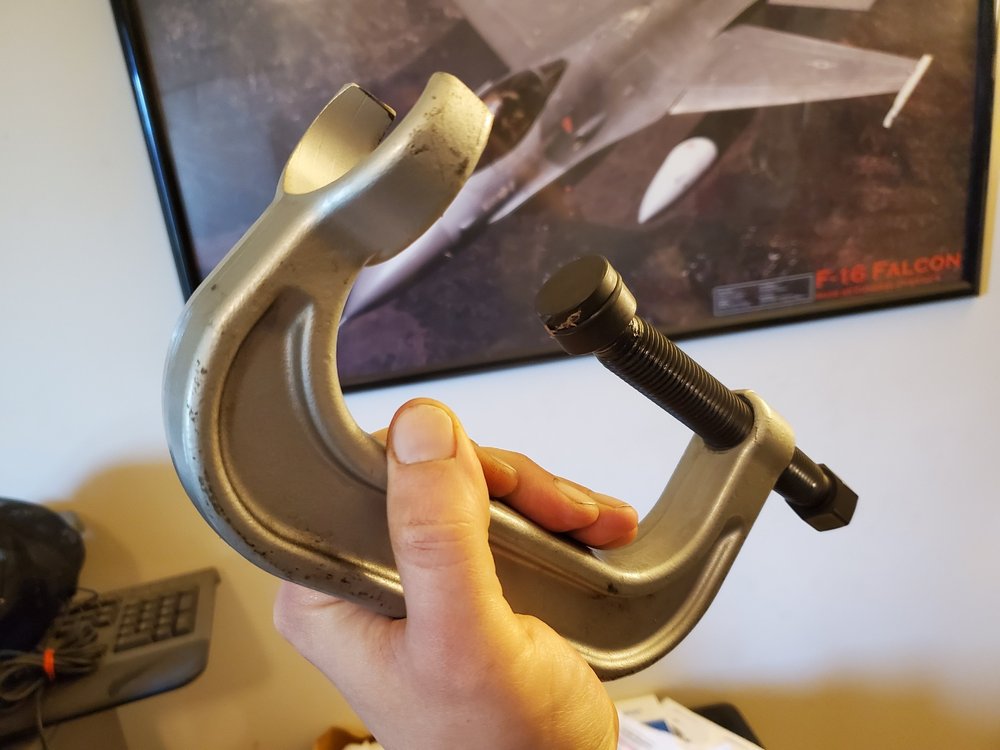

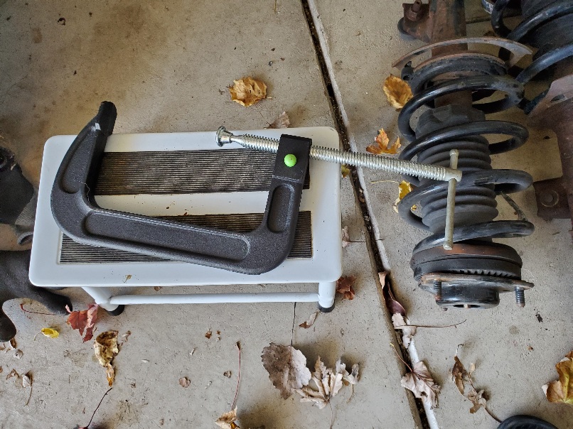

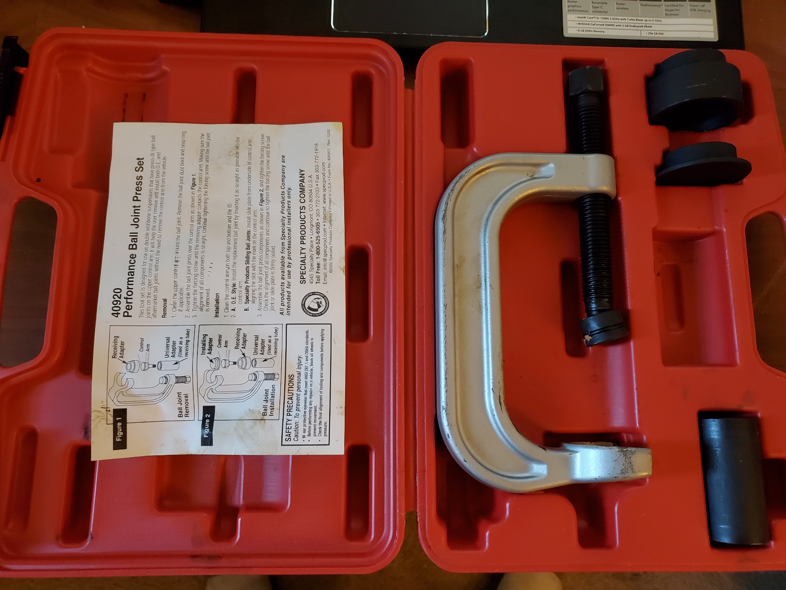

TheCarCzar Posted November 2, 2020 Author Report Share Posted November 2, 2020 I wanted to mention one other thing. That specialty kit I obtained to finish the ball joint portion of the job is absolutely A+, and if I'd known how useful it was in tight spaces I'd have probably bought it years ago. It's plenty beefy enough to tackle just about any other ball joint job too. It's biggest detriment is it's sparse assortment of adapter cups and pusher blanks. I plan to eventually buy a kit of those as well, at which point I'll be set for all future ball joint changes (and it does other things too, if you're creative and know the limits). 2late4u and Shawn855 2 Quote Link to comment Share on other sites More sharing options...

Shawn855 Posted November 3, 2020 Report Share Posted November 3, 2020 Awesome write-up. +1 on the balljoint tool. I ordered a different one on amazon and the problem is the one end of the c-clamp is too fat to fit in the knuckle so i had to grind mine down so it would fit. For removal, I would use the balljoint tool until it ran out of room, then finished extracting the balljoint by placing a 21mm socket against it and hammering it out. Comes out super easy. To install, i used the tool again until it ran out of room, then finished the installation by placing an installation cup around the balljoint and hammering it in gently until it seated tight. Also, for the strut job, you actually do not have to remove the wiper arms. You can place a slab of wood to keep the plastic up and out of your way, while you loosen/tighten the strut bolts. I just did my struts this summer twice (first monroe strut was faulty. Had to do job over again). 2late4u 1 Quote Link to comment Share on other sites More sharing options...

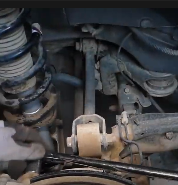

Shawn855 Posted November 3, 2020 Report Share Posted November 3, 2020 Correct me if I'm wrong but that upper control arm is looking a little off. The front part has to be perfectly aligned with the back part no? They are supposed to be symmetrical with each other. That's why i went with the non adjustable. Quote Link to comment Share on other sites More sharing options...
Shawn855 Posted November 3, 2020 Report Share Posted November 3, 2020 Here's a picture for reference showing that they should be symmetrical Quote Link to comment Share on other sites More sharing options...
2late4u Posted November 3, 2020 Report Share Posted November 3, 2020 not for sure myself but it is there to pull the tire in or out for alignment purpose, actually the non adjustable looks more out of line than the adj one is also, would it depend on what angle you are taking the picture...also there is a rubber bushing in each bolt hole as well. Quote Link to comment Share on other sites More sharing options...
Shawn855 Posted November 3, 2020 Report Share Posted November 3, 2020 It looks out of line because the bushing is flexed. Once the vehicle is back on it's weight, that entire control arms rests back into position which is why both ends of the arm need to be symmetrical with each other. Quote Link to comment Share on other sites More sharing options...
Shawn855 Posted November 3, 2020 Report Share Posted November 3, 2020 Sorry, the non adj looks out of line, because the vehicle isn't on it's own weight ANDDD the bushing is worn out. Both reasons. Quote Link to comment Share on other sites More sharing options...
2late4u Posted November 3, 2020 Report Share Posted November 3, 2020 I could say the same thing about the adjustable one as well, but i dont want to go back and forth on this ,and also if they made a part that wasn't right they would get sued or go out of business as well,,have a great day Quote Link to comment Share on other sites More sharing options...

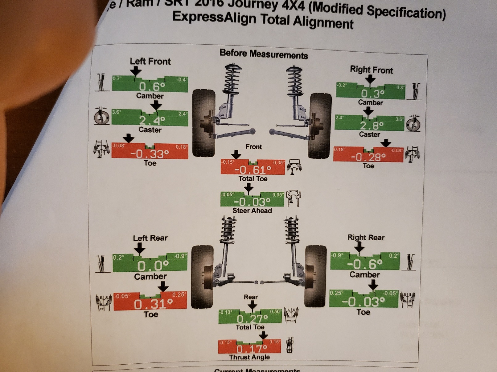

TheCarCzar Posted November 4, 2020 Author Report Share Posted November 4, 2020 One last follow-up. Wife took the Journey in for tire rotation and alignment today. Buying quality parts and taking the time to align your strut-to-knuckle bolts how they came out pays off. Note the front camber/caster readings. Pretty sure the toe-ins were just due to time and driving - natural drift over time. Planning to change the outer tie rods at 100k whether they need it or not, so not worried. 2late4u 1 Quote Link to comment Share on other sites More sharing options...
Shawn855 Posted December 4, 2020 Report Share Posted December 4, 2020 The bolt in the housing isn't symmetrical because the vehicle is lifted off the ground. It becomes symmetrical once it's back on it's weight. The only reason i mention the back of the part being symmetrical with the front of the part is because that's the part that's keeping the rear knuckle in the exact position it's supposed to be in. Yes an alignment will correct it regardless in the end. Quote Link to comment Share on other sites More sharing options...
