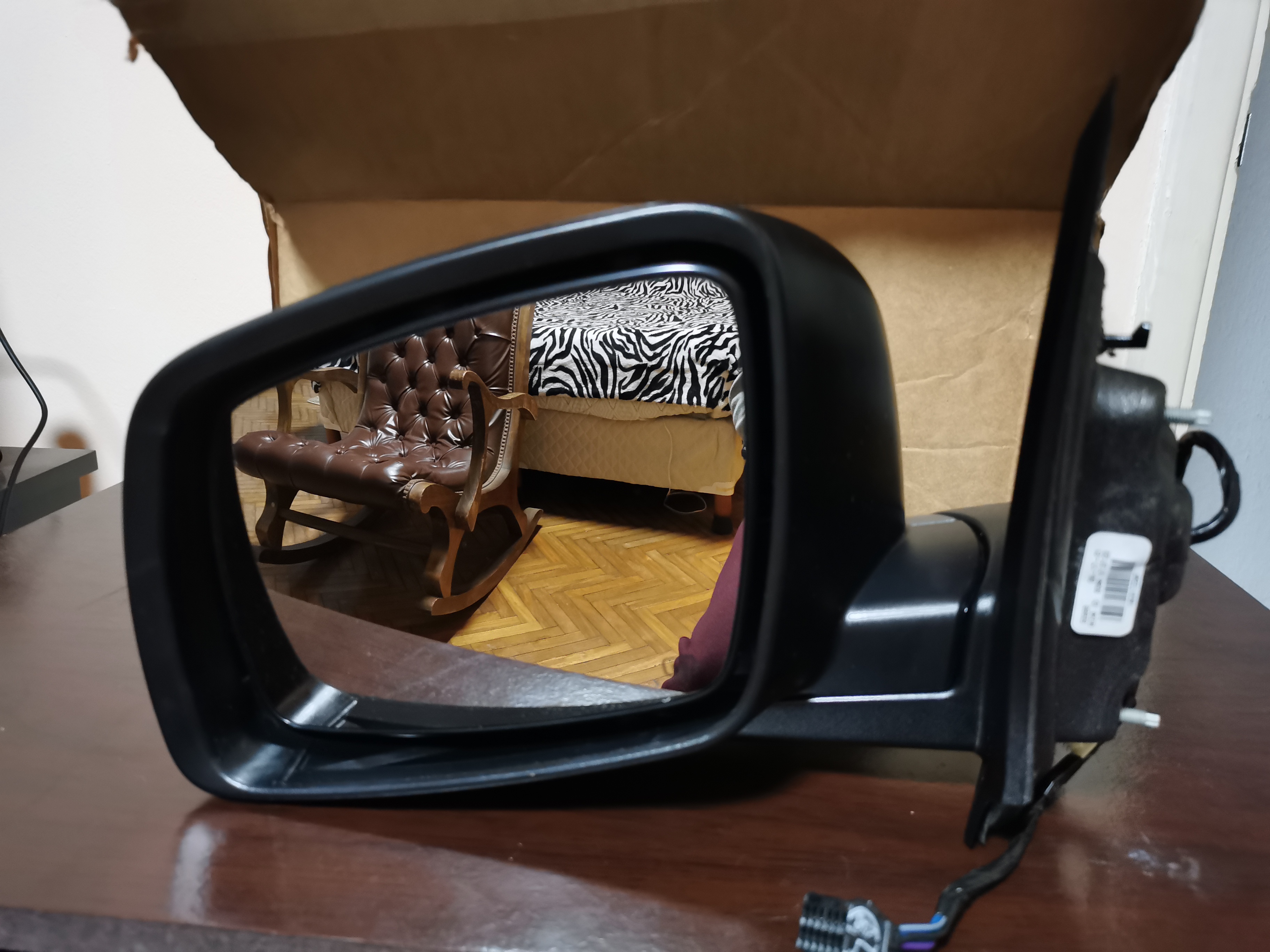

jose laprovitera Posted August 30, 2022 Report Share Posted August 30, 2022 i love my journey!! its a recent purchase, but i have a bad lucky with workshops, they makes me spend money without sense!! i bought one mirror new to replace, in my country costs USD 1.200 MOPAR ,when i start to dismantle the door i find that the old mirror were disconnected!!!! not broken! i connect and it works!! if you or any guys need to see the door without cover you can see my vid, just see, im talking in spanish because i spend high money for nothing! 2late4u 1 Quote Link to comment Share on other sites More sharing options...
2late4u Posted August 30, 2022 Report Share Posted August 30, 2022 welcome to the group and thanks for posting your video for others that might need it jose laprovitera 1 Quote Link to comment Share on other sites More sharing options...
