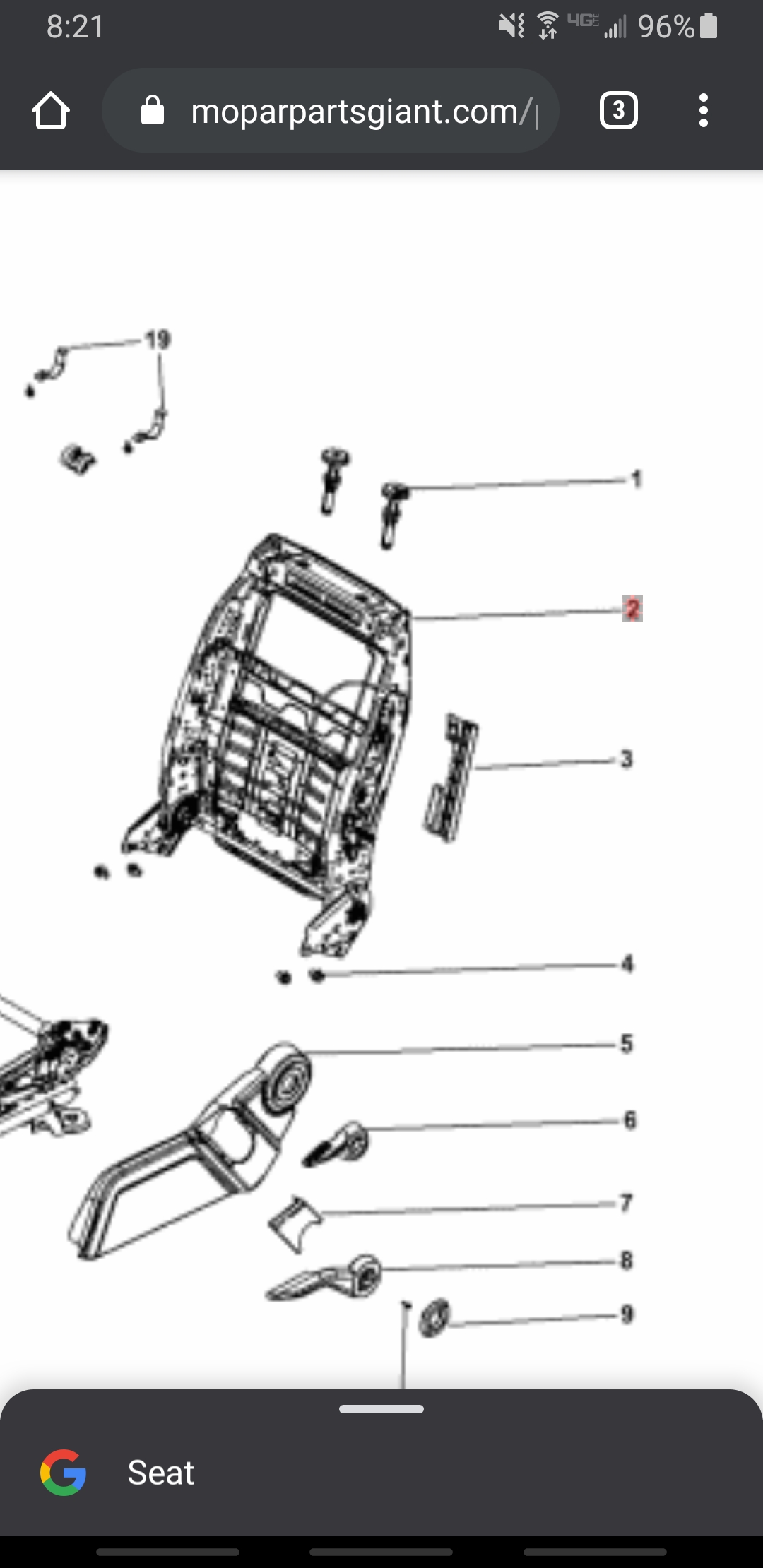

Armando G Posted December 5, 2020 Report Share Posted December 5, 2020 There isn't anything out there for this, but maybe you can use the picture attached to see the clips and screws holding it in. I would assume you have to pull the entire seat out to get to the lower screws. Take some pics of you do dive to get it done. Quote Link to comment Share on other sites More sharing options...
Ken2010 Posted December 5, 2020 Author Report Share Posted December 5, 2020 (edited) Hi, I pulled it apart today. There were 6 tabs holding it in place. The top 2 were like hooks so in hind-site I should have pulled out the bottom 2 then the middle 2 then pulled down as the top 2 as hooked over the tabs of the cover. To put it back on I inserting the 2 top tabs in the hooks. Then clip the middle and bottom clips. One of the middle metal tabs partially broke on me so be careful. Fyi. Not sure if all journeys havre this panel backing but my 2010 did. I was removing the panel to access the active headrest wire. The pin mechanism broke inside the headrest and it released. No air bag alerts as it did not deploy. Picked one up at a wrecker and I stalled it. All good now. Sorry forgot to take pictures Thanks Edited December 5, 2020 by Ken2010 2late4u 1 Quote Link to comment Share on other sites More sharing options...
