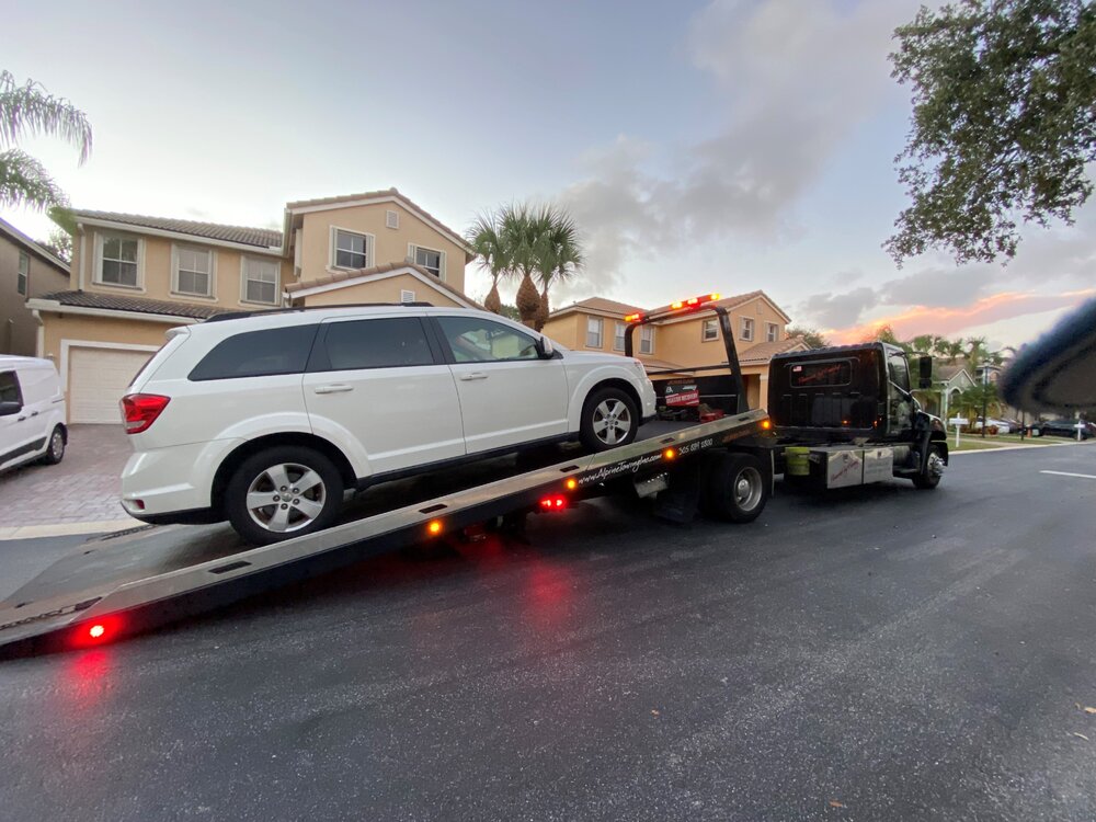

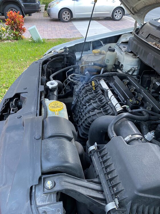

Melch Posted September 26, 2024 Report Share Posted September 26, 2024 Hello, I had a 2012 Dodge Journey SXT with similar issues. The dealership couldn't find anything either. All of this started in 2022. October 28, 2022 white smoke and an acetone smell came from the engine. Luckily I was near home and coasted in to my driveway as the engine shut off. Once it cooled down it would not start. My car had I tried jumping it and everything with no luck. Insurance wouldn't cover any of it, so it was hauled away as junk to be auctioned BidHistory.org - Report 3C4PDCBB3CT394457 DODGE JOURNEY 2012 White Gasoline - price and damage history Quote Link to comment Share on other sites More sharing options...
