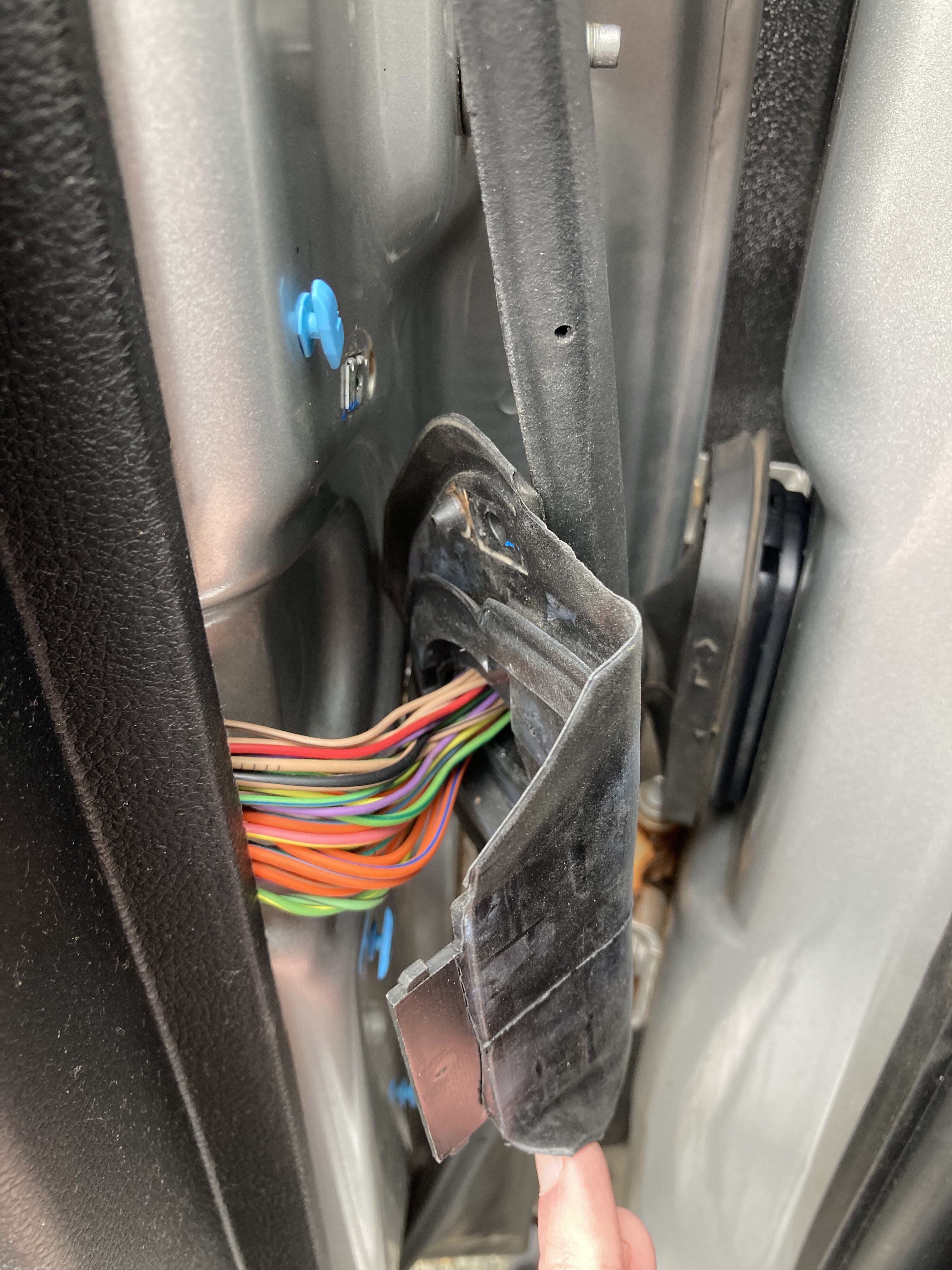

TD Charlie Posted January 9, 2021 Author Report Share Posted January 9, 2021 Well i decided to take a look at the wiring in the door jamb. Outside of cutting the rubber sheathing (this will be my last resort) i inspected the wires at the grommet into the dash and the plastic cover over the door corner. Huge thumbs down to dodge for running the wires over the corner of the door instead of going straight through. I bet they saved a couple pennies per door by using plastic rather than rubber. I loosened the wiring in the door jamb and tried my old switch again. All of my windows work now, but the door locks don’t, and the UP function on the driver window has to be hit just right to function im starting to think the switch may actually be going bad, or contact points within are fouled up. It’s so damn cold outside and my hands are numb, so I’m done for now. Next thing to check is the new master switch which arrived Monday/Tuesday. If that doesn’t work i will be splitting open the rubber sheathing in the door jamb and inspecting the wires further. Quote Link to comment Share on other sites More sharing options...

TD Charlie Posted January 13, 2021 Author Report Share Posted January 13, 2021 11 minutes ago, Armando G said: So was the problem in the contacts of the switch itself? I had a key FOB that wasn't working and a new one was over $100. I bought a new pad for $3 and boom it worked. The contacts were not connecting anymore. Makes me wonder if there was some corrosion in your switch that made for a bad contact. In any case, glad it worked out and was a cheap fix. Thanks for keeping us posted. ? i don’t think it was the contacts since the malfunctioning buttons on the switch changed once i opened up the wiring in the door jamb. I really feel like there was a pinched wire and when i loosened it up it was good to go, but then i screwed something up on the driver mirror. Not sure if that was a switch issue or a wiring AND switch issue. The switch had to be at least partially at fault because the new one works. I did save the old one just in case. As of last night only the driver mirror left/right motion was busted on the old switch. For 30 bucks that’s what Pops would call “a sore dinky. You can’t beat it.” Armando G 1 Quote Link to comment Share on other sites More sharing options...

John/Horace Posted February 13, 2024 Report Share Posted February 13, 2024 I’m pretty sure dealer will sell driver door wire harness if it’s in stock. But it’s not likely to be cheaper than fixing bad wires with solder and heat shrink. Even multi strand wire eventually gives in to metal fatigue. Better designs and optimal temperature help life span. Think of it as fixing the weakest link. Quote Link to comment Share on other sites More sharing options...
larryl Posted February 13, 2024 Report Share Posted February 13, 2024 Here was my problem a new harness fixed all my issues John/Horace 1 Quote Link to comment Share on other sites More sharing options...
