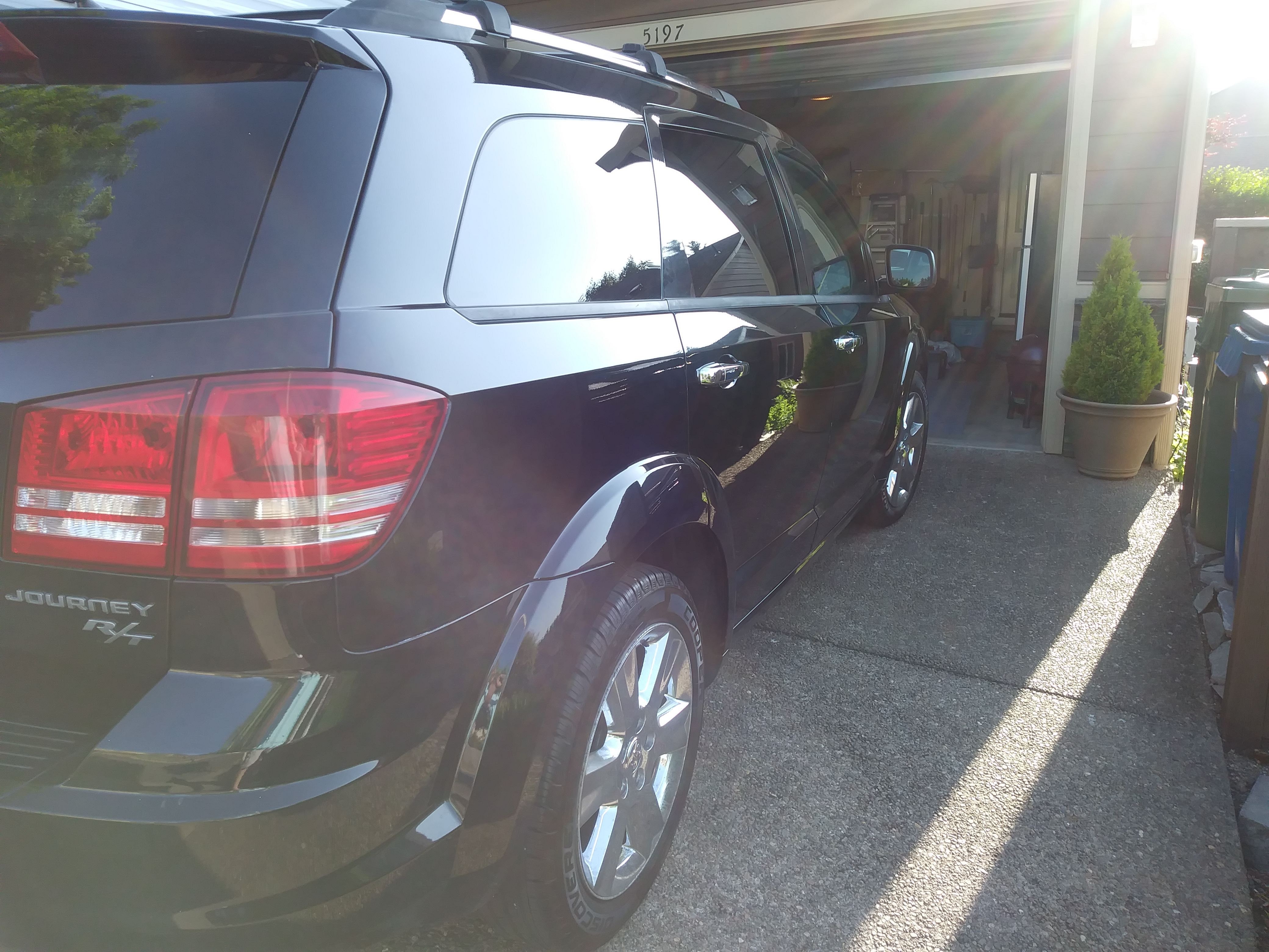

William Burke Posted January 16, 2021 Report Share Posted January 16, 2021 Having some bead leak corrosions on our 2010 rims losing air. Anyone know where we can get replacements? Quote Link to comment Share on other sites More sharing options...
