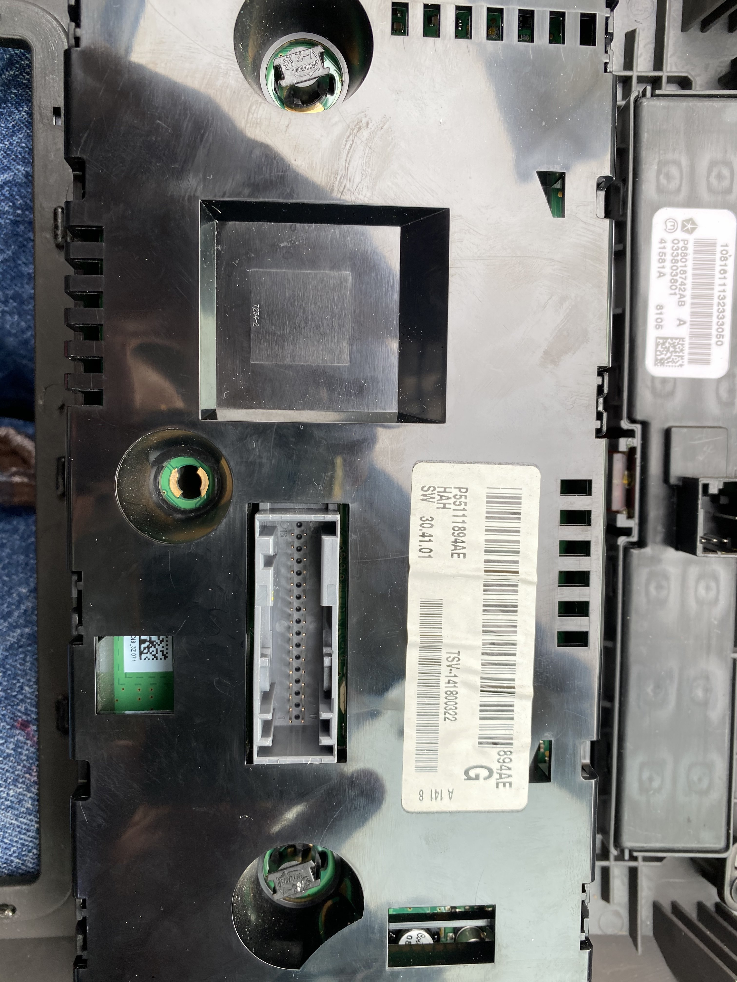

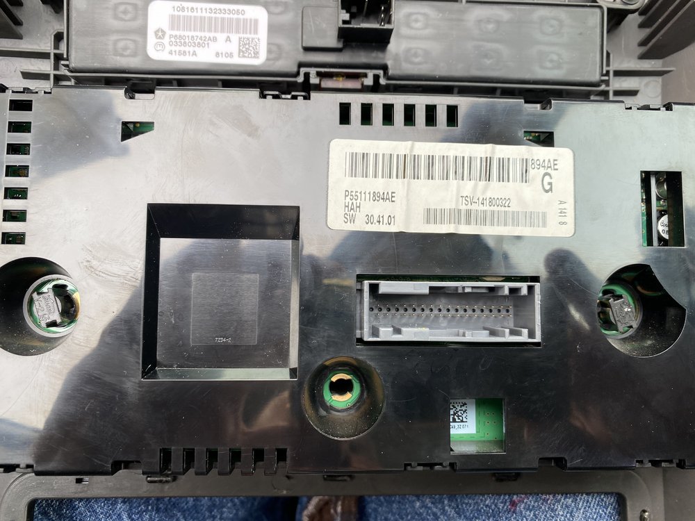

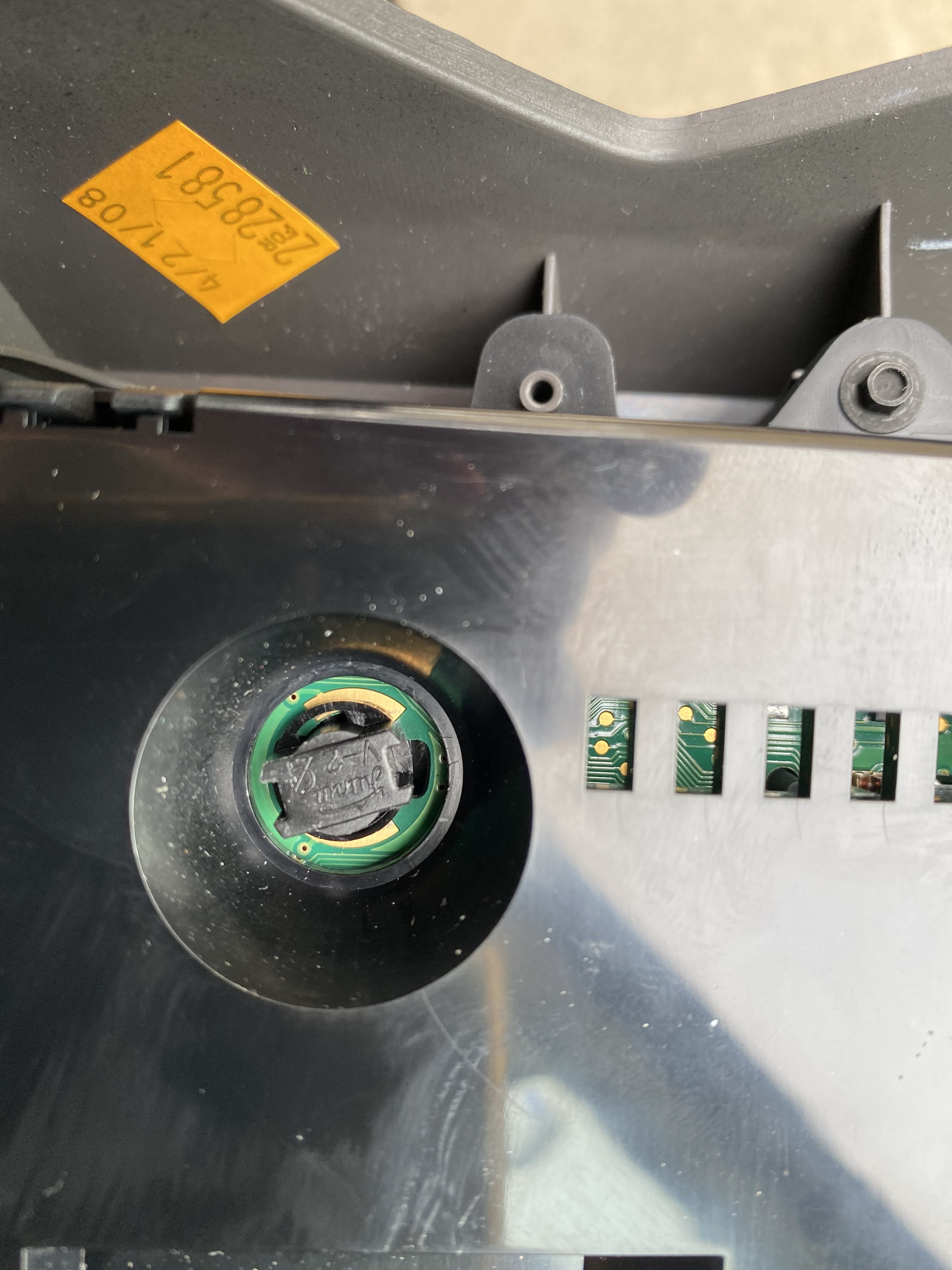

OhareFred Posted February 22, 2021 Author Report Share Posted February 22, 2021 (edited) UPDATE: So, there are 3 replaceable bulbs in the back of the HVAC control. 2 number 74/37 bulbs/sockets and a third very tiny one. I used these LED’s as the number 37 replacements from Amazon: https://smile.amazon.com/gp/product/B07S7D16CH/ref=ppx_yo_dt_b_asin_title_o05_s00?ie=UTF8&psc=1 Used the included sockets (original bulbs are soldered in to their sockets) had to turn one 180 degrees (LED’s are +/- sensitive) but work great. Dim with the dash lights as well. Now all I have to do is figure out what size the 3rd bulb is. I’m thinking a NEO T3 but am waiting for an answer to an email to be sure. Will let you know.... Edited February 22, 2021 by OhareFred 2late4u, deejizzle and John/Horace 3 Quote Link to comment Share on other sites More sharing options...
OhareFred Posted February 23, 2021 Author Report Share Posted February 23, 2021 I have already replaced 2 of the bulbs. There are 3 regular bulbs (tiny tiny bulbs) soldered in 1/4 twist sockets. As stated, 2 were a “37 (or 74, seems it’s the same). I did replace those 2 with a LED bulb. Used the socket that came with the LED bulbs. Trying to figure out the smaller side bulb. I think it’s a T3 NEO, which should be delivered today. Will update on the 3rd bulb size... Quote Link to comment Share on other sites More sharing options...

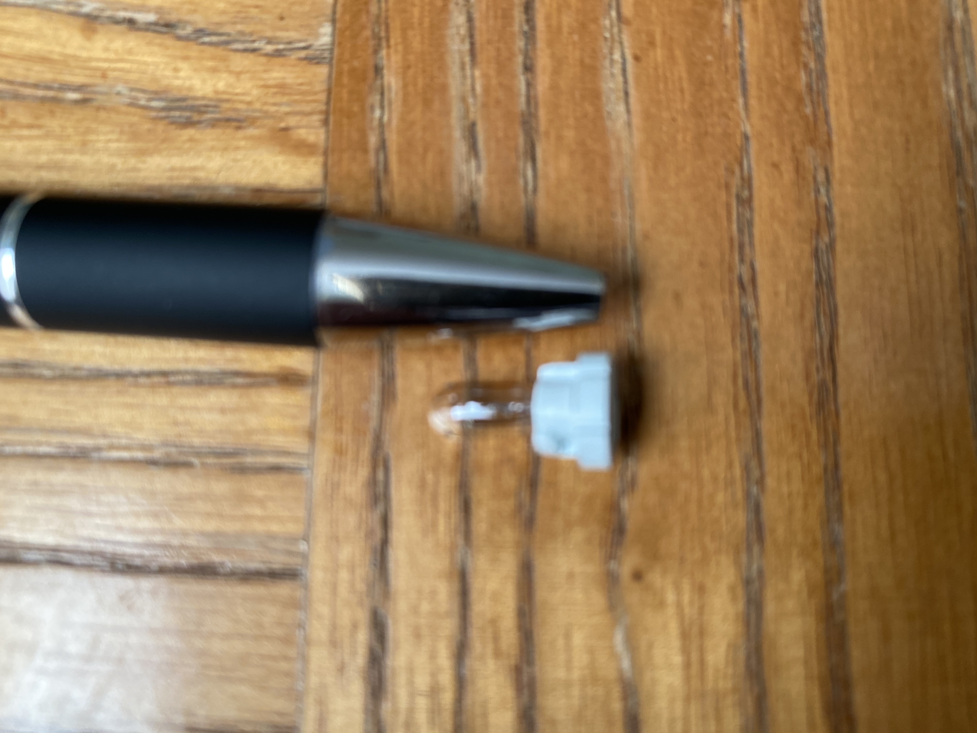

OhareFred Posted February 23, 2021 Author Report Share Posted February 23, 2021 As you can see all light up now. Easy fix once I figured out the bulbs required: 2 #37, 1 NEO T3 original T3 bulb is in the picture.? John/Horace, larryl, 5rebel9 and 3 others 6 Quote Link to comment Share on other sites More sharing options...
