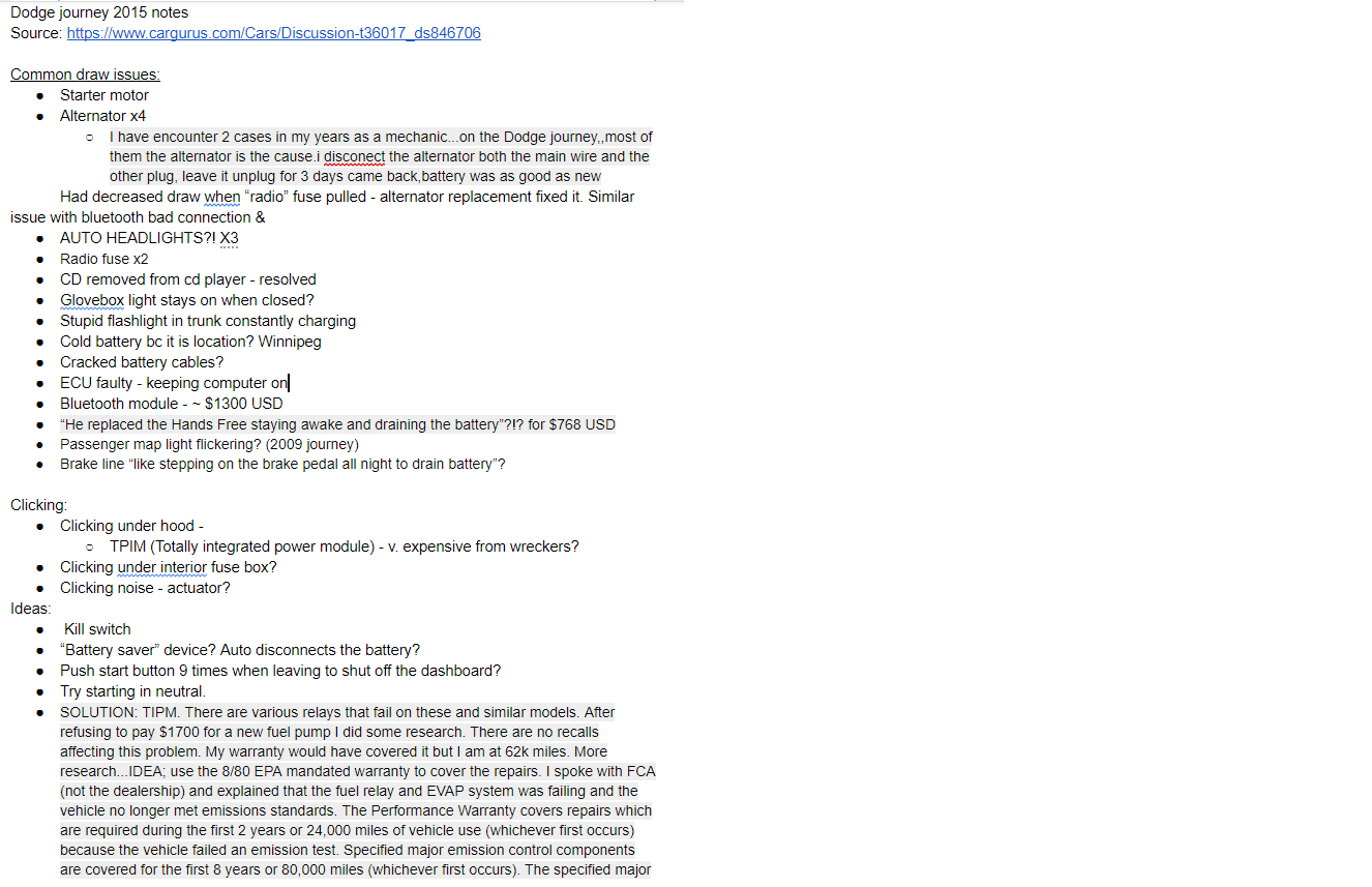

Shawn855 Posted February 13, 2021 Report Share Posted February 13, 2021 Miss me? Just kidding. So this morning i went to start my 2016 dodge journey sxt with 88,000kms on it, and the battery was completely dead. Battery is only 6 months old. Charged it right up and tested for parasitic draw. When testing, I quickly saw the 500 milliamp draw. When removing the ABS Valve fuse, the draw shot down to 60 milliamps. Any ideas on what this could be? In my head I'm thinking TIPM, and PCM. Both are expensive naturally. Quote Link to comment Share on other sites More sharing options...

Shawn855 Posted February 13, 2021 Author Report Share Posted February 13, 2021 (edited) From my very limited knowledge in this area, what I can recall is that the TIPM controls what electronics go to sleep when the vehicle is turned off. If I pull that abs fuse, and the draw goes down, but then reinsert the fuse, the draw stays down. If I restart the draw test, the fuse is back to drawing 500 milliamps. My buddy is a mechanic at a local shop and said he changed a lot of TIPM, as well as PCM and when I did the research, there's another board with over 100 posts about the issue I'm facing. Some were narrowed down to the Bluetooth module, and some to the radio, while others was the PCM and others the TIPM. Edit: acronym mistakes, because it's 7:50am Edited February 13, 2021 by Shawn855 OhareFred and 2late4u 2 Quote Link to comment Share on other sites More sharing options...

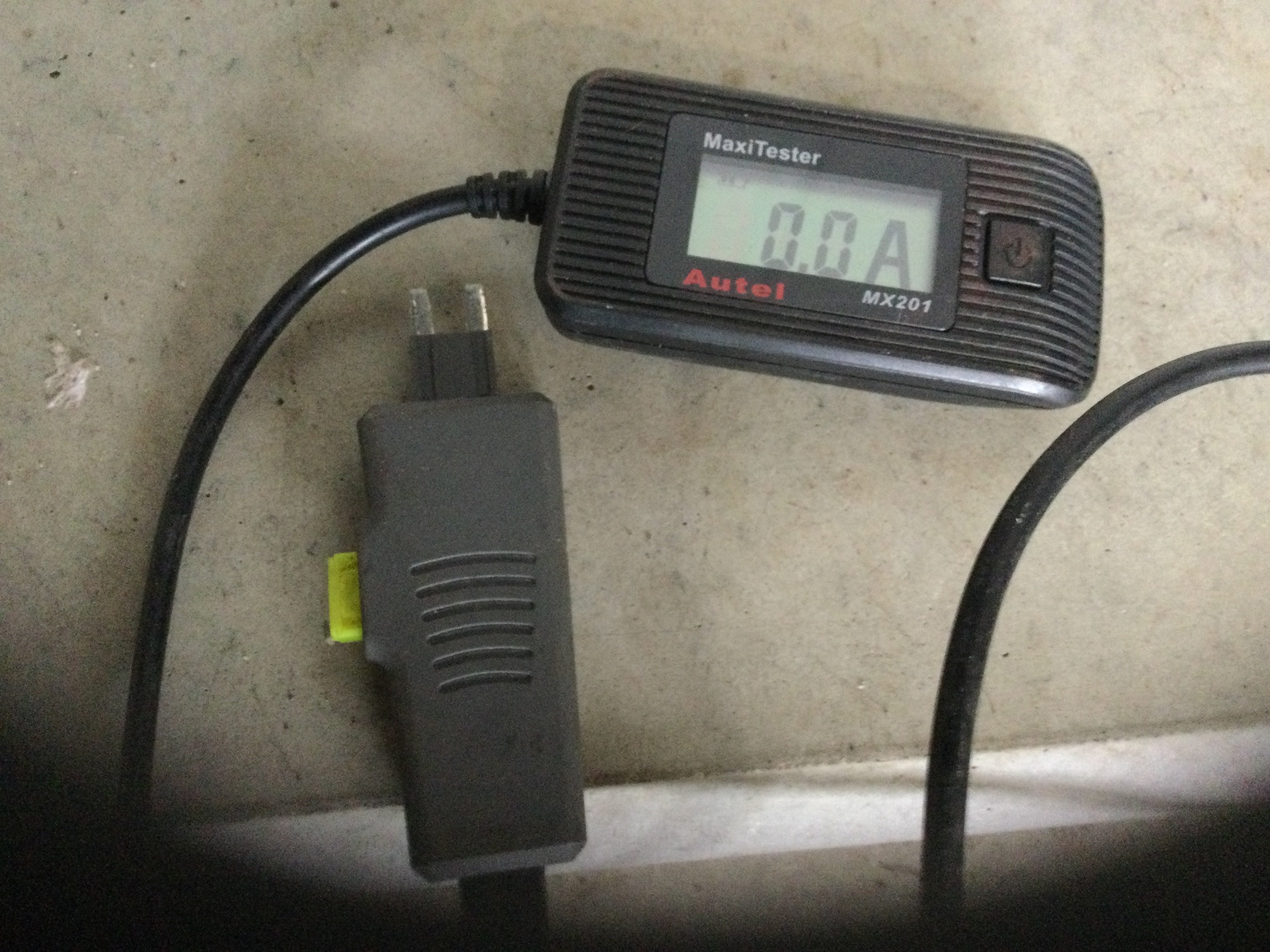

John/Horace Posted February 13, 2021 Report Share Posted February 13, 2021 My f150 had a weird parasitic draw issue a few years ago. The go to sleep function can be tricky, on the Ford the drivers door has to be closed to trigger the full shut down sequence. The 2009 F150 generation had a lot of dead battery issues. It can be hard to isolate where the draw is from without measuring right at the fuse contacts. Although I think abs would be isolated there could be problems with pedal brake light switch draining battery. Search site there was a recent posting about it. Battery measurement will be entire fuse box. I have a fuse draw circuit tester which is good for isolating issues. Maybe borrow one, tipm or pcm are expensive items. Wallmart batteries not that bad in my experience, I have used them before. OhareFred 1 Quote Link to comment Share on other sites More sharing options...
OhareFred Posted February 13, 2021 Report Share Posted February 13, 2021 Hey John, where did you get that mx201? I’d like to look into it....? Quote Link to comment Share on other sites More sharing options...
Shawn855 Posted February 13, 2021 Author Report Share Posted February 13, 2021 Yeah I saw the mention about the brake pedal switch. If it were that, wouldn't the brake lights be on while the vehicle is turned off? That fuse draw circuit tester looks like a great tool to test with, but since I already know that pulling that specific fuse reduces the draw, I'd say that using that tool would be redundant in my case. I'll probably still end up buying one however lol. OhareFred 1 Quote Link to comment Share on other sites More sharing options...
John/Horace Posted February 14, 2021 Report Share Posted February 14, 2021 19 hours ago, OhareFred said: Hey John, where did you get that mx201? I’d like to look into it....? We have a place that is like your Harbour Freight but smaller with less selection. It’s called Princess Auto, lots of surplus stuff generally good prices on cheaper China tools. I think I paid around $35 around 4 yrs ago for it. Great trouble shooting tool. The guy with brake light switch issue said they were on during problem. Not sure how much both lights draw when fully on, worth looking at for power draw anyway in case only partly engaged. Is there any aftermarket stuff wired in to car that might have been added to abs circuit? Some remote start units use a brake signal. With our remote battery terminals I would still try to test right at fuse. Remote terminals aren’t the same as testing right on the battery terminals, there is extra power drop and grounding issues. Mark abs relay under hood and swap it’s location with another identical relay. Bad coil in relay another possibility. OhareFred 1 Quote Link to comment Share on other sites More sharing options...
OhareFred Posted February 14, 2021 Report Share Posted February 14, 2021 ESI 306B 30 Amp Fuse Buddy ATC Tester Found this on Amazon and purchased it. Was $21.00 USD so I figured I’d try it out. Thanks for the tip John! Quote Link to comment Share on other sites More sharing options...
Shawn855 Posted February 14, 2021 Author Report Share Posted February 14, 2021 Fuse tester wouldn't be accurate in my current situation, because as mentioned above if I remove the fuse and reinsert it, the drain stops until I restart the draw test. So removing the fuse, and inserting the tester would show zero drainage, thus leading to more confusion. That's why I was kinda thinking PCM as the issue. If it was the TIPM, I would think that the drain would continue after reinserting the fuse during the testing. But as it is now it's like it's forgetting to put abs valve to sleep after engine turns off. But then we remove the fuse, reinsert it and it remains off, reducing the amp draw from 500 milliamps to 60 or less milliamps. I could just pull the fuse but then I'd be screwed if I got into a major accident and they saw the fuse was pulled. Quote Link to comment Share on other sites More sharing options...
