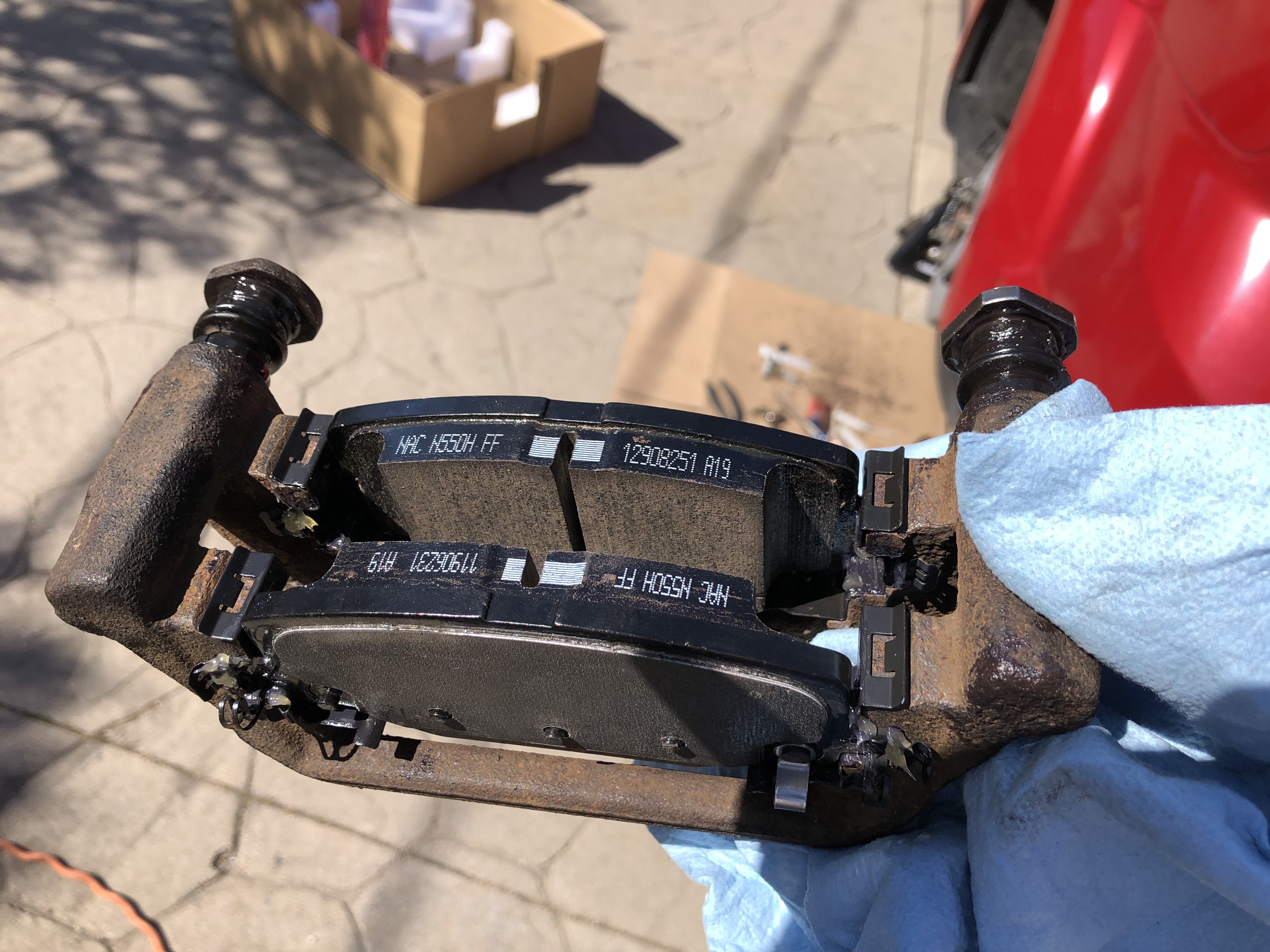

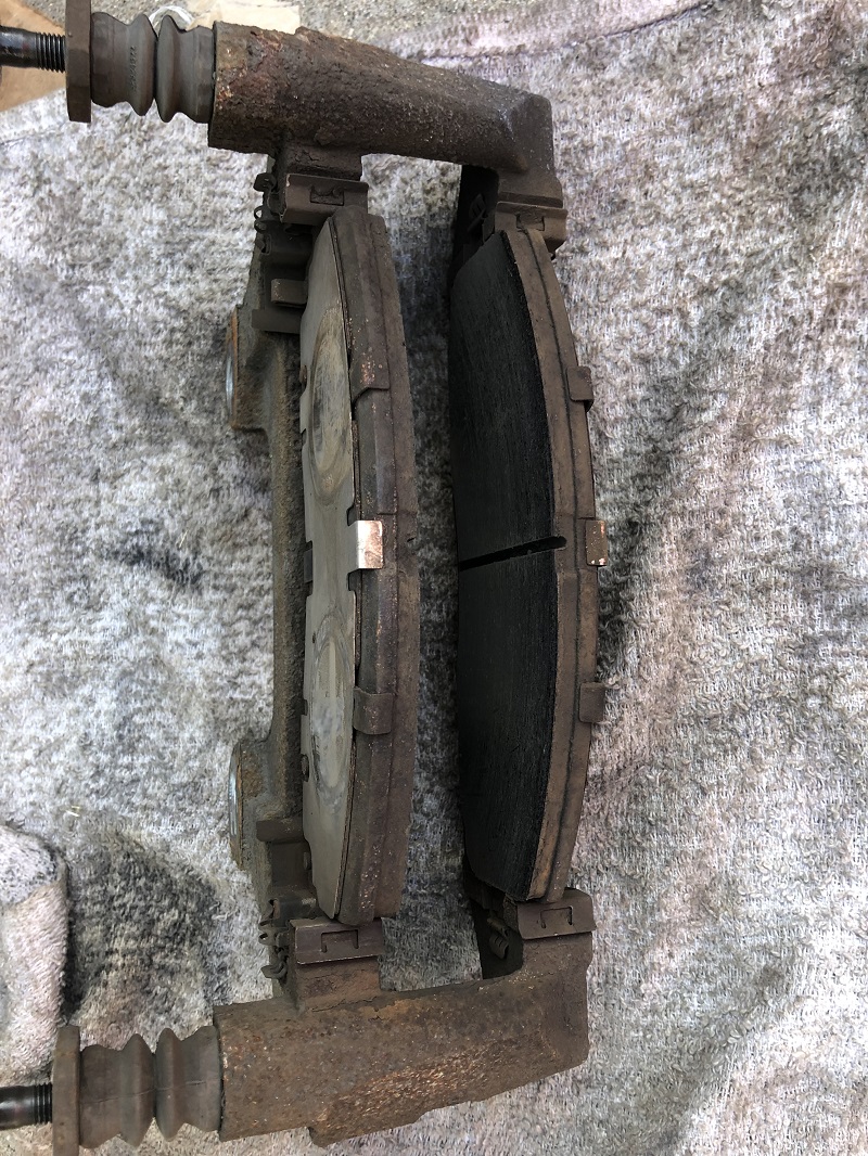

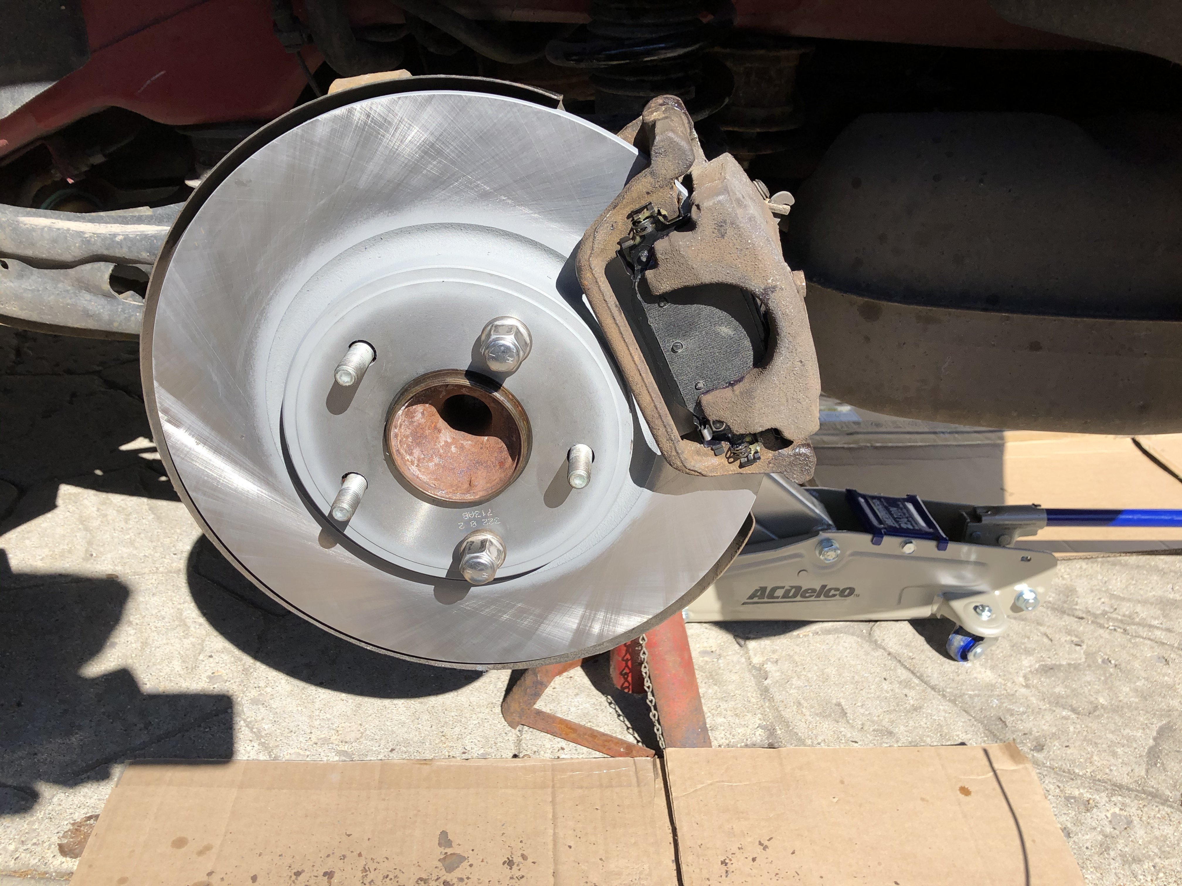

DodgeaWrench Posted March 22, 2021 Author Report Share Posted March 22, 2021 [This is about the rears only. The fronts were not touched.] The bolt and rust gods were good to me. The rear rotors and pads have been replaced. On inspecting the old pads, they did not wear evenly. The passenger side were significantly more worn that the driver side. At the time I didn’t think twice about this given the number of miles on these pads. (The passenger side was the side making a noise when apply brakes, hence the reason for the pad and rotor replacement.) Now the rub. Everything went back together well, but after driving the day, I see that on the driver side, the pads are not being pressed onto the rotor. The rotor is untouched. It still looks as if it just came out of the box, where as the passenger side at least has the markings on where the pads touched the rotor. My guess is the driver side stopped working some time ago hence its pads were not as worn as the passenger side (which is still working correctly). The car never pulls to one side or another on braking both before or after the rears were replaced. When compressing the piston on the calipers they acted differently. On the drivers side (bad side) I slowly kept turned it in until I felt resistance then stopped. I assumed it bottom out. On the passage side (good side), I slowly kept turning it, but it never got to a point of resistance. It did compress all the way in, but just kept turning even though it wouldn’t go in any further. As they acted differently on compression, does this mean anything? The guide pins moved smoothly, both on inspection after initial disassembly, and after cleaning and lubricating. Brake fluid level is good. I have not done anything yet to troubleshoot. I have not tried to bleed anything. I’m starting my research… Any suggestions on how to troubleshoot or should I just order a replacement caliper? The picture below is of the driver side rotor. It still looks this way after a day of driving with the cross machining marks and no signs of a pad touching it. Quote Link to comment Share on other sites More sharing options...

John/Horace Posted March 23, 2021 Report Share Posted March 23, 2021 (edited) If sticking in place and seizing I would buy a reman caliber. If piston not hitting pad I would play with it. Could be air trapped in caliper. Small 3” piece of clear hose attatched to bleeder screw and then open bleeder. You may see a few bubbles rising with fluid. Cycle parking brake a few times and gravity bleed the non working caliper a few times afterwards. The air should work it’s way out, make sure reservoir doesn’t get too low. Second person keeping pedal pressure as it goes to floor gets the air out even faster than gravity bleed. Might end up with a reman caliper anyway if it starts to seize up on rotor. Worth a try to avoid extra $’s. The piston should have self adjusted by either pedal pressure or parking brake cycling, normally. Manually moving parking brake lever is hard with the cables attatched. Repeated pedal cycling might avoid bleeding, another option. Free advice worth everything you pay for it. Edited March 23, 2021 by John/Horace DodgeaWrench 1 Quote Link to comment Share on other sites More sharing options...

DodgeaWrench Posted September 12, 2021 Author Report Share Posted September 12, 2021 Back in March, I never found anything definitely wrong with the rear brakes. I did bleed the rears for grins, and on the one side in question, I did disassemble, and watched the piston move when the brake pedal was pushed. It seems to have worked since. No pulling to one side and no rust forming on the rotor from lack of pads not applying pressure. Oh well. Finally I got around to replacing the original fronts today, at 131,000 miles. They STILL had at least another 30,000 mile left on them. Crazy. They are considerably larger pads than the rear. As they had never been replaced, the front rotors did not want to come off without a fight. Just penetrating oil and a hammer was not enough. It really wasn't that bad, but I did have to borrow a puller from the local parts store. After cranking tightly on the puller, then banging the poop out of the rotor from the back side, finally got it to pop. The rest of the job was textbook. Not that I was going to, but there was no reusing the original rotors after removal. I went with OEM replacement pads and rotors all around. Assuming I did the replacement correctly, I am not expecting to have to due another brake job for the life of the vehicle in my ownership. Beside being long lasting pads, our driving miles have greatly reduce as no more out of state college trips (which is why we bought this car) and eventually covid. Changed the oil and filter today too. Nice to get these checked off before winter. Looks like replacing the tires are starting to move up the list. While doing the brakes I can see the tires are starting to wear thin. Replaced the original tires at 58,000 (dont recall the make or model) Got 73,000 miles on the ones on the car now (Firestone Destination LE2 225/65R). I'll probably go with those Firestone's again if still available. The tires have performed well and the local shop has given me good service and good pricing over the years. 2late4u, jkeaton and Armando G 1 2 Quote Link to comment Share on other sites More sharing options...
