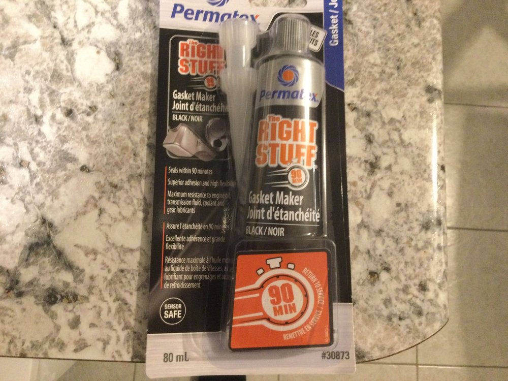

John/Horace Posted March 29, 2021 Report Share Posted March 29, 2021 For pan seal use this. Quote Link to comment Share on other sites More sharing options...
deejizzle Posted March 29, 2021 Report Share Posted March 29, 2021 I've yet to do this... its sitting on my list of things ready to go but I just want to chime in here.. if you plan on flushing tranny fluid over time, I would suggest getting a new tranny pan the first time you do it. an aftermarket tranny pan will give you a drain bolt so you can just do it like a regular oil change, then top off from the fill on the top side of the engine...dont forget to get a gasket (or gasket maker like above). also good info in here knowing 5L is changed everytime you do this.. looks like i need to buy another bottle of atf. cheers all Quote Link to comment Share on other sites More sharing options...
