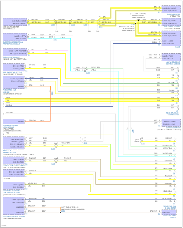

Nathang1996 Posted January 28, 2023 Report Share Posted January 28, 2023 I'm happy I found this thread. I've been having the same issue with my 2012 Dodge Journey SXT AWD, only difference is my radio isnt staying on its just Cluster & Button. I first had an amp meter testing for draw and i had about 1.6 amps. Started checking fuses and had several circuits drawing power. Exterior Lamps 1 & 2, ABS Valve, Sccm, and Cluster. There are other fuses aswell. All the wires were leading to or connected to the BCM. I've replaced the BCM and the issue is stll present. Any tips or things to verify before I go about replacing the radio? Quote Link to comment Share on other sites More sharing options...
Nathang1996 Posted January 28, 2023 Report Share Posted January 28, 2023 I've got the schematic as well for my journey. Quote Link to comment Share on other sites More sharing options...
5rebel9 Posted January 28, 2023 Author Report Share Posted January 28, 2023 1 hour ago, Nathang1996 said: I'm happy I found this thread. I've been having the same issue with my 2012 Dodge Journey SXT AWD, only difference is my radio isnt staying on its just Cluster & Button. I first had an amp meter testing for draw and i had about 1.6 amps. Started checking fuses and had several circuits drawing power. Exterior Lamps 1 & 2, ABS Valve, Sccm, and Cluster. There are other fuses aswell. All the wires were leading to or connected to the BCM. I've replaced the BCM and the issue is stll present. Any tips or things to verify before I go about replacing the radio? I did not go as "technical" as you post of for further tests/checks. I just unplugged the connection to the radio/CD player module and the dash went out. I knew that I had other radio modules available to try and replacing that unit fixed the problem. There are some other threads on the forum of the same problem and the same fix. GOOD LUCK! Quote Link to comment Share on other sites More sharing options...
