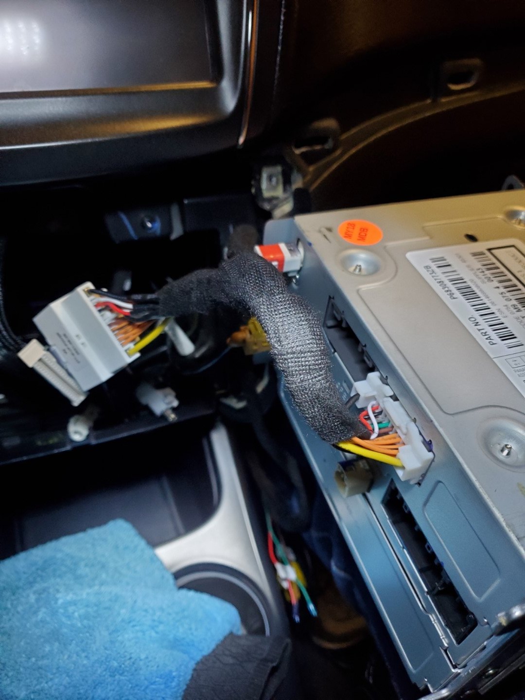

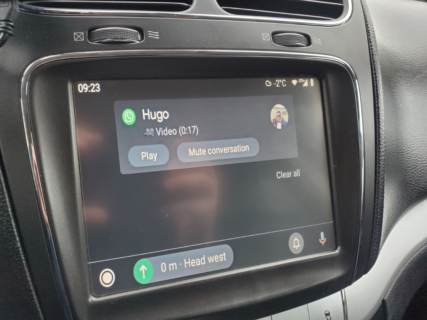

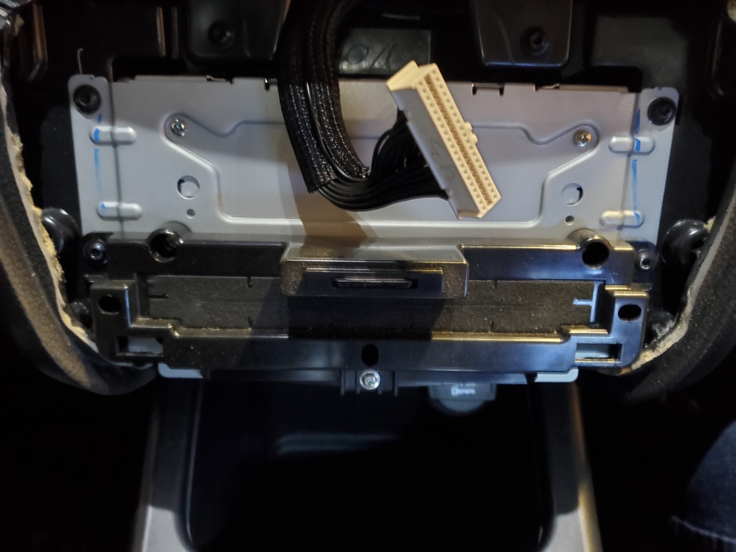

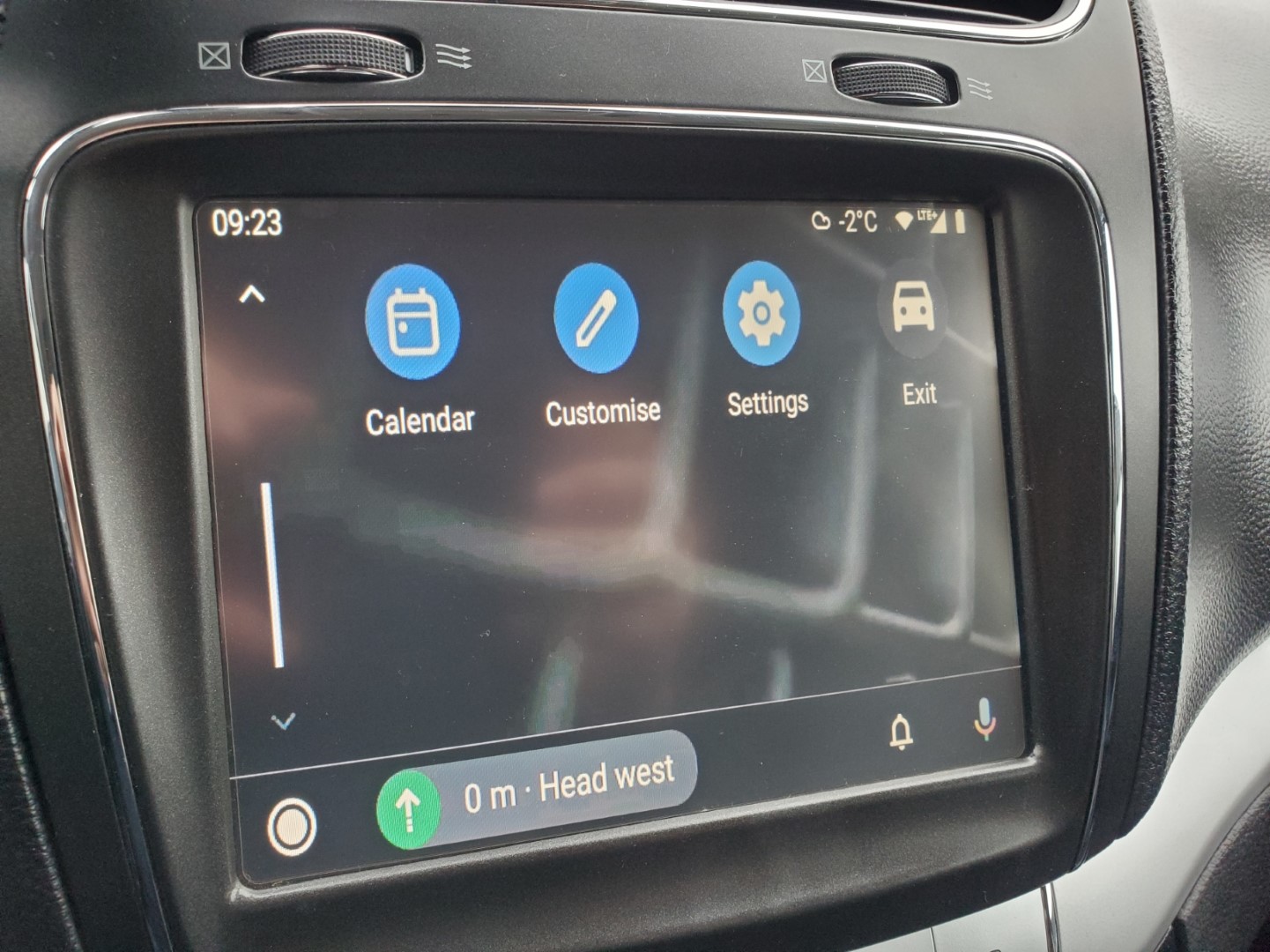

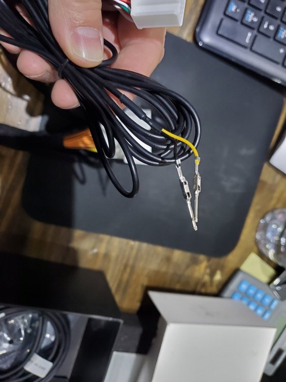

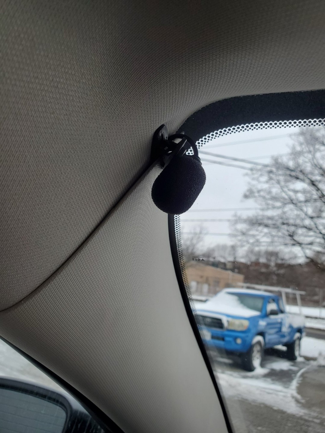

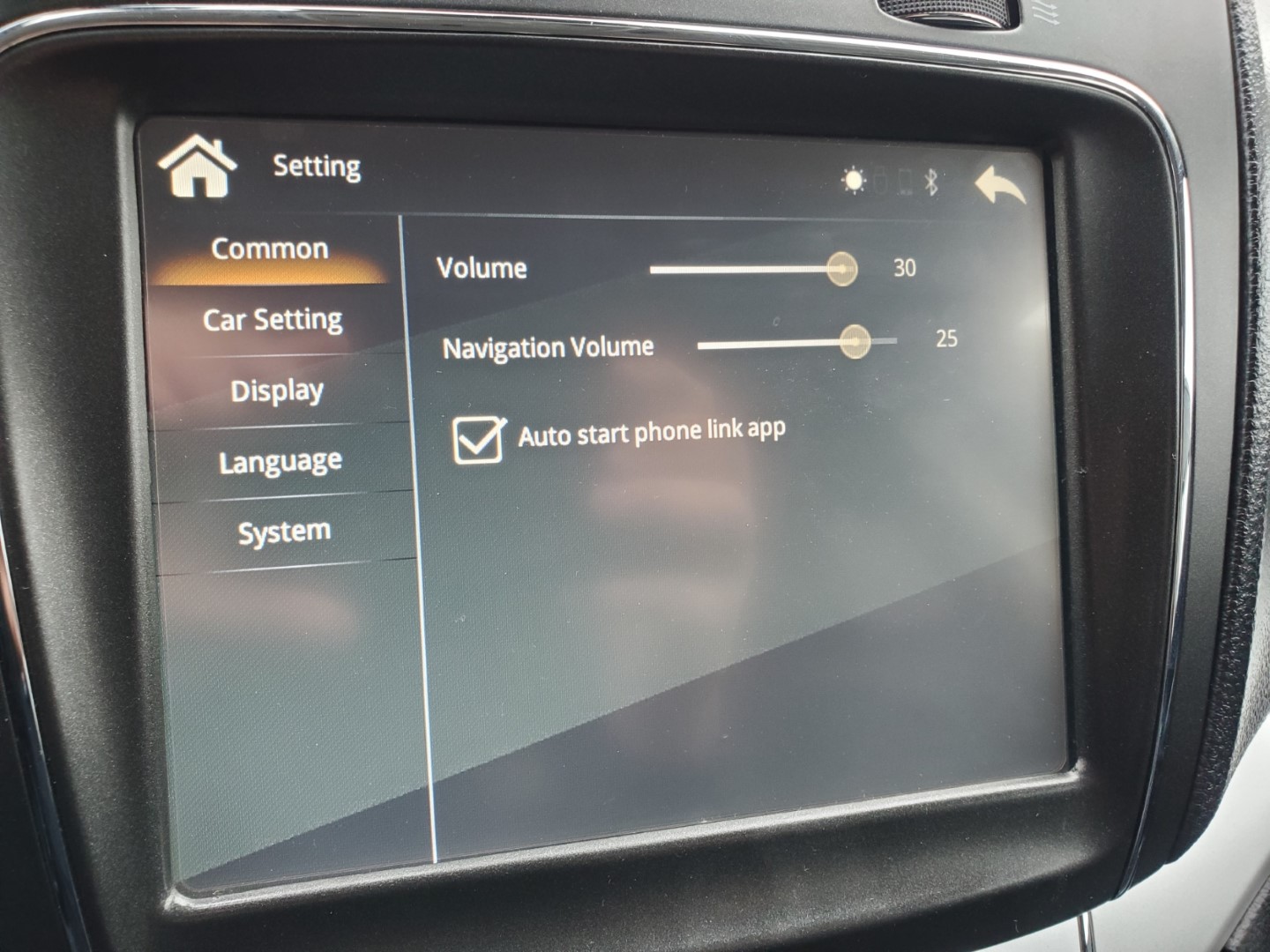

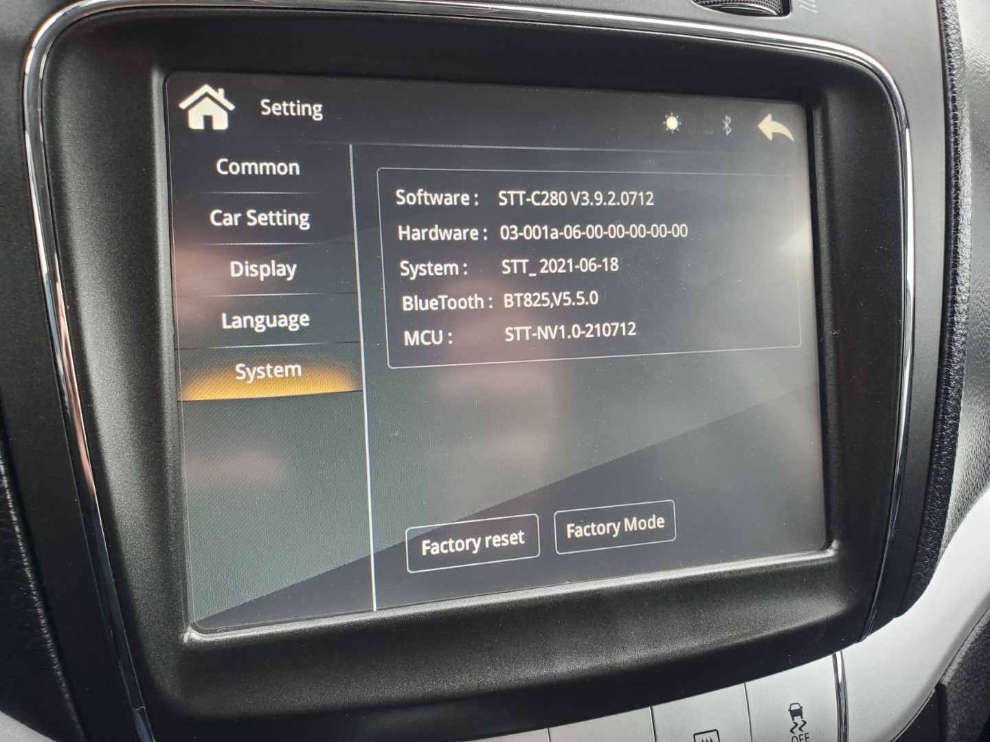

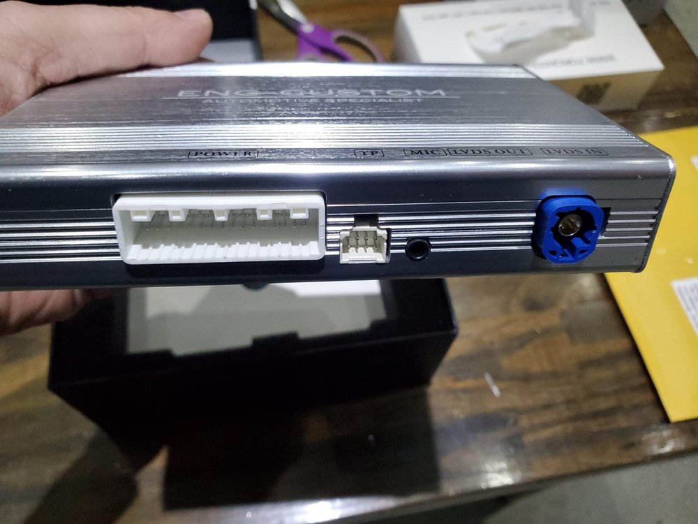

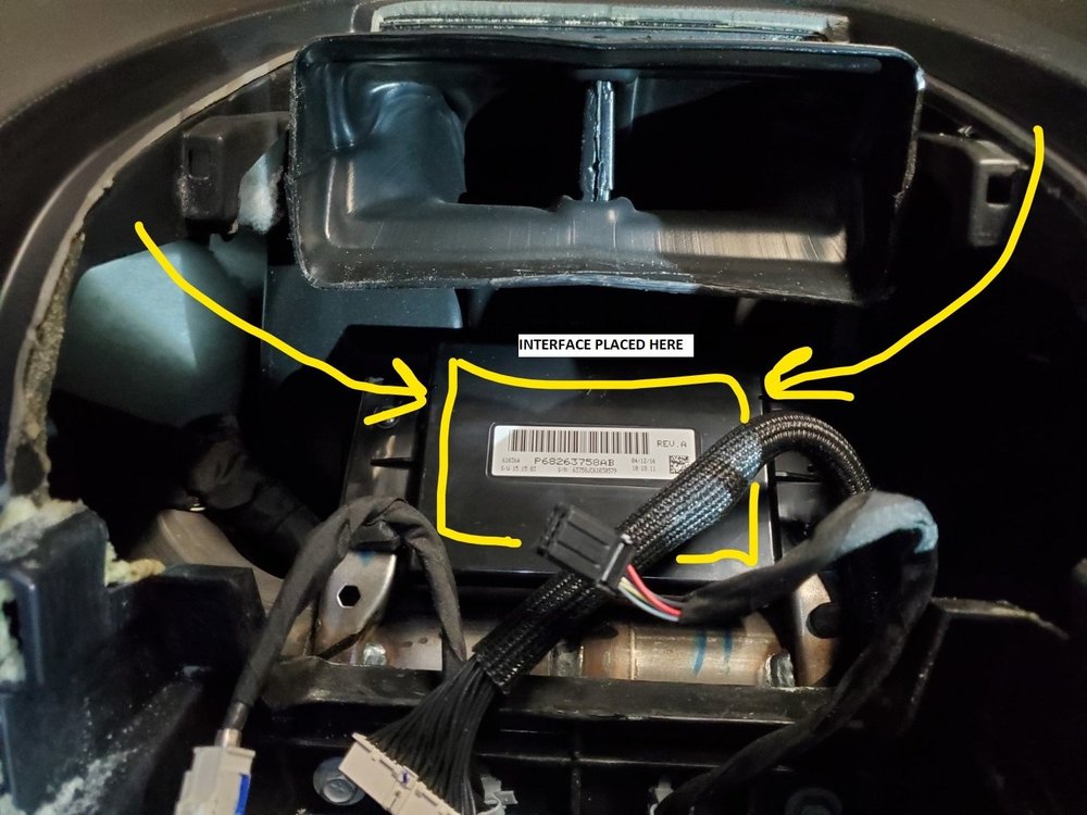

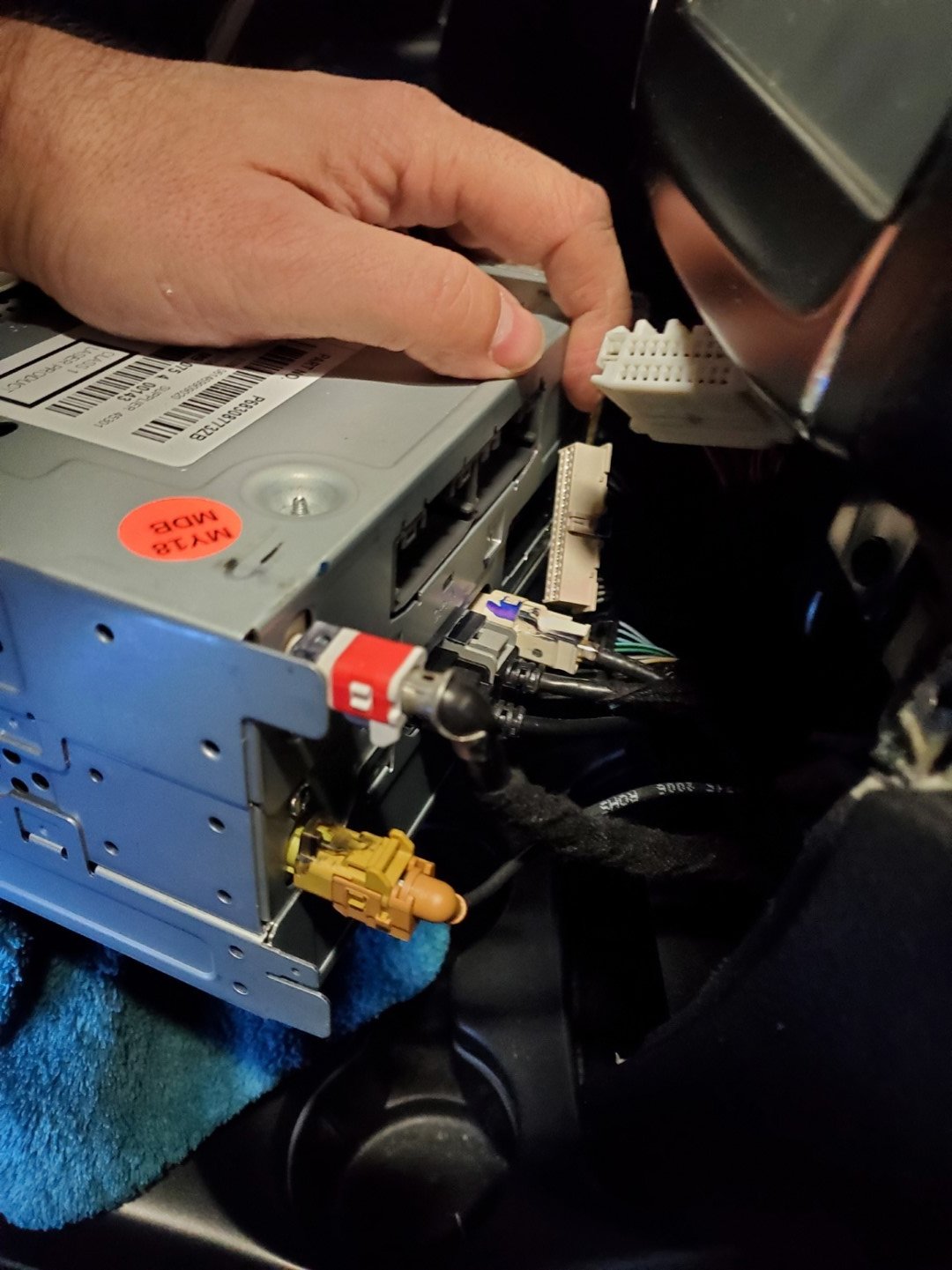

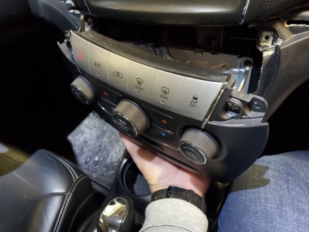

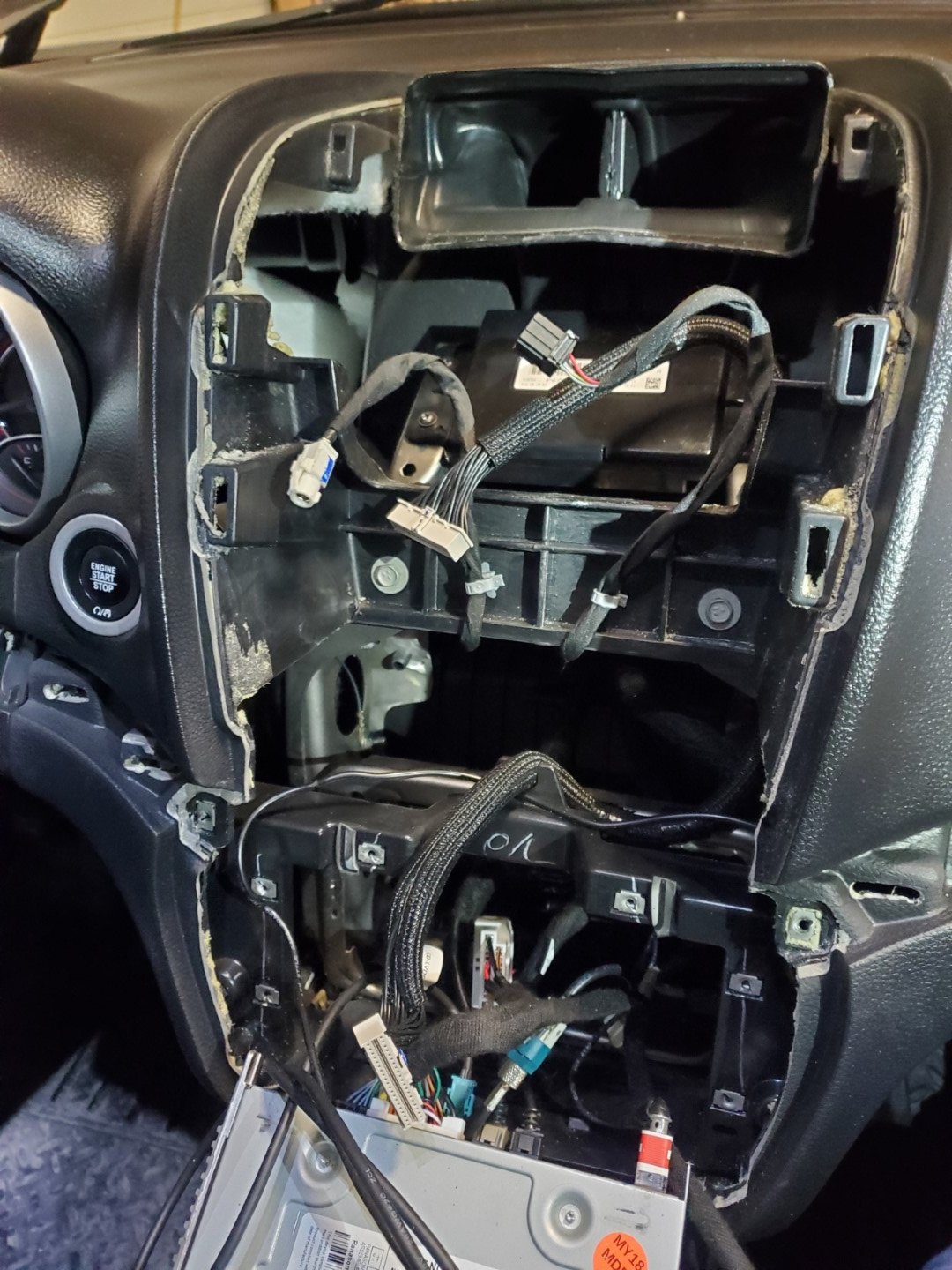

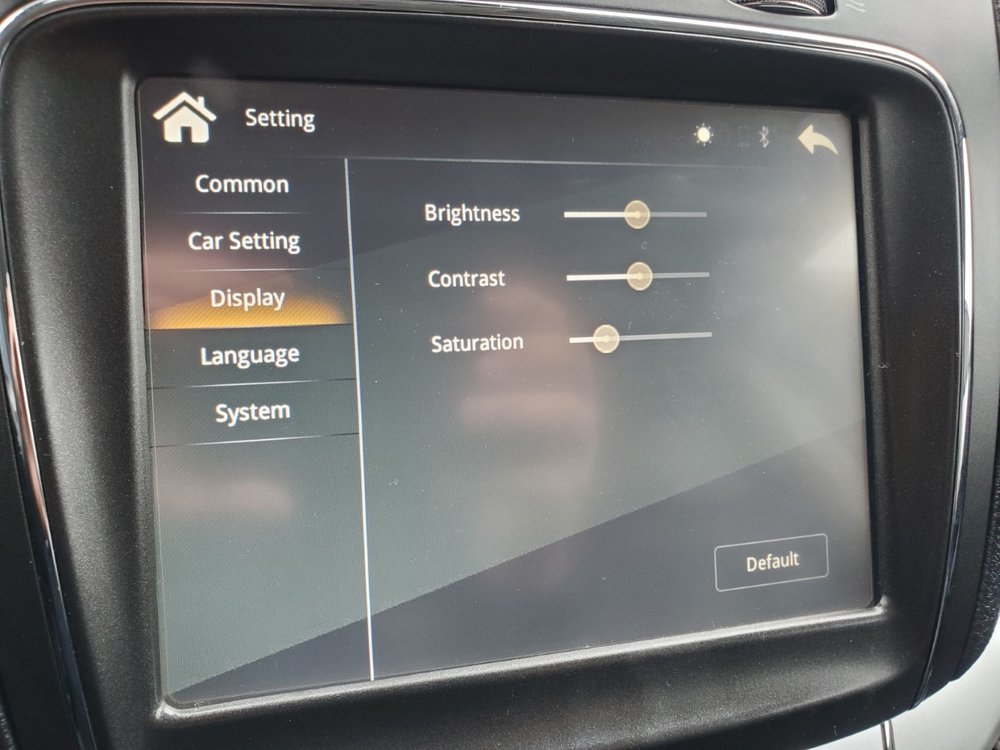

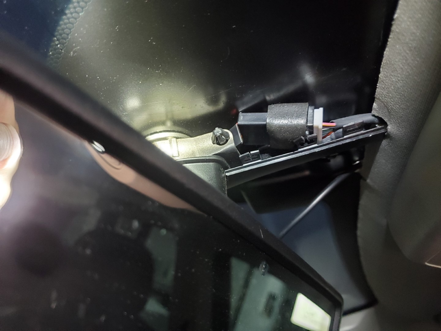

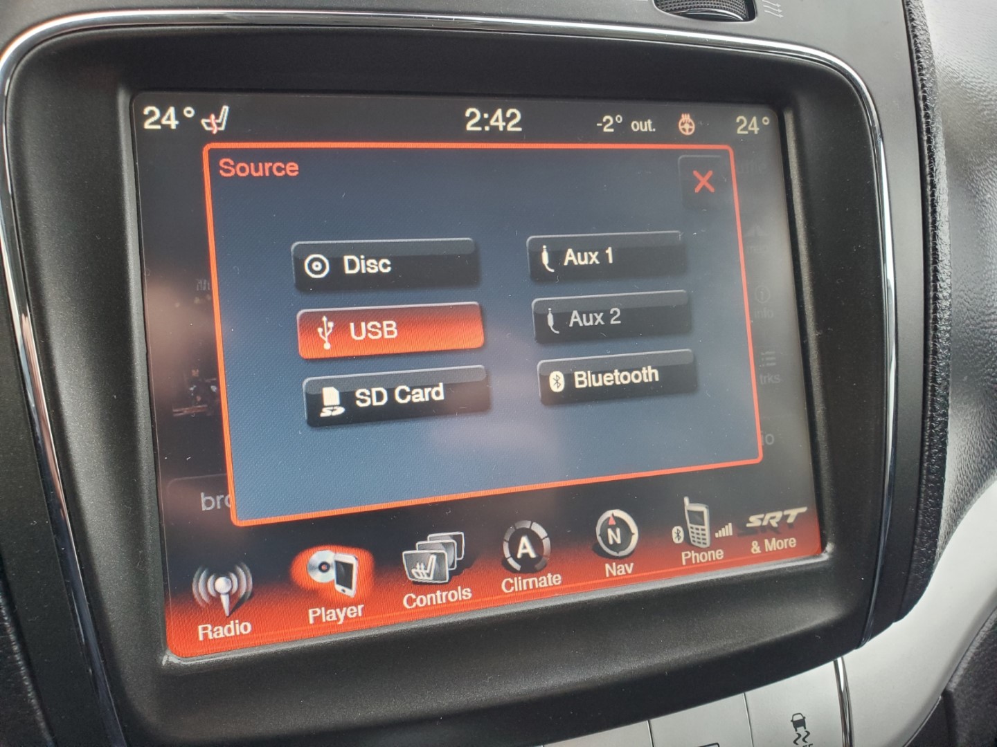

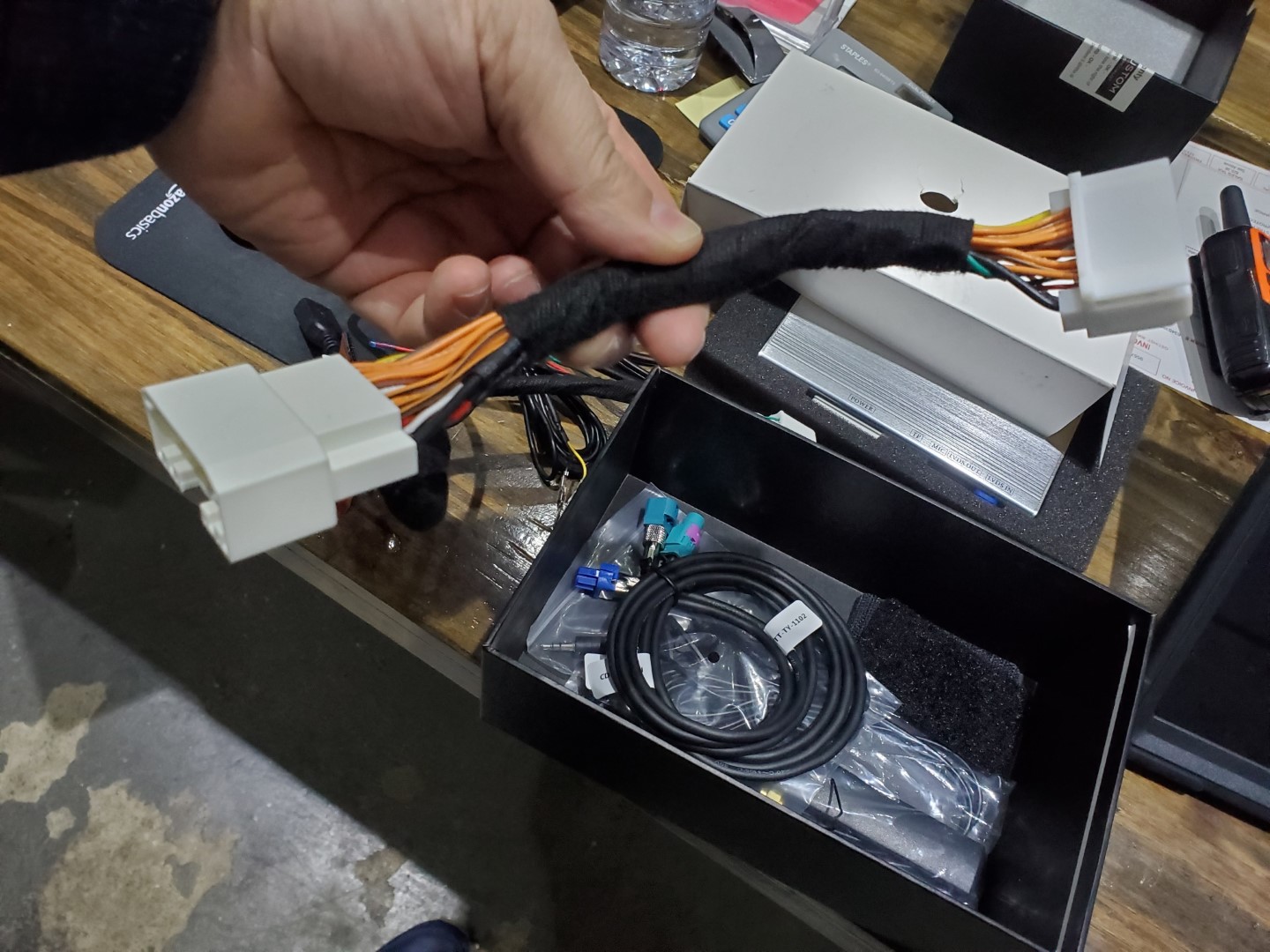

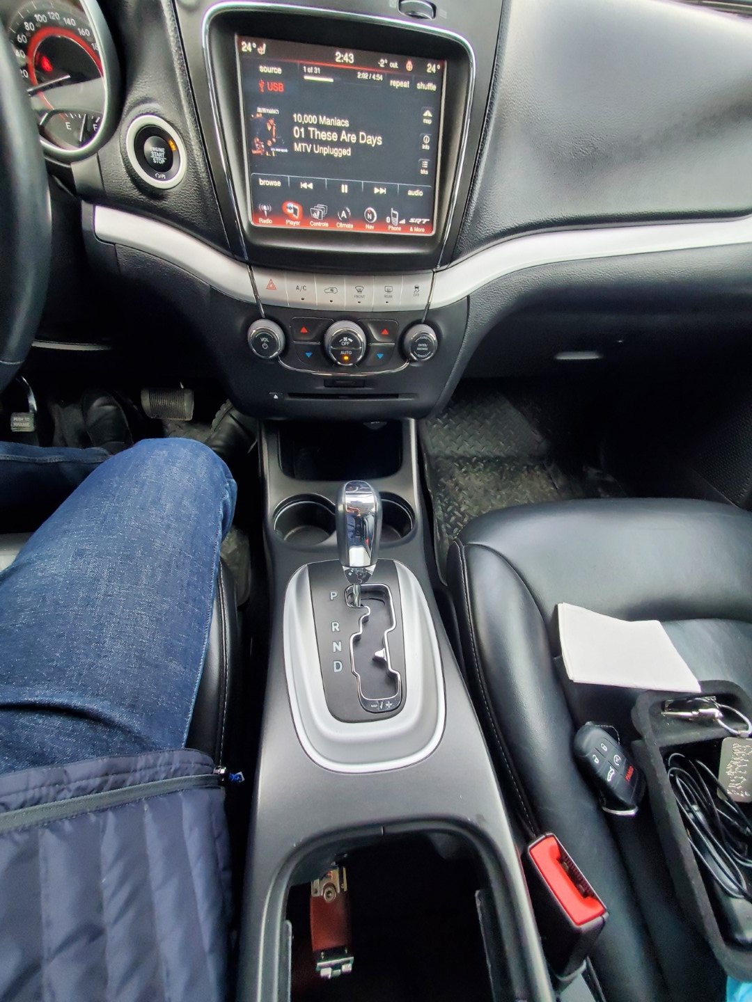

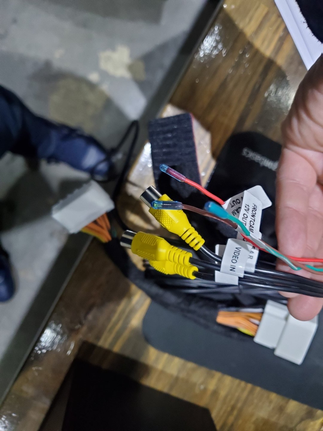

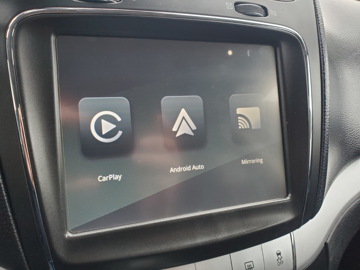

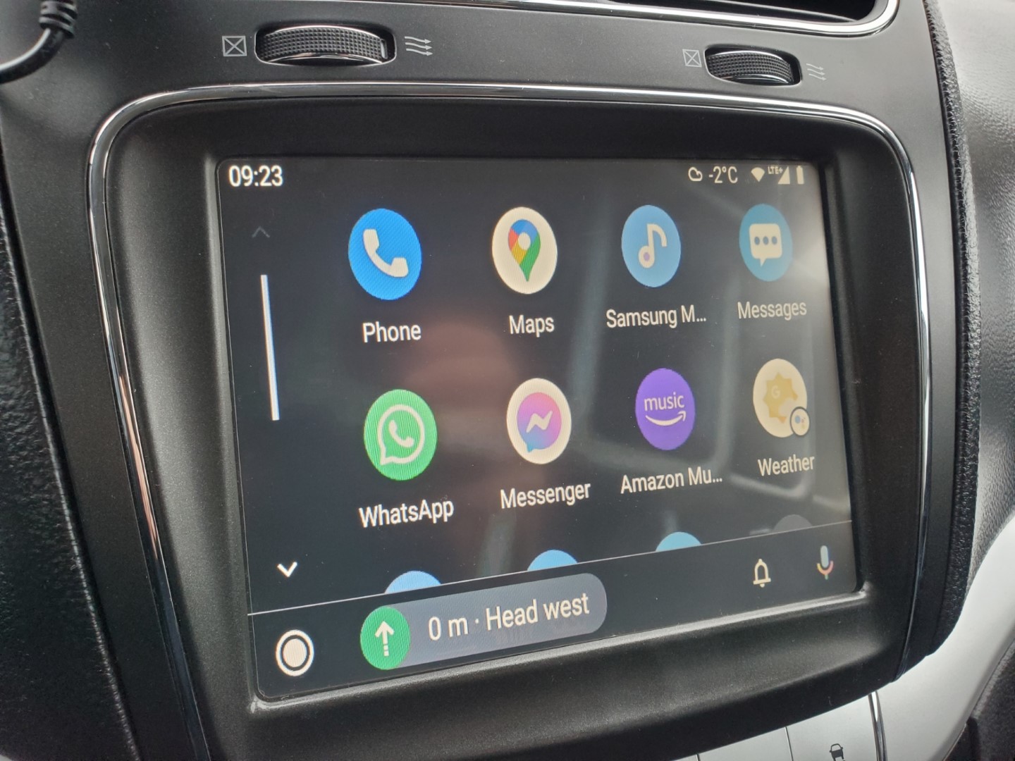

Miguel Pereira Posted December 20, 2021 Report Share Posted December 20, 2021 (edited) Hello: A lot of updates! I'll keep posting as get more experience... Unit arrived. Is a newer generation that allows wireless Android Auto and Apple Carplay. Installation was pretty straight forward, although I had and should investigate the microphone setup. I'll explain further down. Connection to backup camera is already done through the cable - there's more options for extra cameras or after market. All you need is to press the back button to change between Uconnect and the Interface. It DOESN"T need any mod to the screen. you just plug the screen "LVDS" to the cable supplied. Edited December 20, 2021 by Miguel Pereira DJshado and NavalLacrosse 2 Quote Link to comment Share on other sites More sharing options...
NavalLacrosse Posted December 23, 2021 Report Share Posted December 23, 2021 Bravo sir! I take it because the screen is using the reverse video input, no touch screen features work?) Needless to say, even if there are some drawbacks, you've casually did the impossible, and brought the Journey up to par with modern cars infotainment. Bravo!!! Quote Link to comment Share on other sites More sharing options...
Miguel Pereira Posted December 23, 2021 Report Share Posted December 23, 2021 (edited) 5 minutes ago, NavalLacrosse said: Bravo sir! I take it because the screen is using the reverse video input, no touch screen features work?) Needless to say, even if there are some drawbacks, you've casually did the impossible, and brought the Journey up to par with modern cars infotainment. Bravo!!! Hello Naval: It takes the reverse video signal rom the factory wiring/plug. Also all touch screen features are fully functional on both the original UConnect and new interface Edited December 23, 2021 by Miguel Pereira 2late4u and NavalLacrosse 1 1 Quote Link to comment Share on other sites More sharing options...

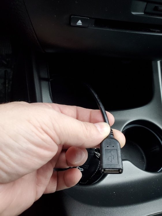

John/Horace Posted December 23, 2021 Report Share Posted December 23, 2021 Very impressive install, great pics. No hand cuts from dash work, also amazing ?. Does the factory console USB jack stay functional and the second corded USB input in pic act as another input? No issues with heated seats and heated steering wheel , you have them correct. If you don’t have a factory back up camera already and only bumper back up sensors; you can plug and play an aftermarket cam without any extra programming ? With screen mirroring and data so cheap now, you could just run Waze which has reasonable traffic updates ; forget about the factory nav altogether. Nice to have both options. Thanks again for all the info. Quote Link to comment Share on other sites More sharing options...
Miguel Pereira Posted December 23, 2021 Report Share Posted December 23, 2021 42 minutes ago, John/Horace said: Very impressive install, great pics. No hand cuts from dash work, also amazing ?. Does the factory console USB jack stay functional and the second corded USB input in pic act as another input? No issues with heated seats and heated steering wheel , you have them correct. If you don’t have a factory back up camera already and only bumper back up sensors; you can plug and play an aftermarket cam without any extra programming ? With screen mirroring and data so cheap now, you could just run Waze which has reasonable traffic updates ; forget about the factory nav altogether. Nice to have both options. Thanks again for all the info. Hey John: Factory console USB still works and plays. Pictures attached. If you don't have factory camera, this system has the RCA plug and the wiring. Additionally has in both cases extra video inputs for front camera and aftermarket parking sensors. DJshado, JAR414 and John/Horace 1 2 Quote Link to comment Share on other sites More sharing options...

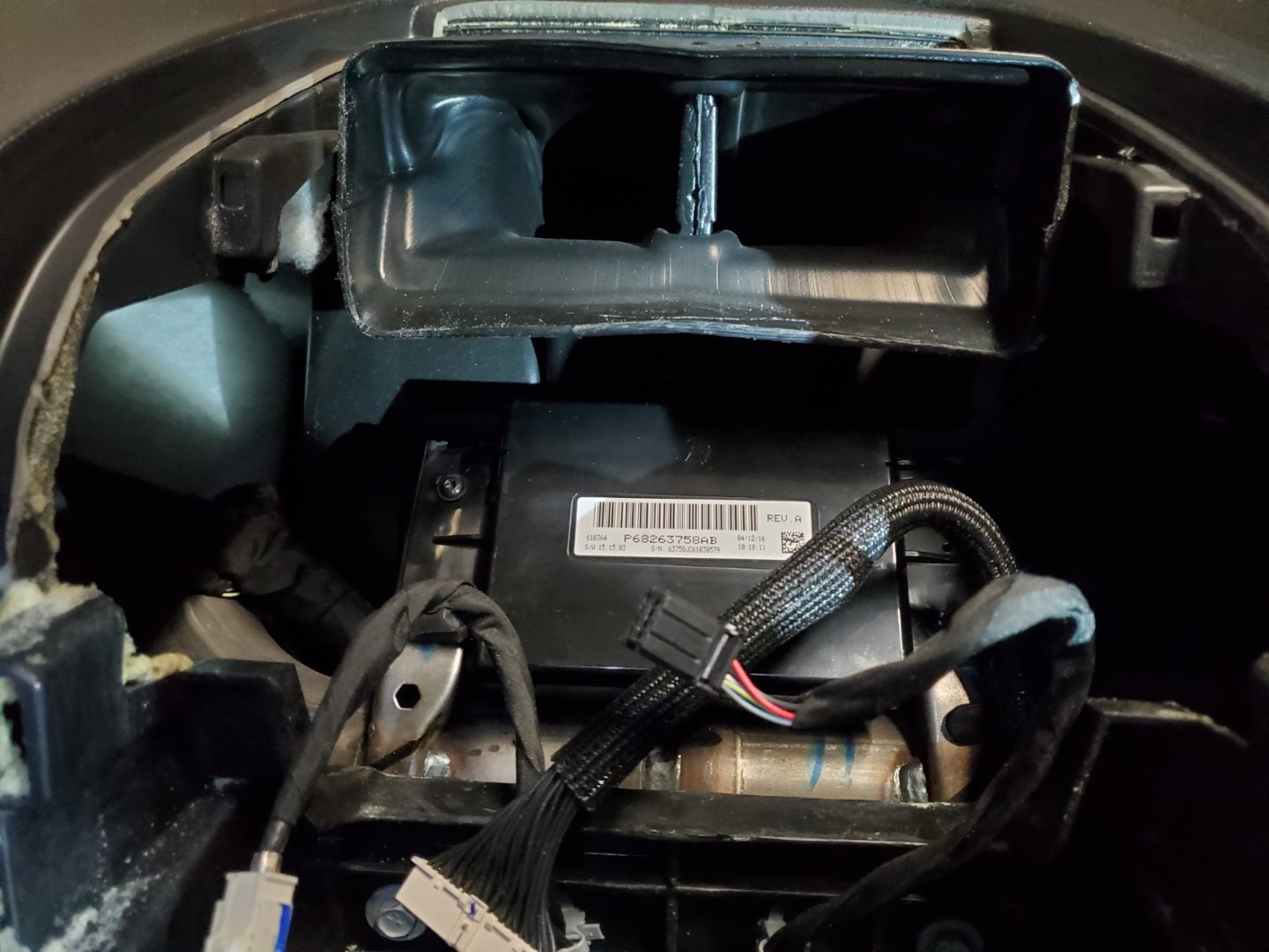

JAR414 Posted January 14, 2022 Report Share Posted January 14, 2022 The only question I have is, does it require you to remove the screen? Ok, one more question, where does that box on the kit go...behind the screen? Otherwise, incredibly cool! Quote Link to comment Share on other sites More sharing options...
Miguel Pereira Posted January 14, 2022 Report Share Posted January 14, 2022 1 minute ago, JAR414 said: The only question I have is, does it require you to remove the screen? Ok, one more question, where does that box on the kit go...behind the screen? Otherwise, incredibly cool! I had to remove the screen so I could pass cables and install. I installed it behind the screen. No modifications... Just plug , test to be safe and put back. Quote Link to comment Share on other sites More sharing options...
JAR414 Posted January 14, 2022 Report Share Posted January 14, 2022 Just now, Miguel Pereira said: I had to remove the screen so I could pass cables and install. I installed it behind the screen. No modifications... Just plug , test to be safe and put back. Ok, that is officially COOL. I need to get me one of those! Miguel Pereira 1 Quote Link to comment Share on other sites More sharing options...
Miguel Pereira Posted January 14, 2022 Report Share Posted January 14, 2022 1 minute ago, JAR414 said: Ok, that is officially COOL. I need to get me one of those! I think is a late but good solution. Support is great form the Italian supplier. I don't find these latest units being sold elsewhere, including AliExpress. I assume that I, not the interface, did something wrong with the OEM Mic. I couldn't get it to work. That's why I installed the supplied one. Note that using the supplied mic you can still use the VR button on the left steering wheel control. Press it and triggers either the Apple Siri or Google assistant. It does also activates the Uconnect VR but i say the command, the interface/phone listens and processes. Then i just press VR again to cancel the Uconnect attempt. Things I don't like: The next/previous track don't work as it's connected via AUX1. I'm playing still with settings on phone, android auto and the interface as I don't like the interface connecting and showing up on screen as soon as i get into the car. I would prefer to idle and only starting when i press the back button which is the way to change systems. Quote Link to comment Share on other sites More sharing options...
JAR414 Posted January 17, 2022 Report Share Posted January 17, 2022 On 1/14/2022 at 2:26 PM, Miguel Pereira said: I think is a late but good solution. Support is great form the Italian supplier. I don't find these latest units being sold elsewhere, including AliExpress. I assume that I, not the interface, did something wrong with the OEM Mic. I couldn't get it to work. That's why I installed the supplied one. Note that using the supplied mic you can still use the VR button on the left steering wheel control. Press it and triggers either the Apple Siri or Google assistant. It does also activates the Uconnect VR but i say the command, the interface/phone listens and processes. Then i just press VR again to cancel the Uconnect attempt. Things I don't like: The next/previous track don't work as it's connected via AUX1. I'm playing still with settings on phone, android auto and the interface as I don't like the interface connecting and showing up on screen as soon as i get into the car. I would prefer to idle and only starting when i press the back button which is the way to change systems. Do you get limited to using your phone for music, or can you use the interface while using your car's radio? Quote Link to comment Share on other sites More sharing options...

Miguel Pereira Posted January 17, 2022 Report Share Posted January 17, 2022 Just now, JAR414 said: That would be a reason for me to think about it. I guess I could let the SiriusXM subscription for this car go, and stream from my phone... Any need to splice wires? No wiring striping at all specially if use the supplied microphone. I do have and use Sirius on the car. But note that we also have the Sirius XM app.... and Sirius sounds BETTER via the app. Quote Link to comment Share on other sites More sharing options...
JAR414 Posted January 17, 2022 Report Share Posted January 17, 2022 Just now, Miguel Pereira said: No wiring striping at all specially if use the supplied microphone. I do have and use Sirius on the car. But note that we also have the Sirius XM app.... and Sirius sounds BETTER via the app. Agreed. And the app allows you to move between car and house listening to a specific show (CBS Sports Radio shows for me in the mornings...) And I can always keep the other subscriptions in the account active. I am very tempted to spend the US $400 on it Quote Link to comment Share on other sites More sharing options...
