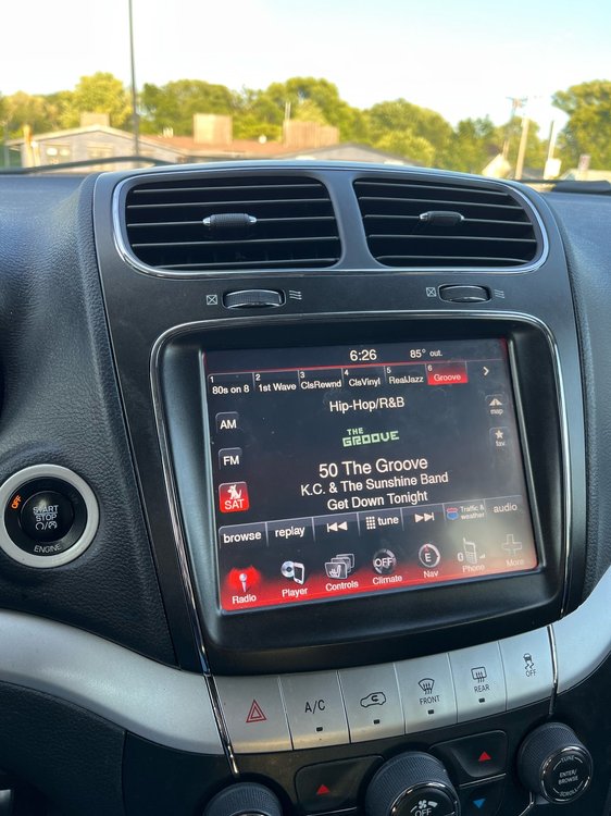

JAR414 Posted August 4, 2023 Report Share Posted August 4, 2023 (edited) After following that video, here's the results! Before and after After installing the unit and verifying it works, but before you close everything up, you'll want to turn off the car and radio, then move rocker switch "2" to the "1" or "On" position. Then restart the radio by going to Acc mode. You will see a little + sign in a corner...that's for helping you calibrate the touchscreen. After you finish the calibration, return the rocker switch to "0" or "Off". Watch this video for the procedure Edited August 4, 2023 by JAR414 larryl 1 Quote Link to comment Share on other sites More sharing options...
