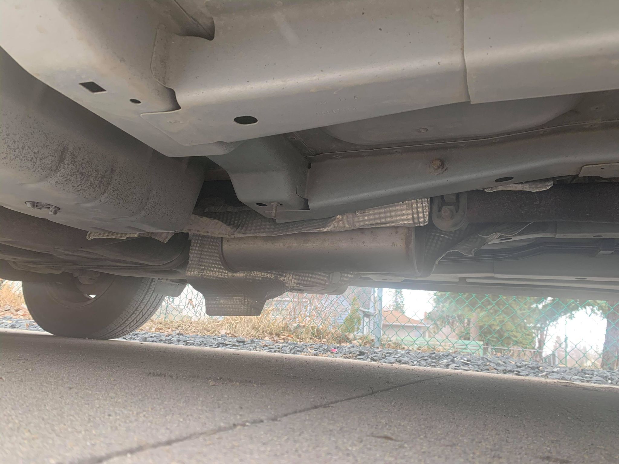

wpginterceptor Posted April 20, 2021 Report Share Posted April 20, 2021 Anybody else have this problem?? the heat shield around the exhaust is startin to fall... Should I just rip it out or try and put it back?? Quote Link to comment Share on other sites More sharing options...
John/Horace Posted April 20, 2021 Report Share Posted April 20, 2021 (edited) I would grab a few sheet metal screws and washers and secure it again. The heat shields are there for a reason. Wife’s Journey 3.6 heat guard started hanging down and rubbing on driveshaft, had to add fasteners last year. There have been grass fires from missing catalytic converter guards. Carpeting and electrical is protected sometimes as well. They are really flimsy and not well secured. Edited April 20, 2021 by John/Horace 2late4u and OhareFred 2 Quote Link to comment Share on other sites More sharing options...

John/Horace Posted August 9, 2021 Report Share Posted August 9, 2021 (edited) If the studs aren't too rusted yet you might want to reinforce the other fastener locationsnow. Not later. I'm in rust belt so I had a harder time cleaning up studs. Fender washers allow just one washer, but enough thread there anyway. The underside of that journey from the peg is amazing, in first post. No salt, sigh. Edited August 9, 2021 by John/Horace Quote Link to comment Share on other sites More sharing options...
