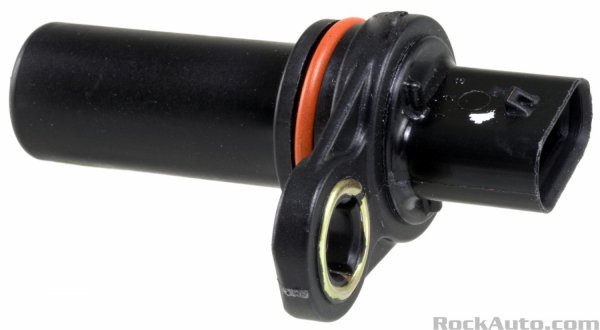

John/Horace Posted April 29, 2021 Report Share Posted April 29, 2021 (edited) Horn and ignition wiring not connected, stalling probably co-incidence. Scan for codes and probably replace $30 CPS sensor. Unhook horn wiring plug and car will still stall anyway. https://www.rockauto.com/en/catalog/dodge,2011,journey,2.4l+l4,1447563,ignition,crankshaft+position+sensor,7196 Edited April 29, 2021 by John/Horace Quote Link to comment Share on other sites More sharing options...

John/Horace Posted April 30, 2021 Report Share Posted April 30, 2021 I would try to get oem if you can, pretty important sensor. Should be plug and play normally.There is a manual procedure to teach it if necessary. Haven’t changed one on a dodge yet, several on other vehicles that were plug and play. Daughter in laws 2.4 had a random stalling issue from CPS . Quote Link to comment Share on other sites More sharing options...
