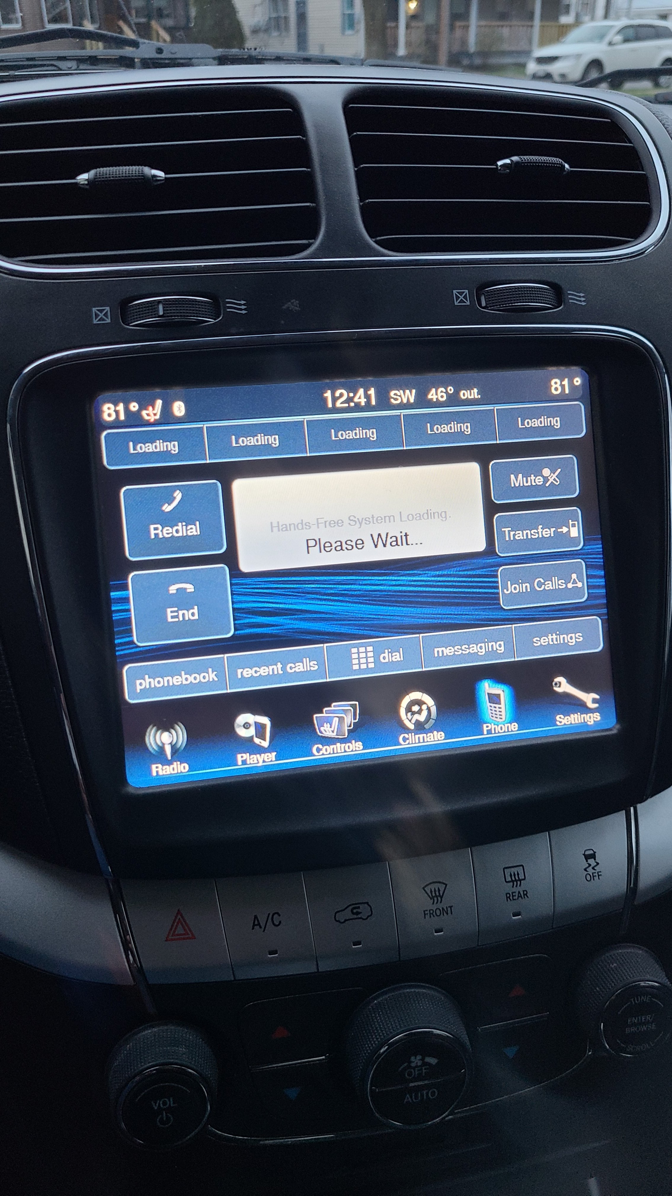

alex519 Posted May 1, 2021 Author Report Share Posted May 1, 2021 1 minute ago, OhareFred said: I corrected that, stupid autocorrect. disconnect the negative cable for 30-45 mins Alright I will right now I'm gonna take pictures as well of what I see before disconnecting it Quote Link to comment Share on other sites More sharing options...
alex519 Posted May 1, 2021 Author Report Share Posted May 1, 2021 10 minutes ago, OhareFred said: I corrected that, stupid autocorrect. disconnect the negative cable for 30-45 mins Here's a pic of what I see. I disconnected the battery and have a timer set for 45 min Quote Link to comment Share on other sites More sharing options...

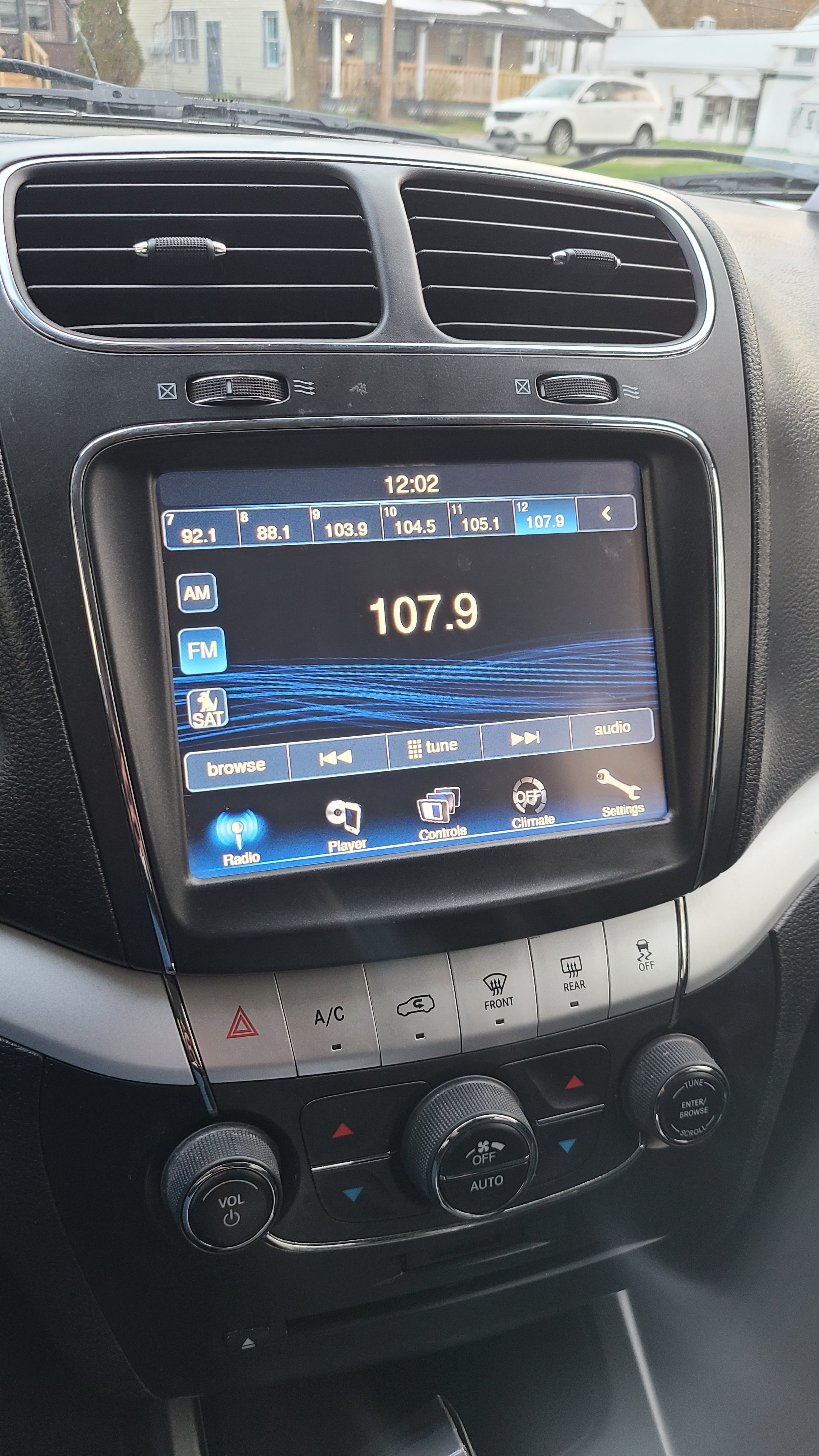

alex519 Posted May 1, 2021 Author Report Share Posted May 1, 2021 My screens blue whys that 51 minutes ago, OhareFred said: I corrected that, stupid autocorrect. disconnect the negative cable for 30-45 mins Quote Link to comment Share on other sites More sharing options...
OhareFred Posted May 1, 2021 Report Share Posted May 1, 2021 Go into settings. Looks like it may have reset to a default screen. Does everything work? AM/FM, Sat if you have it? Did you pair your phone? Does your phone show a UConnect option in your Bluetooth settings? Does UConnect show an option to pair a phone? Did you read the owners manual? Did you set up an account at Mopar.com? sorry for all the questions but your being pretty vague and it’s hard to tell what’s going on from my couch...? Quote Link to comment Share on other sites More sharing options...

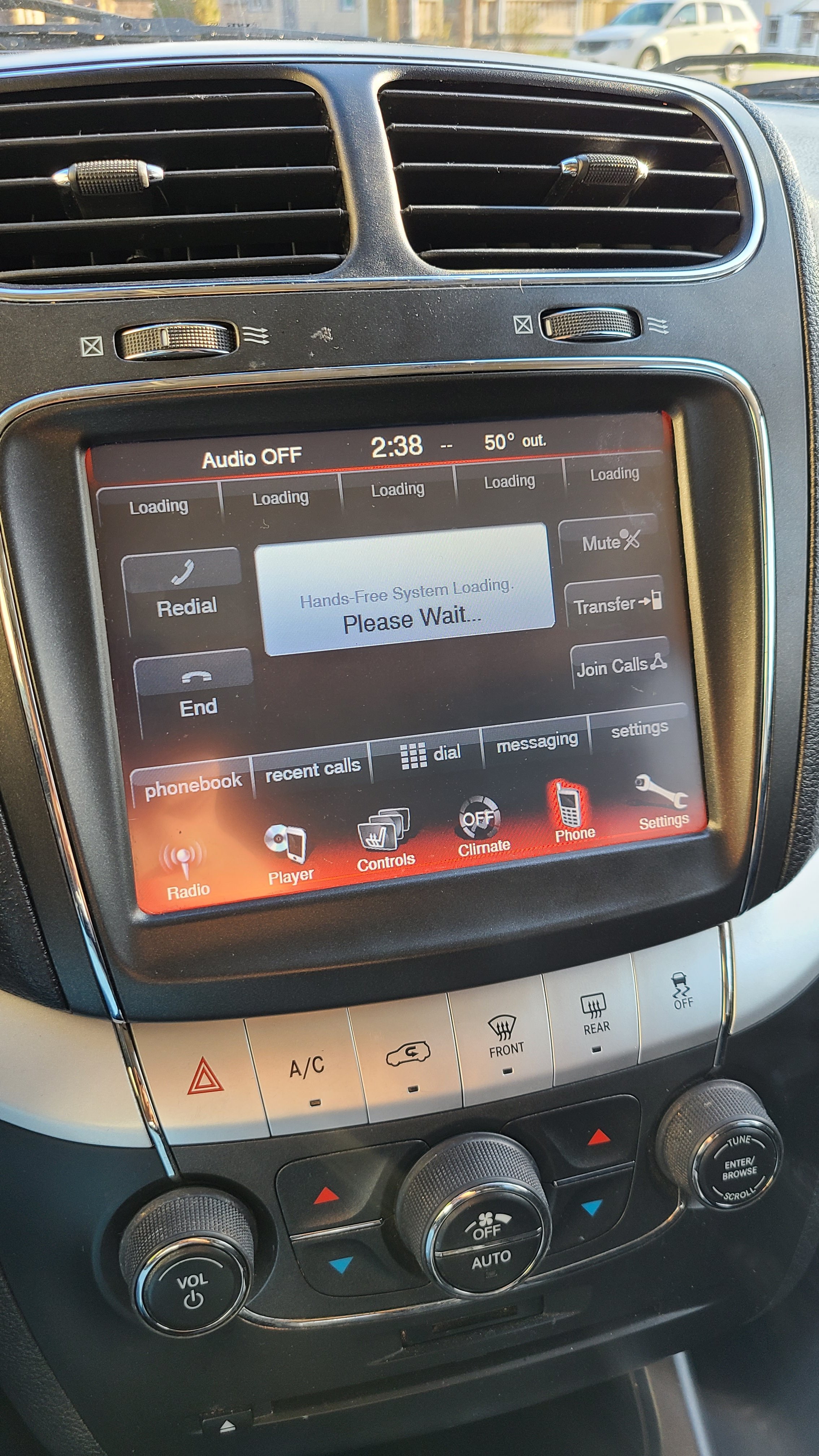

alex519 Posted May 2, 2021 Author Report Share Posted May 2, 2021 2 minutes ago, OhareFred said: Go into settings. Looks like it may have reset to a default screen. Does everything work? AM/FM, Sat if you have it? Did you pair your phone? Does your phone show a UConnect option in your Bluetooth settings? Does UConnect show an option to pair a phone? Did you read the owners manual? Did you set up an account at Mopar.com? sorry for all the questions but your being pretty vague and it’s hard to tell what’s going on from my couch...? Geez lol didn't miss a single question I did try to connect same problem this is what I got I'm driving my other dodge journey right now I have 3 of them but this one I feel like I'm going to really like if it works right ?? Quote Link to comment Share on other sites More sharing options...
alex519 Posted May 2, 2021 Author Report Share Posted May 2, 2021 So right now thats the screen still loading can't click to add or find a Bluetooth device Quote Link to comment Share on other sites More sharing options...
OhareFred Posted May 2, 2021 Report Share Posted May 2, 2021 I would say the Bluetooth/handsfree module is bad. I have an 09 and the BT/HF module was replaceable , although I never had to until I took it out and installed a Kenwood unit. UConnect would not work with my IPhone 11. The UConnect system was too old and UConnect was not going to update it. So if the module is replaceable you can go that route, an aftermarket unit with handsfree (like my Kenwood) or a refurbished factory unit (factoryradios.com, try them) Good luck, maybe someone else will chime in with other suggestions..... Quote Link to comment Share on other sites More sharing options...

NavalLacrosse Posted May 17, 2021 Report Share Posted May 17, 2021 i've never encountered a Blue version of the screen of a Dodge journey- This leads me to believe that the screen is from a Chrysler 200 or Chrysler 300, and NOT from Dodge Journey originally. Maybe it was somehow re-programmed to look like the red Dodge version, but after a hard reset it reverted to it's original colors. My guess is that the radio was installed after the car what manufactured, (possibly as an upgrade from 4.3 Uconnect to 8.4 Uconnect. This upgrade is not easy when you're going from one Dodge Journey to another, yet alone from a Chrysler to a dodge. I suspect there is some incompatibility between the head unit, and the dodge's BT module. Could be bad module, needing to be replaced bad wiring (whoever installed the Chrysler 8.4" Display didn't install all the wires correctly burned out / removed BT module fuse (found in the fuse box located behind the glove box) incompatibility between the Chrysler head, (2011+ Chrysler 300 unit, or 2015+ chrysler 200 head unit) and the Dodge Journey BT Module (which is possibly the original from the DJ Quote Link to comment Share on other sites More sharing options...
