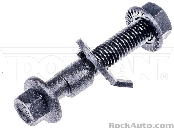

When there is a camber bolt mount it changes alignment, so people paint mark fastner and try to assemble to same spot.
So in this case you should be okay. Mechanics will say you should always do an alignment after any suspension work, regardless.
The front struts have camber adjustment alignment bolts like in pic. Rear don’t, as you can see with the removed bolts you have.
