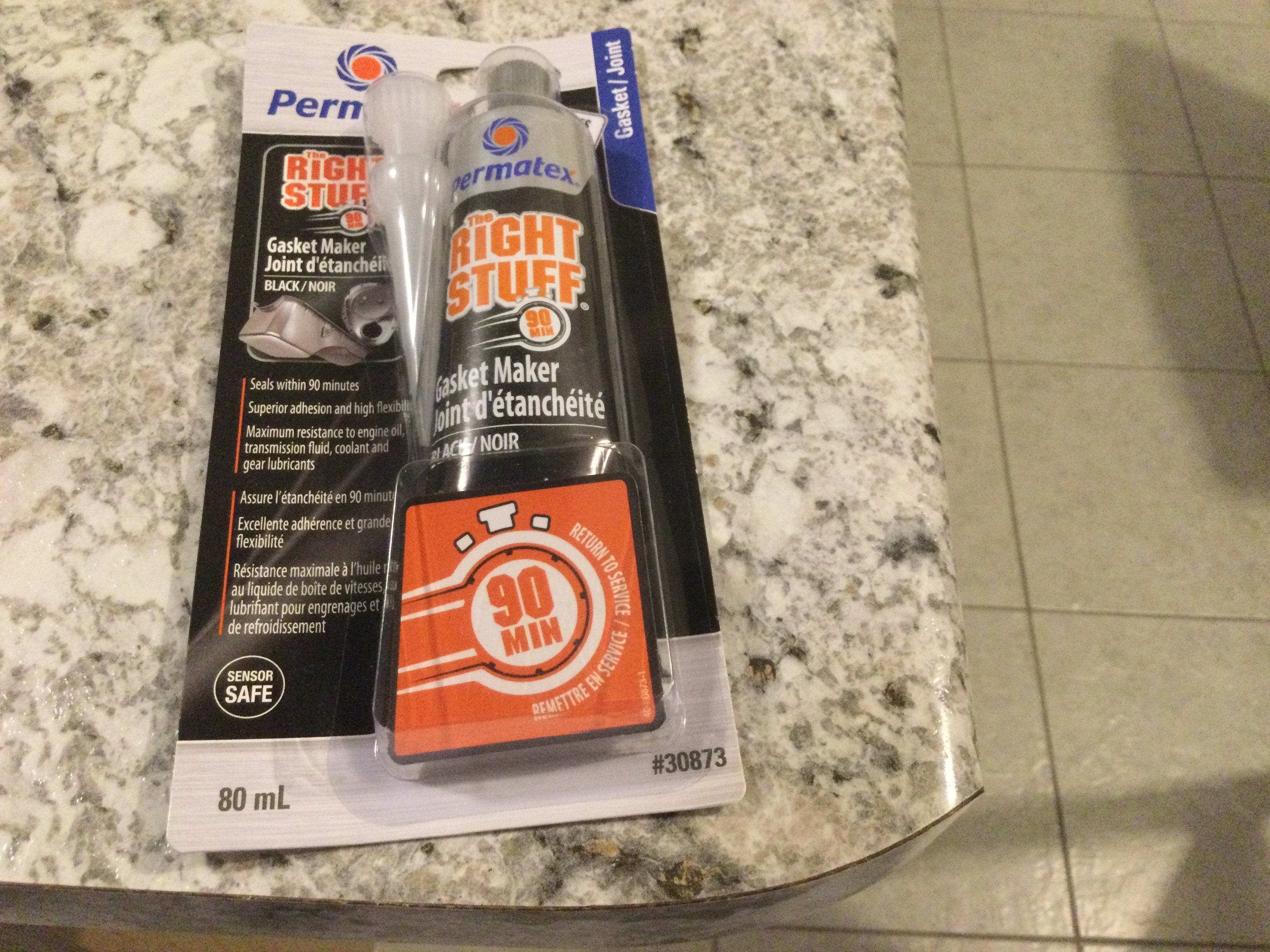

Degrease,with lacquer thinner and wait an hour ish with finger tight torque on atv first, then do final torque.
There is a 90 min dry atv, I’ve used once successfully, pic below.
With oil dripping down on your degreased surface, it’s a little tricky, gotta work fast.
Some vehicles like F150:use an aluminum crush shim with an attatched rubber gasket, dry no adhesive used, drive immediately on their transmission 6R80. Nothing to clean and gasket/shim even reusable. But $40 to buy new one.
After finger tight dry time for atv. Don’t go to full torque in one step, go to full 105 in pounds in three lower  steps.
