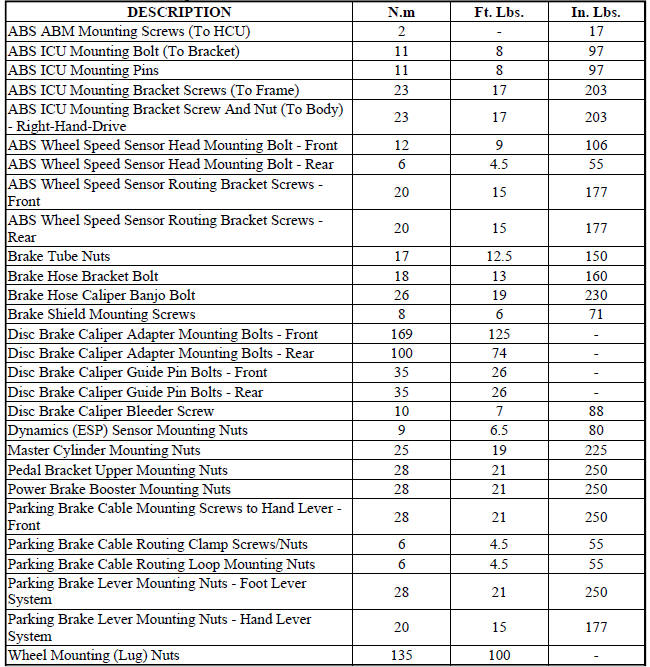

2013 Journey SXT front & rear brakes torque specs
Hello guys,
This is my first time doing brakes I got all the tools & lubricants I would need the torque specs for front & rear brake bolts, please
Model is 2013 dodge journey SXT (FWD)
Thank you all!
