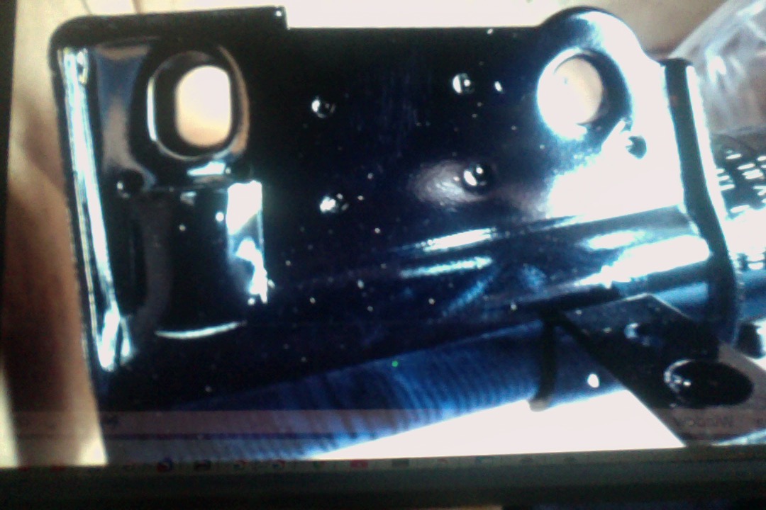

bigbear372 Posted June 24, 2021 Author Report Share Posted June 24, 2021 On 6/14/2021 at 11:15 AM, Locosiete said: I used KYB for the Rear and Gabriel for the front. The Gabriel brand to me felt stronger then the factory ones. They are also heavier so not sure if weight is a concern for you. I think either brand would be a great choice. I wouldn't go with the cheapest brand personally unless your familiar with it already. Otherwise Monroe is a good brand as well. So after finally tracking down a set of front gabriel's for the awd's i got around to messing with the car. Started working on the driver side, not too bad, pretty straight forward other than those darn wiper blade not coming off and the link rod bolts or whatever you want to call them. Either way, i got it mounted up but was left a little unsure. The Gabriel bottom mount bolt hole is more of a slot that allows for some movement vs the OEM that is a tight splined hole. Do you have any experience with this? When it is all torqued down is it going to shift at all? What is the proper placement? It's almost as if there should be a centering block or a special square flanged nut to fit between the metal parts on the mount to center and keep it free from play. Locosiete 1 Quote Link to comment Share on other sites More sharing options...
5rebel9 Posted June 24, 2021 Report Share Posted June 24, 2021 You WILL want to have an alignment done if the units you got are slotted like that. It is there for being able to adjust the camber of the wheel, Some places will charge extra to install a special eccentric head bolt for precise adjustment. Others will just loosen the 2 bolts and have an assistant pull on the wheel for adj. and then tighten bolts back up. I did this kind of work and alignments for 20+years. When struts first began use, replacements were not slotted and we had to grind the bottom hole to get camber adjustability. Middle years they started coming thru slotted (aftermarket), and lately I've seen the trend back to regular bolt holes, but some still are slotted. Properly torqued, TOU will be fine and the slot gaps will NOT be of any concern. Locosiete and bigbear372 2 Quote Link to comment Share on other sites More sharing options...
bigbear372 Posted June 24, 2021 Author Report Share Posted June 24, 2021 45 minutes ago, 5rebel9 said: You WILL want to have an alignment done if the units you got are slotted like that. It is there for being able to adjust the camber of the wheel, Some places will charge extra to install a special eccentric head bolt for precise adjustment. Others will just loosen the 2 bolts and have an assistant pull on the wheel for adj. and then tighten bolts back up. I did this kind of work and alignments for 20+years. When struts first began use, replacements were not slotted and we had to grind the bottom hole to get camber adjustability. Middle years they started coming thru slotted (aftermarket), and lately I've seen the trend back to regular bolt holes, but some still are slotted. Properly torqued, TOU will be fine and the slot gaps will NOT be of any concern. Thanks for the info. I'm definitely getting it aligned 1st thing after the struts are replaced. If I take it to a dodge dealership will then align it properly with the new aftermarket struts and added adjustability or should I take it to more of a alignment specialty shop you think? Quote Link to comment Share on other sites More sharing options...
5rebel9 Posted June 24, 2021 Report Share Posted June 24, 2021 I don't normally suggest dealers. BUT it depends on the individual dealer if it has a good alignment machine and "rack". I myself would use an independent alignment/suspension shop. Most of them will try their best to have everything to optimum settings and not just "in the range tolerance". Locosiete, 2late4u and bigbear372 3 Quote Link to comment Share on other sites More sharing options...
