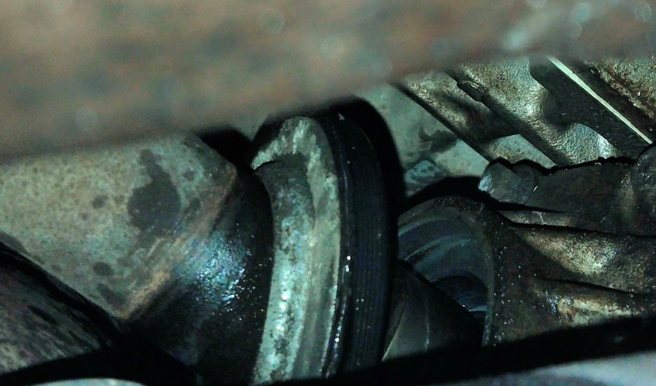

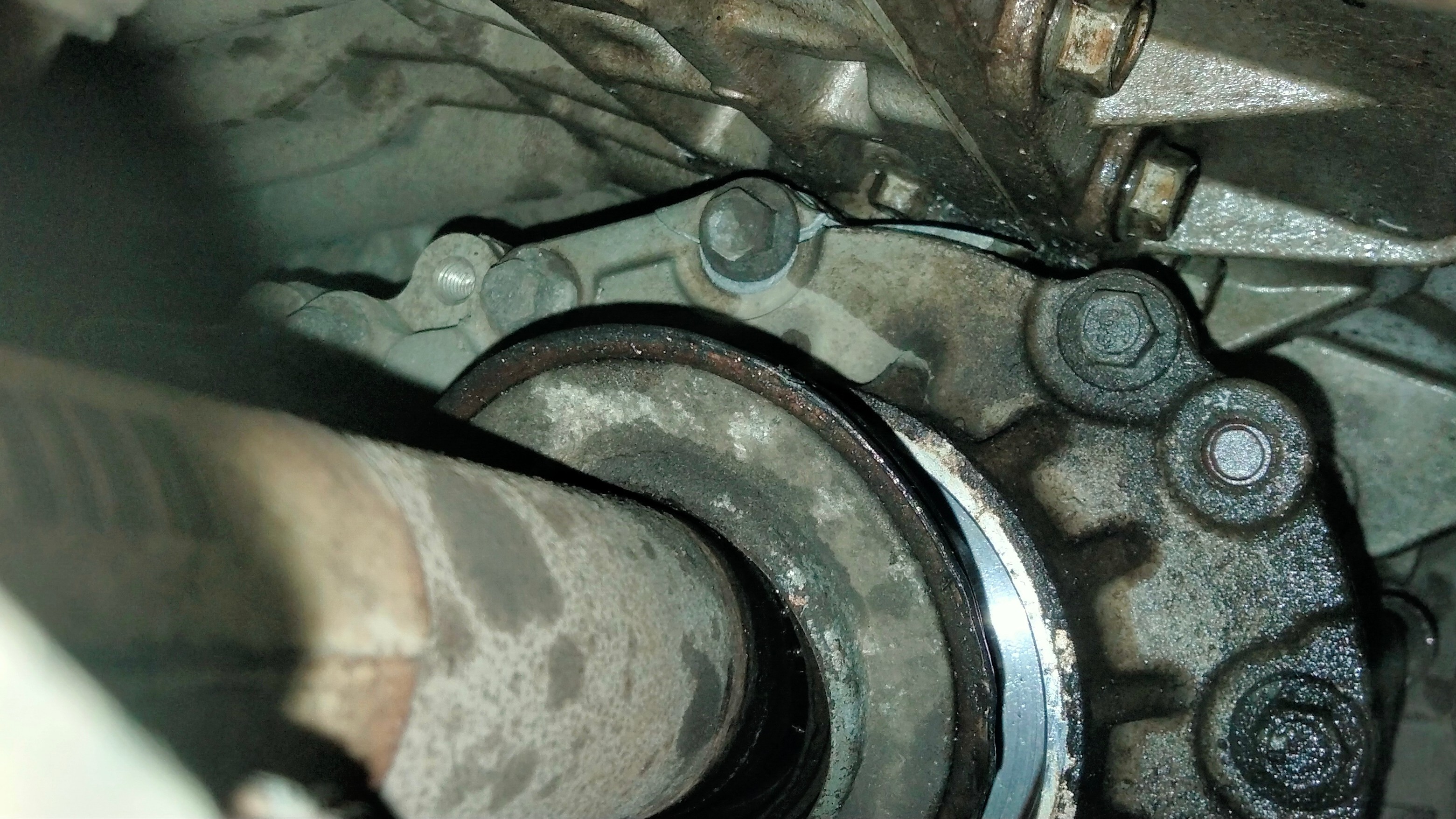

Raythecaddie Posted July 10, 2021 Report Share Posted July 10, 2021 While I was driving I heard a bang, then a constant knocking sound. At first thought I blew a tire because I could smell something like burning rubber. When I got home I looked under the vehicle and I could see transmission had leaked all over the exhaust. I took a couple photos of the side of the gearbox (the driveshaft going to the Front passenger tire, and it looks like something broke of the side of the gearbox. The transmission makes a horrible knocking sound, so I assume I nee to replace the entire gearbox. In Canada what is the typical cost for this fix? Quote Link to comment Share on other sites More sharing options...
Raythecaddie Posted July 10, 2021 Author Report Share Posted July 10, 2021 Is this the Gearbox? Transfer case? or differential? Quote Link to comment Share on other sites More sharing options...
5rebel9 Posted July 11, 2021 Report Share Posted July 11, 2021 Being on the pass. side, it would be the transfer case. Still a labor intensive job to tackle for R&R. Quote Link to comment Share on other sites More sharing options...
Raythecaddie Posted July 11, 2021 Author Report Share Posted July 11, 2021 I guess I'm looking at a 3k bill to fix this....arggggghhhhhh!!!! Quote Link to comment Share on other sites More sharing options...
John/Horace Posted July 11, 2021 Report Share Posted July 11, 2021 (edited) I don’t think it’s the transfer case. https://www.moparpartscanada.ca/oem-parts/mopar-transfer-case-rl071706aa?c=Zz10cmFuc2Zlci1jYXNlJnM9dHJhbnNmZXItY2FzZSZsPTEmbj1TZWFyY2ggUmVzdWx0cyZhPWRvZGdlJm89am91cm5leSZ5PTIwMTAmdD1yLXQmZT0zLTVsLXY2LWdhcw%3D%3D Front drive shafts come out of the transaxle part of transmission. Unfortunately I think you will need new tranny if the aluminum casing is cracked. . Could try reman or wrecker units with lower miles, LKQ useful. Could be just a blown c/v shaft which took out lip seal on side of tranny and caused leak. Maybe fixable and no new tranny if your lucky. Don’t drive it further, tow it. Edited July 11, 2021 by John/Horace 2late4u 1 Quote Link to comment Share on other sites More sharing options...
