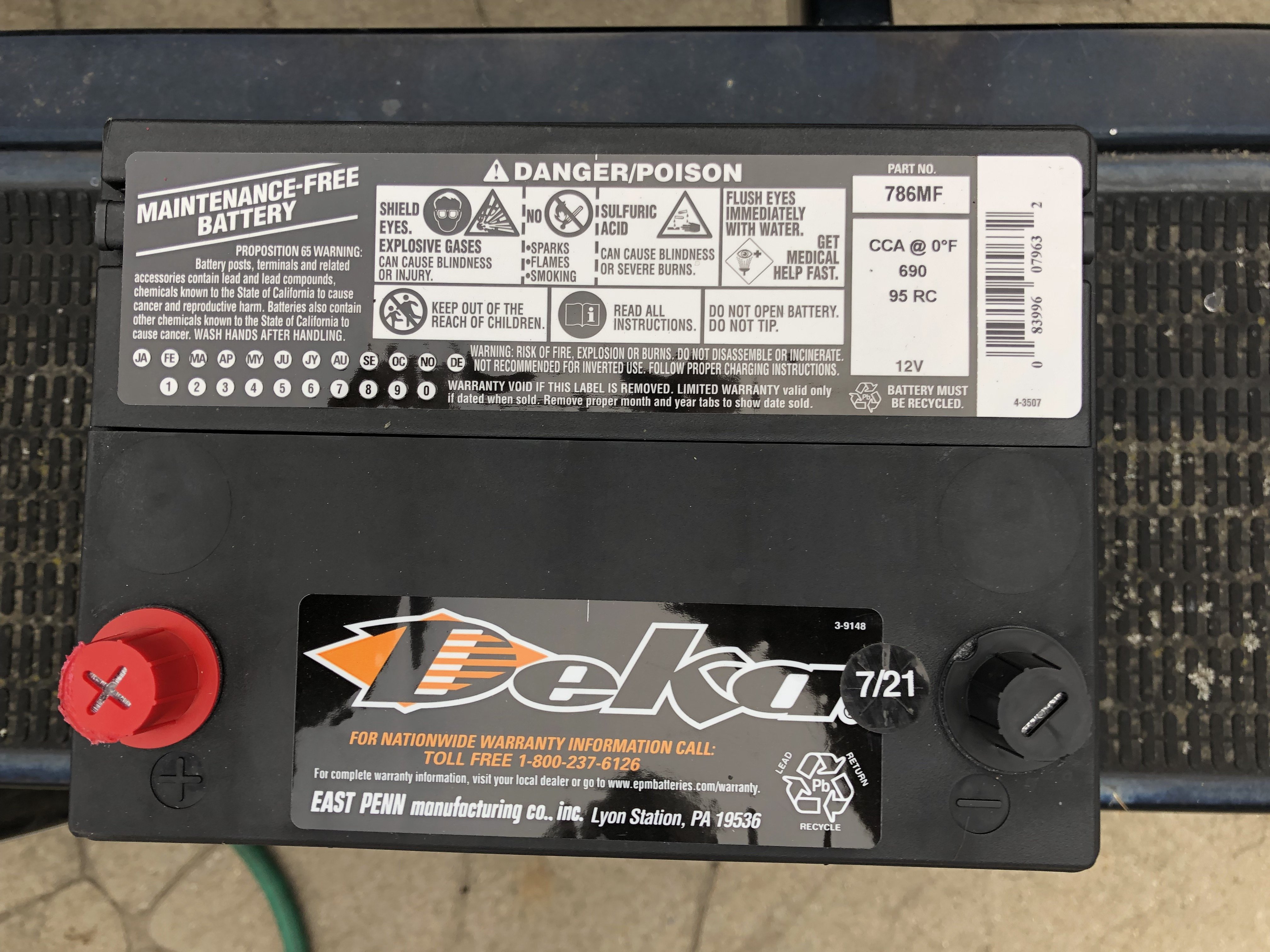

DodgeaWrench Posted July 13, 2021 Report Share Posted July 13, 2021 Over the weekend I replaced my battery. During the week, starting the car to go to work, it started up VERY weak. I knew something was going on. After work, for the ride home, same thing but this time the check engine light came on. I wasn't able to get anywhere that evening to read the code. Next morning, it would not start. All electrical would work, but it would not crank over when pressing the button. I couldn't get too mad as this was my own fault. Its a 2014 and the battery was still original. I was all set to replace it last fall due to age, but never did. This Spring I had priced up a new battery and even sprayed the terminals and mount with penetrating oil to prepare for the change, but again, did not pull the trigger. As expected, after the battery was replaced, the car started right up. I hope there is not an underlying issue of a drain or charging problem. Time will tell. Regardless that battery had to be replaced. I went with a Deka Ultimate 786MF battery, $120.00. (Deka Premium battery is all that is needed, but they were out of stock.) Deka has performed well in the boat so I figured I'd give them a try in the car. Summer Solstice and Mr G 2 Quote Link to comment Share on other sites More sharing options...
