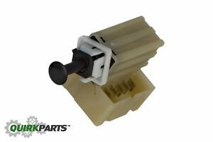

tsteves5 Posted July 14, 2021 Report Share Posted July 14, 2021 Did your switch look like this? If so, I just did one on my Town and Country a couple of weeks ago to fix a brake switch error code. I didn't have to go through a reset procedure. It just worked. Quote Link to comment Share on other sites More sharing options...
Dave miller Posted July 27, 2021 Author Report Share Posted July 27, 2021 Yes. It looks like that. Is there another type of switch for this model? Quote Link to comment Share on other sites More sharing options...
tsteves5 Posted July 27, 2021 Report Share Posted July 27, 2021 I just did a quick look on a couple of auto parts sites and all look like that. I wonder if your new switch is defective, or perhaps you have a wiring issue. Quote Link to comment Share on other sites More sharing options...
