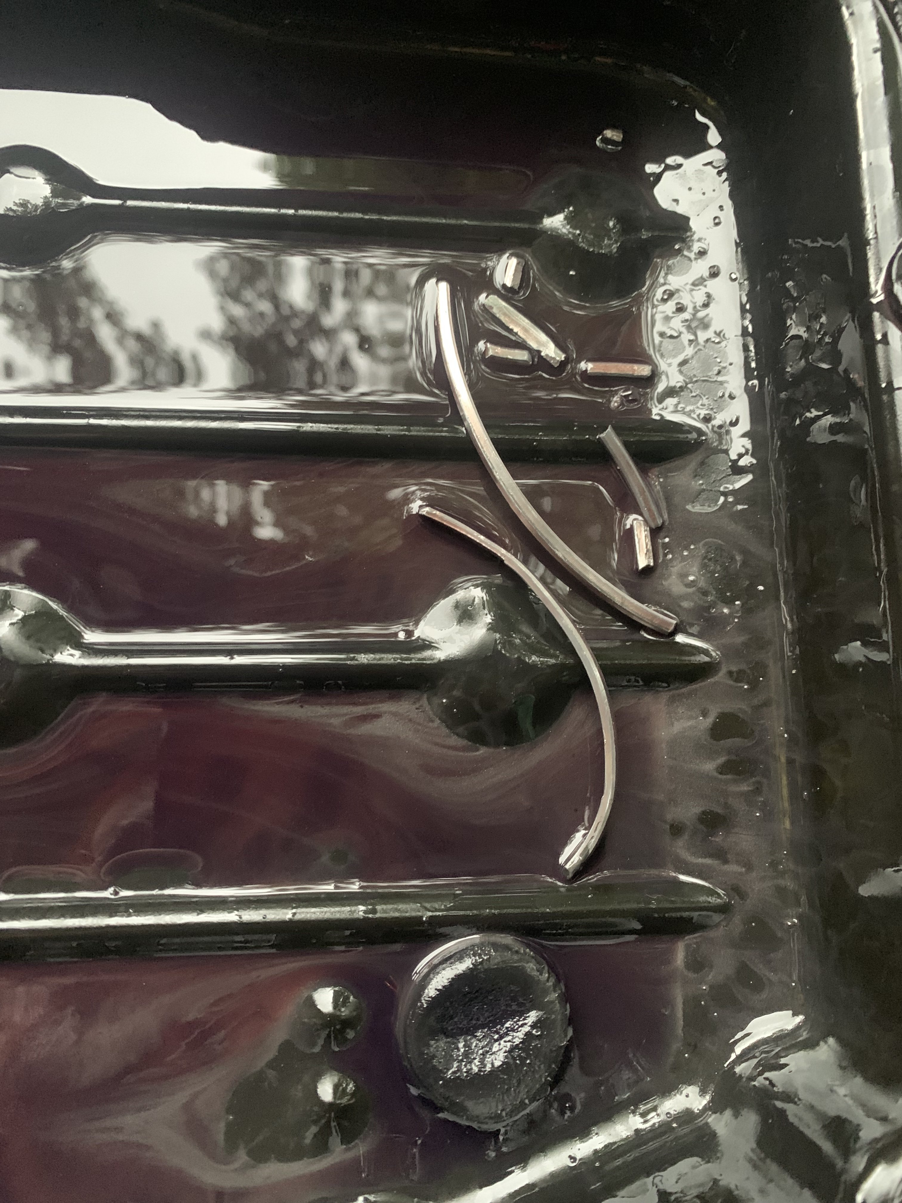

Corbin5754 Posted July 16, 2021 Author Report Share Posted July 16, 2021 Pulled the pan and this is what I find ? Quote Link to comment Share on other sites More sharing options...
Corbin5754 Posted July 16, 2021 Author Report Share Posted July 16, 2021 I’m probably going to buy a used transmission do you know what transmission it is Quote Link to comment Share on other sites More sharing options...
5rebel9 Posted July 16, 2021 Report Share Posted July 16, 2021 WELL .... I guess you saved by not spending money on the shift solenoid pack. Sorry that my unsaid hunch proved correct. I tried to look up just what trans. is in your 2.4 engined and found that listings showed either the 4 speed 41tes or the 6 speed 62te. You should be able to confirm just which you have by the gear speeds available from when it was running correctly. Most all here say that the 2.4 uses only the 4 speed 41tes, but like I said in looking it up on parts sites it shows both for the 2.4 motor. Good luck and keep in touch! Quote Link to comment Share on other sites More sharing options...
