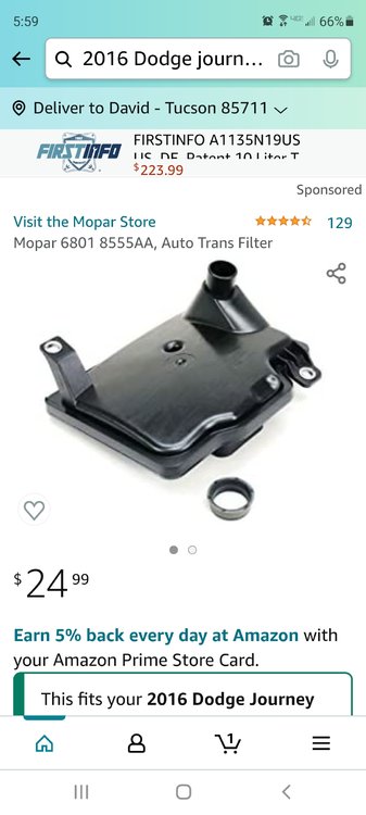

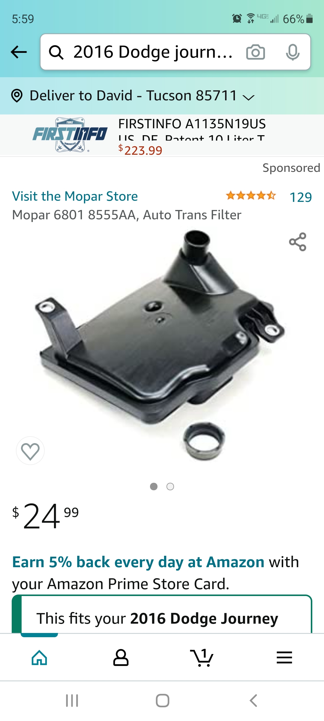

David Lake Posted July 18, 2021 Author Report Share Posted July 18, 2021 (edited) 2 hours ago, John/Horace said: My manual says 75W90 some where. The dealer only sells synthetic 75W90. Any good brand oil is fine, syn is better. I have used both dealer and Lucus brand syn. Rear is 900 ml approx and rdu is around 800, so almost a quart in each. Could buy a jug and use it for two changes, large jugs much cheaper. I would do tranny ATF+4 now as well, it's a fairly cheap semi synthetic oil. Thank you so much for that detailed response. Yeah that's the stuff I saw when I was looking on Amazon, so I ordered two quarts of it. I'll go ahead and do the transmission as well, even though the manual doesn't say it's required. Fluid is so cheap it's the smart thing to do. I found what looks like the right stuff on Amazon, some Mopar ATF +4. I guess my mechanic will know how much to add, but if you've got a number that'll help as well. According to Amazon this transmission filter is for my car. Does this look like the right thing or is there a different brand or style I should be looking for? Edited July 18, 2021 by David Lake Quote Link to comment Share on other sites More sharing options...
John/Horace Posted July 18, 2021 Report Share Posted July 18, 2021 I think I only paid dealer $30 for the correct filter. It's an important filter. Approx 5 quarts with a filter change pan drop. Can use a suction pump through dipstick with a hose and get about 4 quarts out. Filter change better. larryl 1 Quote Link to comment Share on other sites More sharing options...
