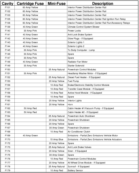

Brother_Dave Posted August 3, 2021 Author Report Share Posted August 3, 2021 Update: I changed the fuse again and the light went out, so SOMETHING is causing it to keep blowing. Quote Link to comment Share on other sites More sharing options...
tsteves5 Posted August 3, 2021 Report Share Posted August 3, 2021 The fuse chart below is for a 2011, so it might not match your 2013, but are you referring to Fuse F145? If so, it looks like that fuse does not feed anything else. It seems like you have either a damaged body computer, or perhaps a damaged wiring harness (a wire shorted to ground, two wires melted together, etc..). I've actually damaged previous vehicles providing jump starts in the past and I won't do it anymore. Modern electronics are really sensitive. I keep battery jump start boxes in all my vehicles now. I rarely need them for my own vehicles, but they've been used a bunch for helping out others. 2late4u 1 Quote Link to comment Share on other sites More sharing options...
Brother_Dave Posted August 3, 2021 Author Report Share Posted August 3, 2021 Yes. It’s F145. So the fact that it keeps blowing fuses is indicative of the BCM being bad? That answer makes the most sense but I’m not happy about it. Quote Link to comment Share on other sites More sharing options...
tsteves5 Posted August 3, 2021 Report Share Posted August 3, 2021 1 hour ago, Brother_Dave said: Yes. It’s F145. So the fact that it keeps blowing fuses is indicative of the BCM being bad? That answer makes the most sense but I’m not happy about it. It's honestly speculation on my part. If that fuse fed multiple devices then it could be any of the devices (or wiring/plugs to that device) that have failed as shorted and cause the fuse to blow. Since this fuse feeds only the body computer and indicator lamp, then there's not many other options. Quote Link to comment Share on other sites More sharing options...
tsteves5 Posted August 3, 2021 Report Share Posted August 3, 2021 Just now, tsteves5 said: It's honestly speculation on my part. If that fuse fed multiple devices then it could be any of the devices (or wiring/plugs to that device) that have failed as shorted and cause the fuse to blow. Since this fuse feeds only the body computer and indicator lamp, then there's not many other options. I just had another thought. Since the fuse does not blow right away but after the vehicle has been driven, I would personally be looking for wiring or connector issues. Perhaps some wire has the insulation worn (or burned) through and only shorts out with vibration or movement. Perhaps something inside the computer only fails with movement or vibration. It also might be temperature dependent, only happens if it gets hot for example. Locosiete 1 Quote Link to comment Share on other sites More sharing options...
