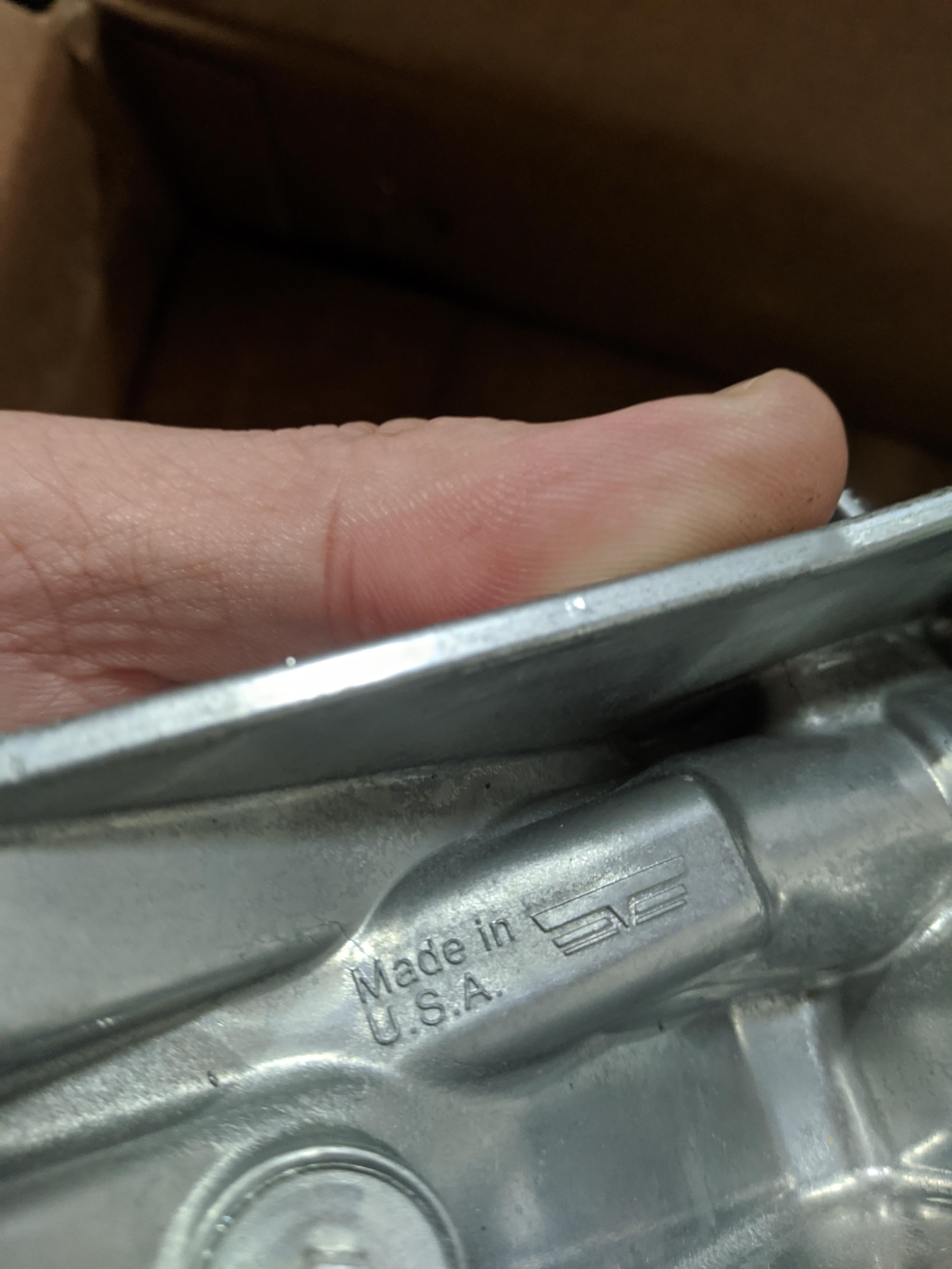

14WhiteRTRallye Posted November 25, 2021 Author Report Share Posted November 25, 2021 (edited) Dorman site... Made in USA - engineered and manufactured in the United States, and backed by a team of product experts with more than a century of automotive experience... Edited November 25, 2021 by 14WhiteRTRallye Quote Link to comment Share on other sites More sharing options...
agm2112 Posted November 25, 2021 Report Share Posted November 25, 2021 (edited) I Don´t know about US version, but my Journey is "Hecho en Mexico" ! Edited November 25, 2021 by agm2112 added images John/Horace 1 Quote Link to comment Share on other sites More sharing options...
John/Horace Posted November 25, 2021 Report Share Posted November 25, 2021 (edited) Also on bottom of Dorman casting is fussy but legible made in USA lettering. Visible in one of the pics on rockauto. Confirms that this definitely the best option. I’ve used Dorman stuff lots of times, never had any issues. So much automotive is China now, I just assumed. Glad to be corrected. Edited November 25, 2021 by John/Horace Quote Link to comment Share on other sites More sharing options...

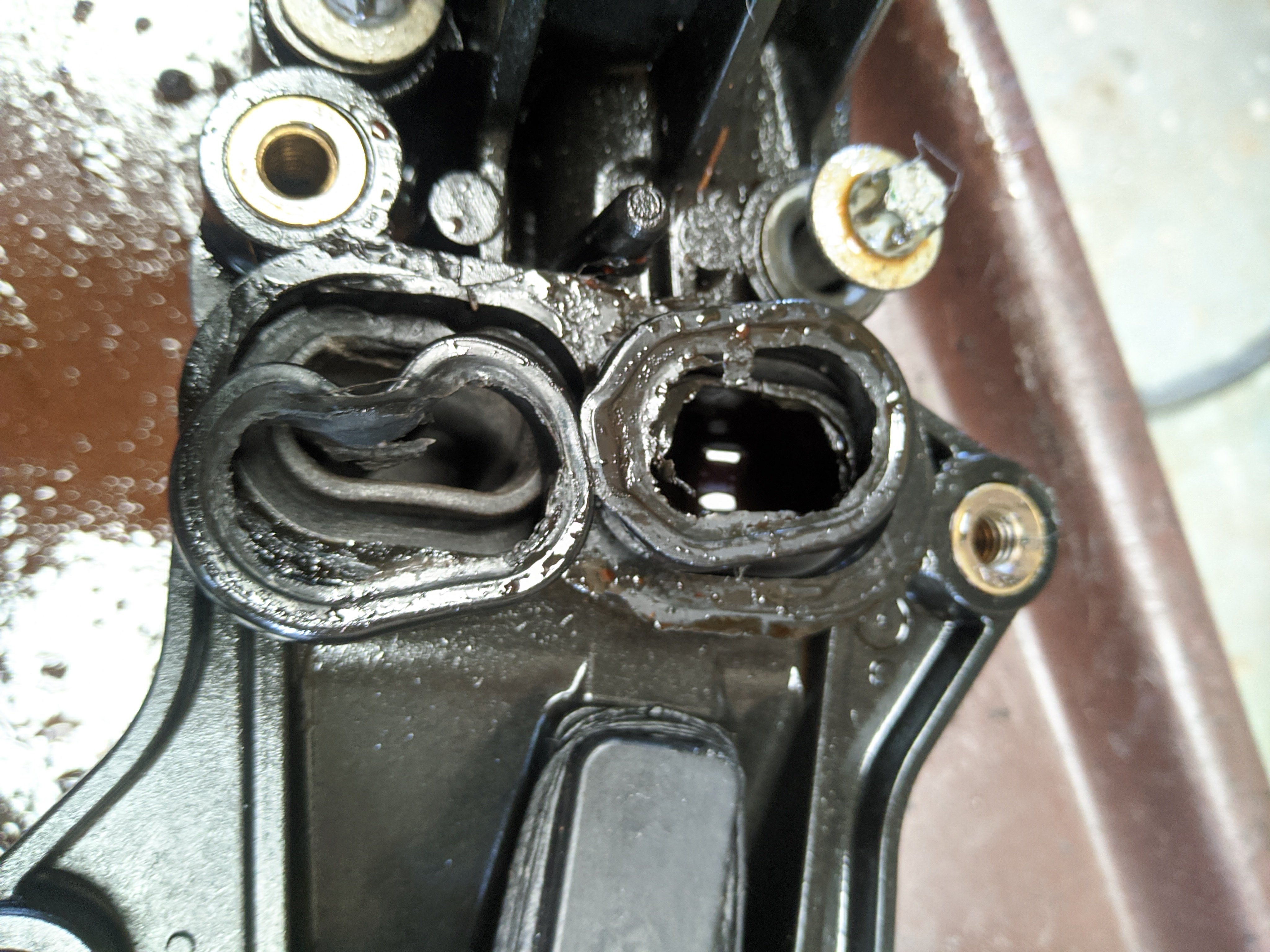

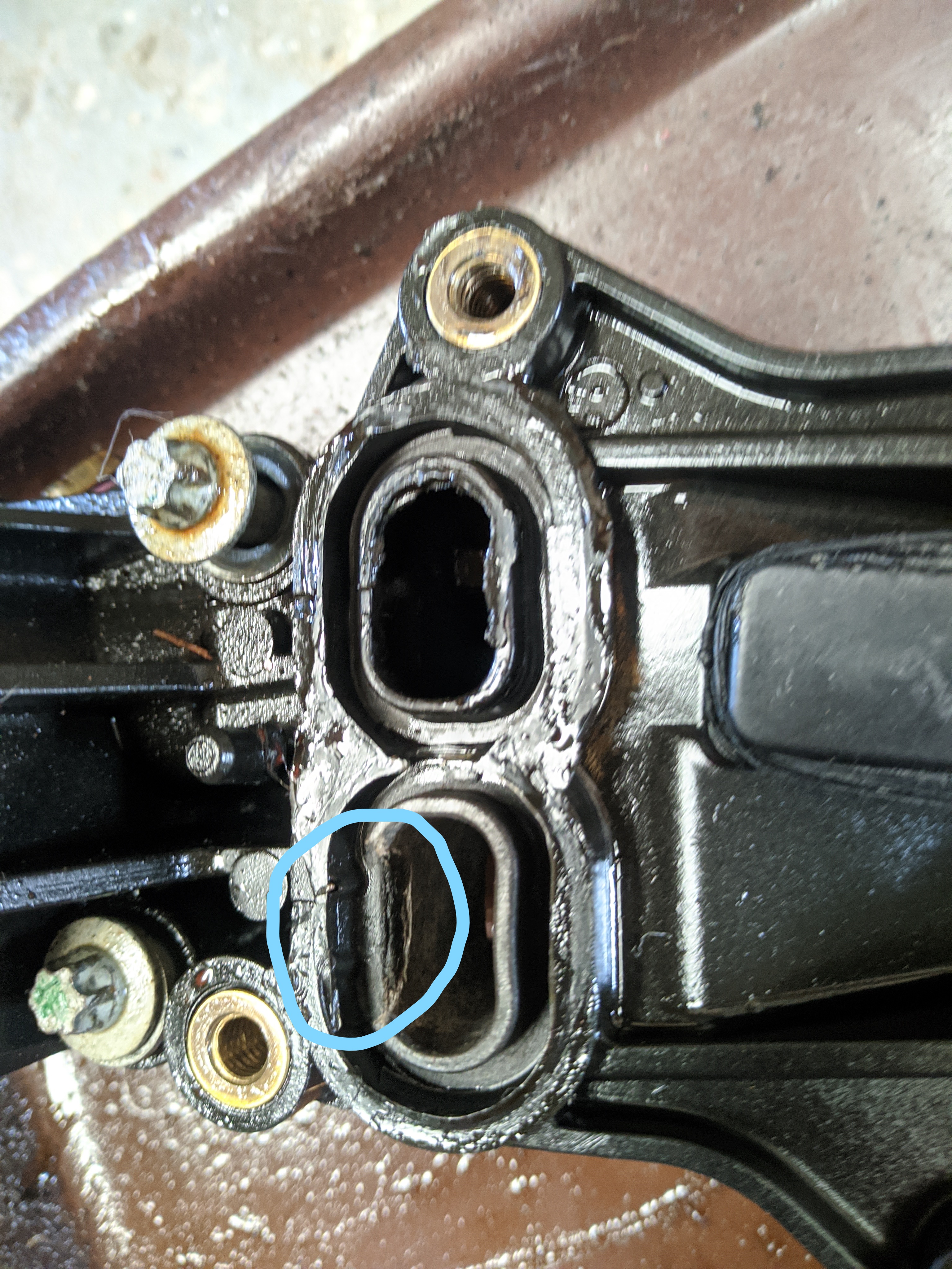

agm2112 Posted December 15, 2021 Report Share Posted December 15, 2021 Another ton of RTV while I wait for DHL delivery. This is my brand new crack. The seal "escaped" through the crack and starter another oil leak. Quote Link to comment Share on other sites More sharing options...
5rebel9 Posted December 15, 2021 Report Share Posted December 15, 2021 Is this where it mounts to the engine OR where it mounts the oil cooler? I've not taken one down to know myself from your excellent PIC's (but sorry to see such a fault). IF the cooler side, I'd think seriously about getting a new oil cooler also! Quote Link to comment Share on other sites More sharing options...
agm2112 Posted December 15, 2021 Report Share Posted December 15, 2021 Mine is cracked on both sides, on the cooler side and engine side. The other part I have (not OEM)is cracked, but I can´t figure out where (It leaks a LOT of oil). Quote Link to comment Share on other sites More sharing options...
5rebel9 Posted December 15, 2021 Report Share Posted December 15, 2021 On 12/15/2021 at 12:15 PM, agm2112 said: Mine is cracked on both sides, on the cooler side and engine side. The other part I have (not OEM)is cracked, but I can´t figure out where (It leaks a LOT of oil). Expand It sure will leak LOTS when engine is running and also at off time drain down . Did the proper tightening torque specs get used when this unit was replaced? Also since it was a plastic part (and even metal units) they should be tightened down in a pattern to EVENLY draw down the both parts involved. I've seen a couple of these motors "opened up" to see where / how the filter/cooler sits, and I don't look forward to wanting to do such replacement of this part on a regular basis! Quote Link to comment Share on other sites More sharing options...

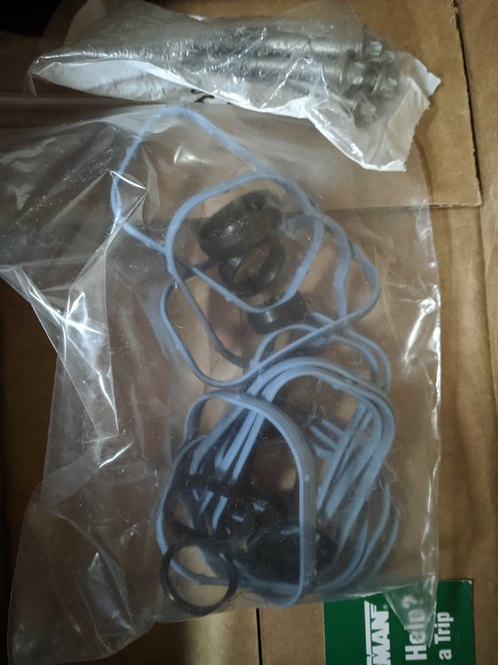

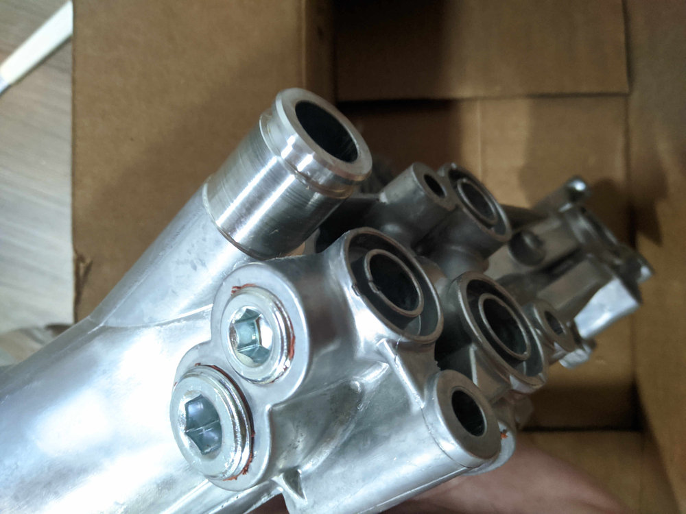

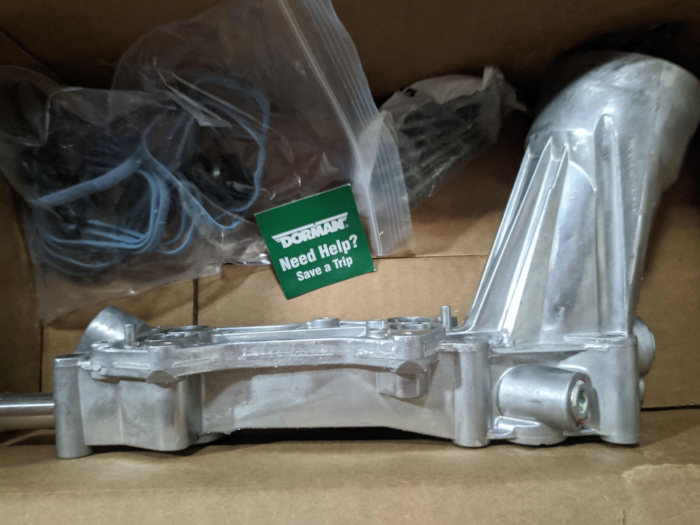

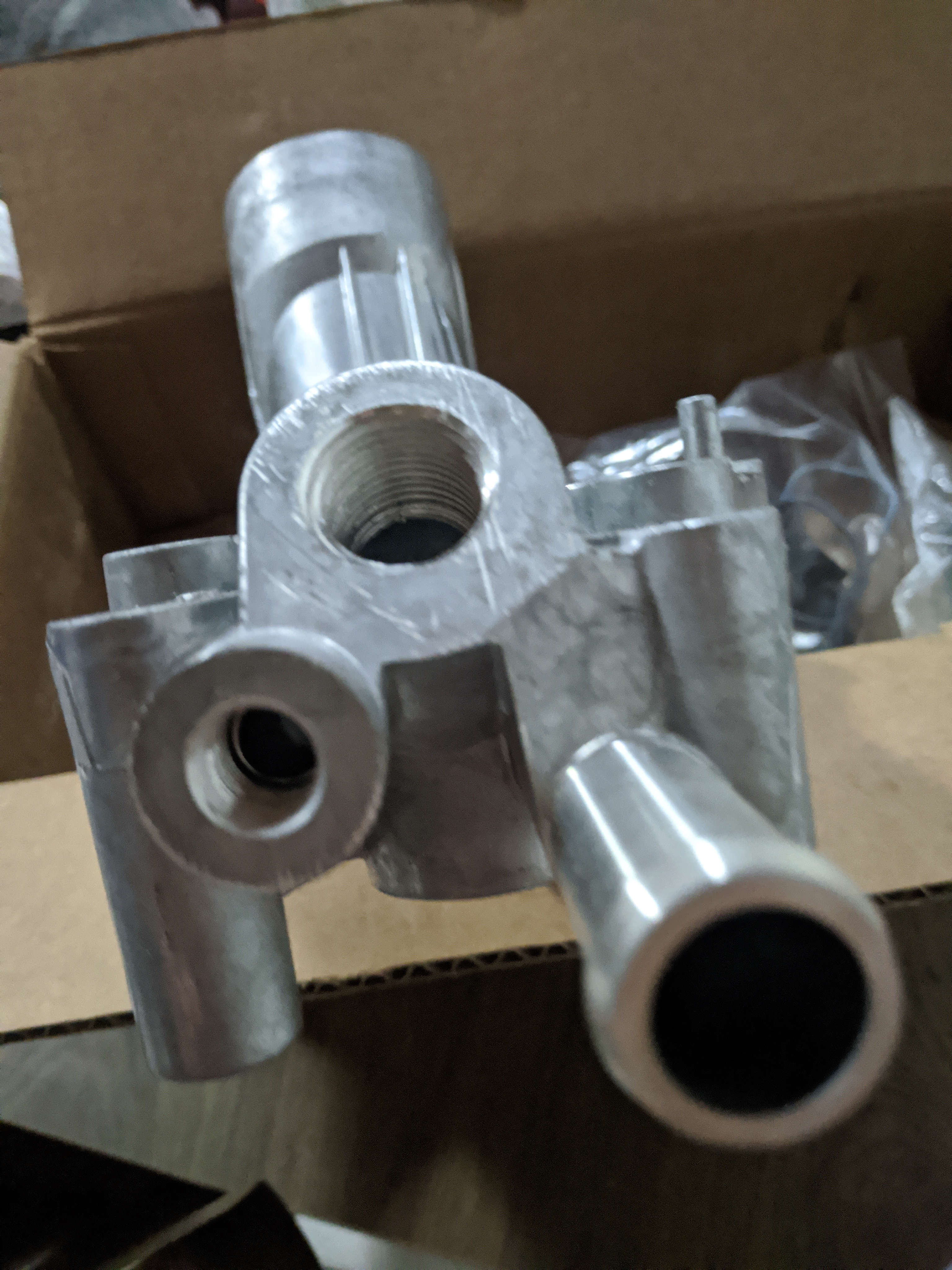

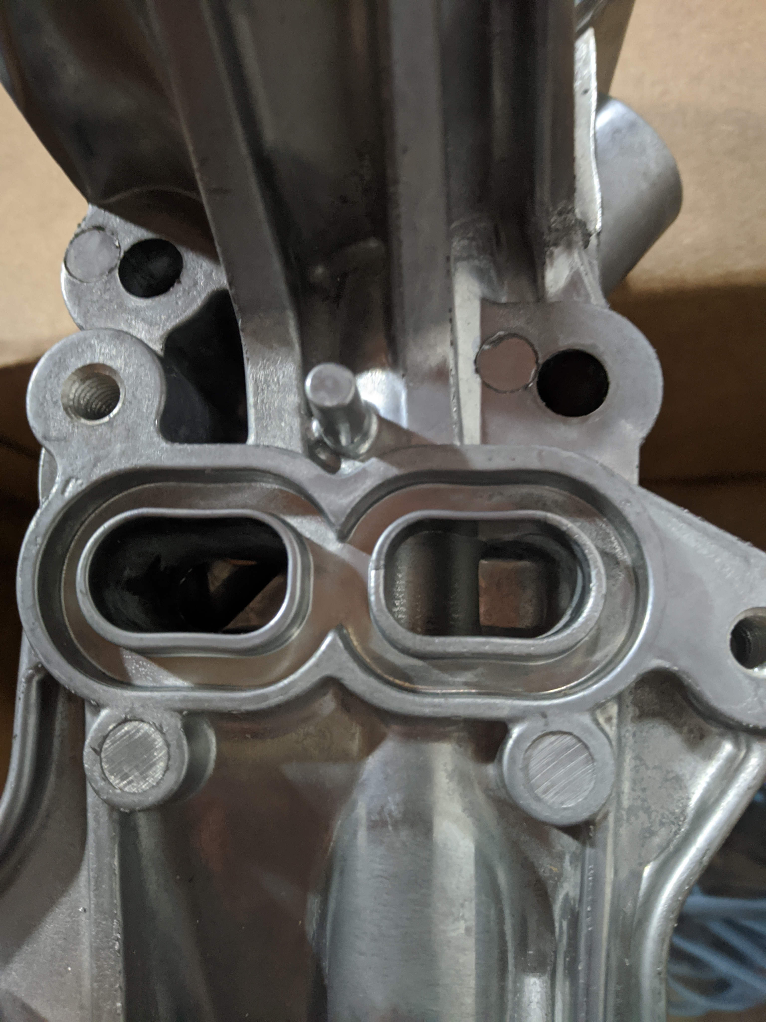

agm2112 Posted December 20, 2021 Report Share Posted December 20, 2021 (edited) Finally in hands. Hope to replace on weekend (Christmas ?). Seems very good stuff. Edited December 20, 2021 by agm2112 2late4u 1 Quote Link to comment Share on other sites More sharing options...
