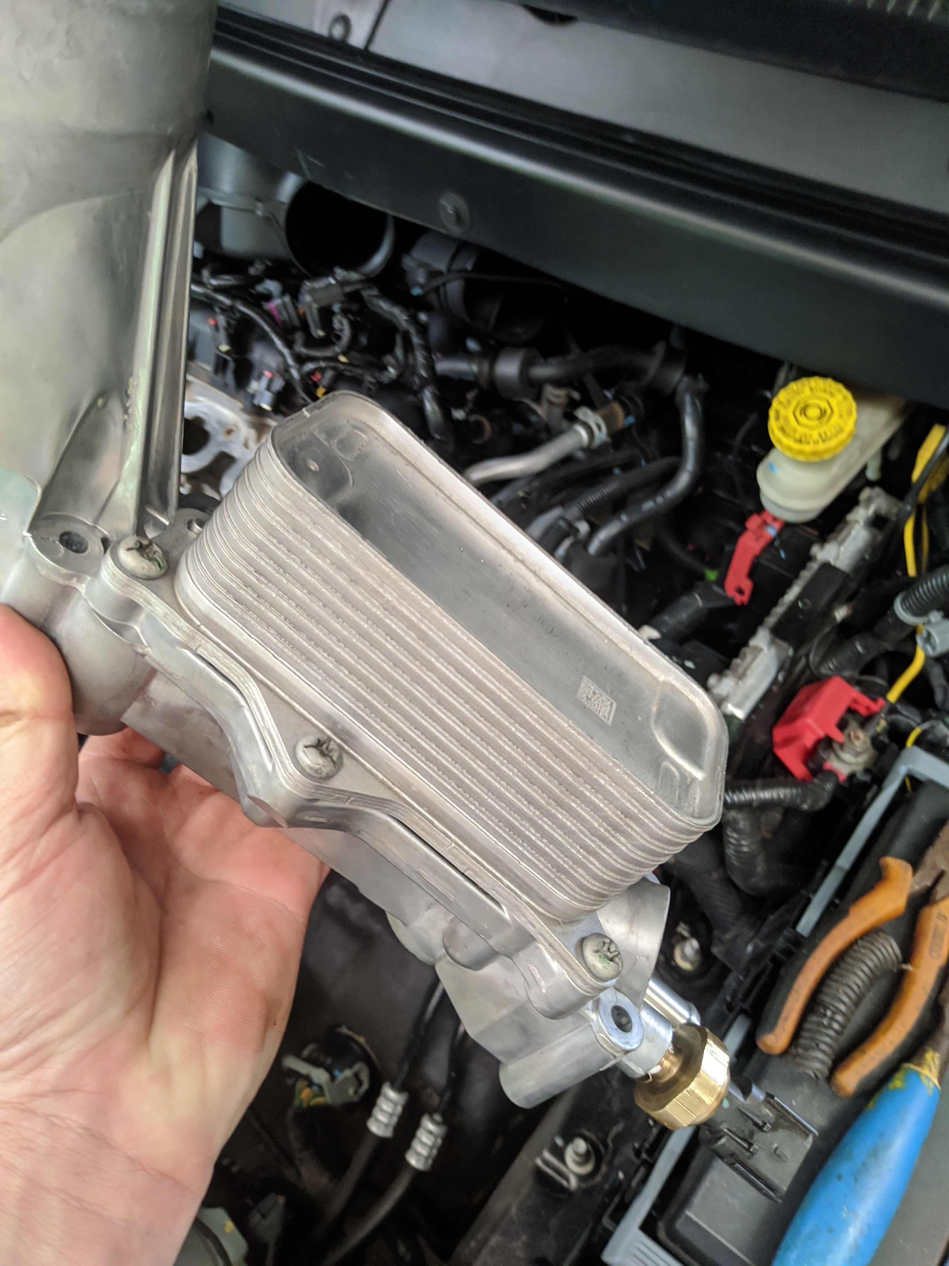

John/Horace Posted December 22, 2021 Report Share Posted December 22, 2021 Looks nice, more solid unit. The stainless steel plate heat exchanger and sensors all move over I guess. Use t-tape or pipe dope on sensor threads before reinstalling from your old plastic cooler. Thanks for the pics. Quote Link to comment Share on other sites More sharing options...
agm2112 Posted December 27, 2021 Report Share Posted December 27, 2021 Item replaced. By the cleanness of my airgun you can imagine the situation. The wiring of the knock sensors was also filled with oil. John/Horace, aviator79, 5rebel9 and 1 other 4 Quote Link to comment Share on other sites More sharing options...
5rebel9 Posted December 27, 2021 Report Share Posted December 27, 2021 Looking good on the progress as pictured! Yes, it's a pretty involving job to do along with cleaning out all that leaked oil. IF still not fully assembled, I'd try some spray electrical cleaner for the wiring and sockets to clear out oil. Have heard of oil in them causing problems. NICE WORK! John/Horace and agm2112 1 1 Quote Link to comment Share on other sites More sharing options...
agm2112 Posted December 27, 2021 Report Share Posted December 27, 2021 Yes, I spent an entire can of "electric contact cleaner" on the wiring, contacts, knock sensors and oil pressure and temperature sensors. The heat shield of the knock sensors were destroyed by the oil, I made a "fix" with aluminium foil. aviator79 and 5rebel9 2 Quote Link to comment Share on other sites More sharing options...
