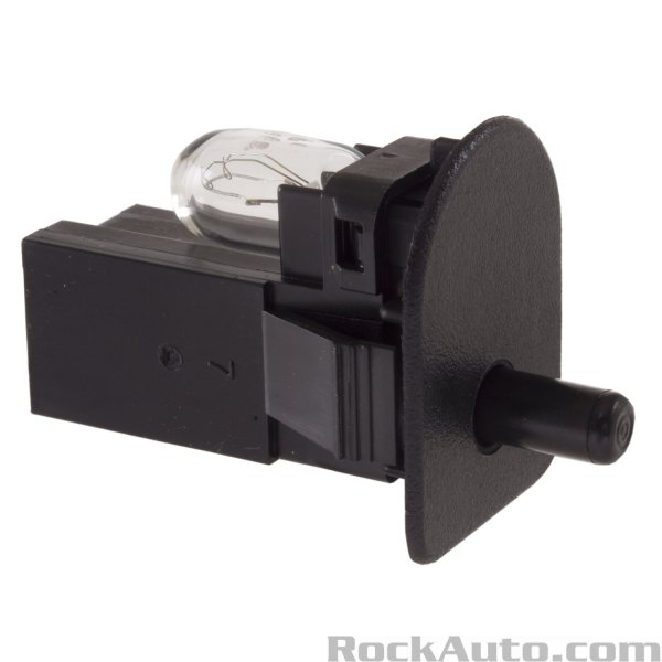

John/Horace Posted November 9, 2021 Report Share Posted November 9, 2021 (edited) There are dozens of reasons why remote start won’t work. No check engine light doesn’t mean there aren’t any codes. Get someone with an obd scanner to check and gives any codes if they show up. The hood switch is most common thing to disable remote start. It’s on passenger side right up close to grill, mounted on sheet metal. Try cycling a few times then hold it down firmly and press start button twice. It might not be getting enough pressure. Looks similar to switch in picture, without the bulb. Could have dirty contacts, contact cleaner spray might help. I don’t think 4 ways flashing is related, but it’s possible. Edited November 9, 2021 by John/Horace jkeaton 1 Quote Link to comment Share on other sites More sharing options...
