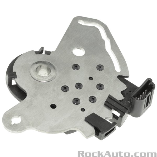

John/Horace Posted November 10, 2021 Report Share Posted November 10, 2021 Besides fluid pan filter and solenoid, I would consider changing neutral safety switch while you are in there. Wear item. Not expensive, around $40 oem on Rockauto. Quote Link to comment Share on other sites More sharing options...
Wade Posted November 10, 2021 Author Report Share Posted November 10, 2021 1 hour ago, John/Horace said: Besides fluid pan filter and solenoid, I would consider changing neutral safety switch while you are in there. Wear item. Not expensive, around $40 oem on Rockauto. Thanks again! You guys have been most helpful to a new guy here Quote Link to comment Share on other sites More sharing options...
John/Horace Posted November 10, 2021 Report Share Posted November 10, 2021 https://www.rockauto.com/en/catalog/dodge,2013,journey,3.6l+v6,1505070,electrical-switch+&+relay,neutral+safety+switch+/+range+sensor,4584 Quote Link to comment Share on other sites More sharing options...
