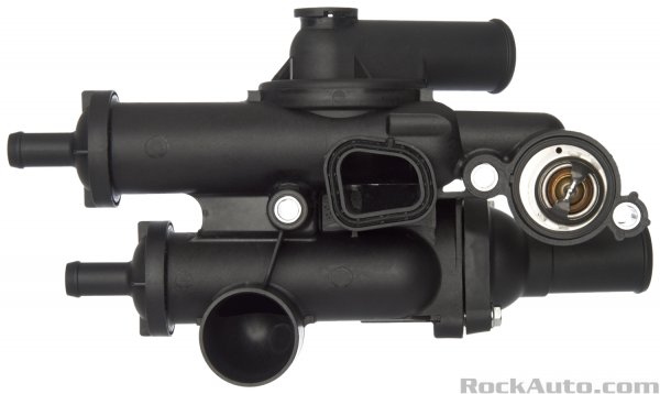

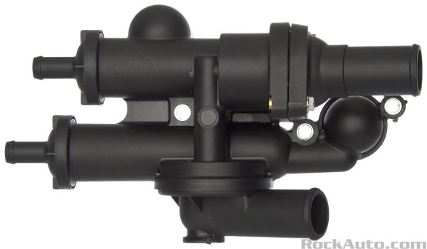

John/Horace Posted November 10, 2021 Report Share Posted November 10, 2021 Are both gauges showing the high temperature, is what I was asking. Always start with making sure glycol level is ok, leaks can cause low level and temp variances. If you are changing thermostats ( they are a wear item and it may be your problem) buy the coolant assembly that has both engine and cabin temperature thermostats in it, cheaper way. This assembly tends to leak at higher mileage, it did on daughter in laws 2.4 engine. Assembly not hard to swap, took me about an hour total. Temperature gauge can be moved over to new assembly, it doesn’t come included with new set up. https://www.rockauto.com/en/catalog/dodge,2014,journey,2.4l+l4,3038628,cooling+system,thermostat+housing+/+water+outlet,10337 Quote Link to comment Share on other sites More sharing options...

John/Horace Posted November 11, 2021 Report Share Posted November 11, 2021 My daughter in laws 2012 heat/cool manifold had a small leak which is why I changed it. The Gates assembly came with a new large 1.5” diamo ring for back pipe connection. Cooling temp probe on top is reused and moved over to new assembly, new small 3/8” ish oring for that was not included. Found one on a universal oring assortment kit I have. Buna material. If you buy each gasket and oring and thermostat and thermostat seal individually, it’s more than double the cost. There will be a Mopar assembly available as well. Quote Link to comment Share on other sites More sharing options...
