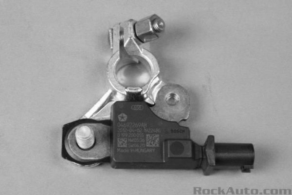

2late4u Posted December 22, 2021 Report Share Posted December 22, 2021 that part that broke was probally the battery temperature sensor and that will keep a car from running...is this the part that was broken on amazon....Battery Sensor Compatible with 2011-2021 Chrysler Jeep Dodge Ram Replaces# 4692269AI Battery Temperature Sensor Quote Link to comment Share on other sites More sharing options...
Pittiemama Posted December 22, 2021 Author Report Share Posted December 22, 2021 2late4u- Thanks for replying Yup it sure is. But the problem started prior to me breaking this, I took it off to clean the terminals and connections. Also nothing got worse til a couple weeks later. Quote Link to comment Share on other sites More sharing options...
John/Horace Posted December 22, 2021 Report Share Posted December 22, 2021 (edited) It’s a some what fragile part in an awkward spot. I’m not surprised they get broken. Rockauto, who I don’t work for are a great source of oem and after market parts. Good selection and prices. https://www.rockauto.com/en/catalog/dodge,2011,journey,3.6l+v6,3015205,electrical,battery+temperature+sensor,10478 Edited December 22, 2021 by John/Horace Quote Link to comment Share on other sites More sharing options...
