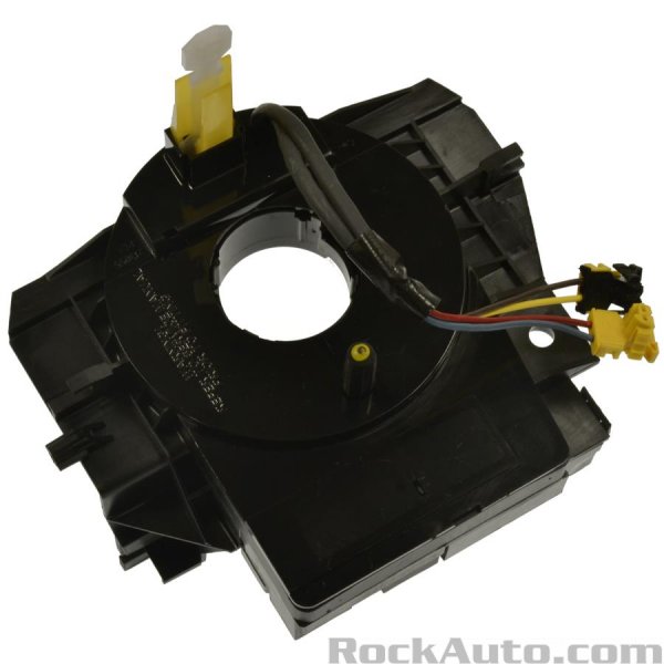

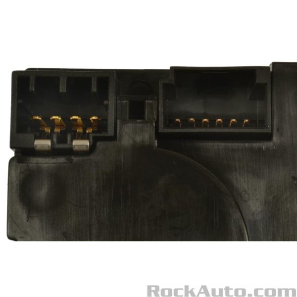

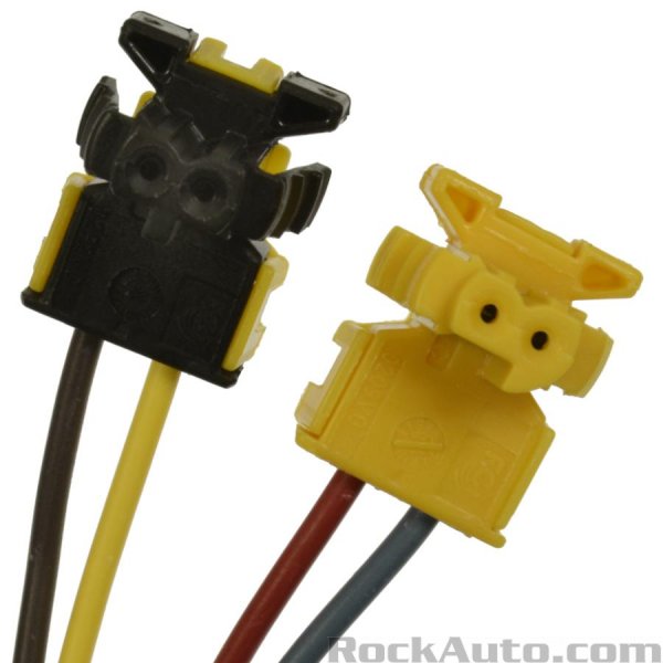

There was no 2008 model Journey, started 2009 model year. Date of manufacture could be 2008, but it would be considered a 2009.   Oem part is out of stock, two aftermarket listed. I would reset all plugs first with battery unhooked, might clear it long enough for your inspection. Might be safer to get number off your actual part before ordering, not a cheap part.
Good luck.
https://www.rockauto.com/en/catalog/dodge,2009,journey,3.5l+v6,1442283,interior,air+bag+clockspring,10480
10298726-3F7E-440F-BA61-13D61E11134D.jpeg.d36626299a4e8060129ac54802a4efc0.jpeg8C0CBC2A-0293-4FD7-AE2F-0654E6188F1F.jpeg.07a96d17f6defca3c90f43d29c3e44a6.jpegCB3D5D9E-28C8-47C7-A1B7-A55F9BADEDB3.jpeg.2eaa17ccf32b52a9f87c9b49ec820cf4.jpeg

Thank you John for the information about the year. I was not quite sure about it because the first owner of this car has registered first day of usage December 23th 2008. Thank You also for the link to the parts. I will forward it to my dealer. The Mopar part number is 05156106AG.
