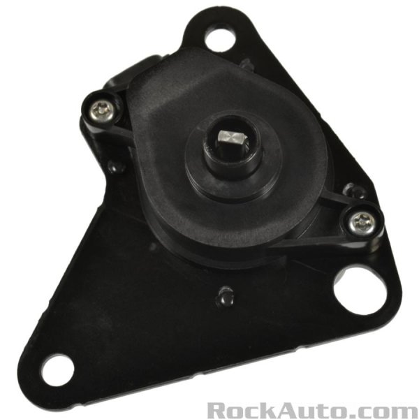

John/Horace Posted February 2, 2022 Report Share Posted February 2, 2022 It’s listed on Rock, they are pretty accurate usually. Look for the electrical plug. https://www.rockauto.com/en/catalog/dodge,2010,journey,2.4l+l4,1444631,engine,intake+manifold+runner+control+valve+/+solenoid,10776 Quote Link to comment Share on other sites More sharing options...
brossachiotte Posted February 2, 2022 Author Report Share Posted February 2, 2022 i think he has got one from scrapyard but since he couldnt find the wiring, like he doesnt see any connectors laying around where this part is supposed to be he hasnt installed it ill ask him tomorrow since he had the car for years and never had that part (crazy enough) you think that could start making the engine misfire just now? i guess he should measure fuel pressure thanks for reply ill keep you posted Quote Link to comment Share on other sites More sharing options...
