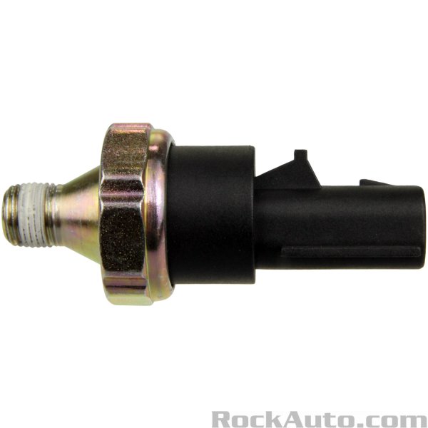

I think adding sensor at existing sensor spot might be easier. Looks like 1/8”” npt thread on oem.
So a small 2-3” extension to a tee fitting where exiting sensor and a spot for second either analogue or digital gauge can go.
Use t-tape or pipe dope on all connections. Pics of factory sensor and threads.  Are you having oil pressure issues making you want second gauge?
