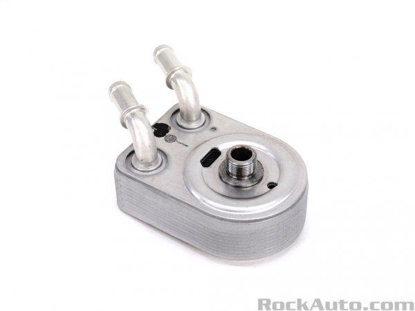

larryl Posted February 9, 2022 Report Share Posted February 9, 2022 Could also be your oil filter cooler housing has blown up antifreeze runs through there also Quote Link to comment Share on other sites More sharing options...
John/Horace Posted February 9, 2022 Report Share Posted February 9, 2022 56 minutes ago, larryl said: Could also be your oil filter cooler housing has blown up antifreeze runs through there also It’s not the plastic cooler like the 3.6 that seems to have lots of issues (mainly around 2014 design change) with. The 3.5 is a stainless steel plate pack heat exchanger with a few gaskets, no plastic I believe. My brothers 3.5 went 330 k kilometres without heat exchanger issue. Pic of unit from rock. It’s timing belt engine, so water pump is often changed during belt change because it’s buried behind covers and belts. Timing belt is due for change, years and miles both call for it. 2late4u 1 Quote Link to comment Share on other sites More sharing options...
2late4u Posted February 9, 2022 Report Share Posted February 9, 2022 i think you are confusing that engine with the 3.6 that does route coolant thur the oil cooler, that said his response to adding oil but that wasnt the problem then notices coolant tank empty then refills it then it is low again after driving and sees it leaking he needs to take it to a qualified garage for a diagnostic and repair Quote Link to comment Share on other sites More sharing options...

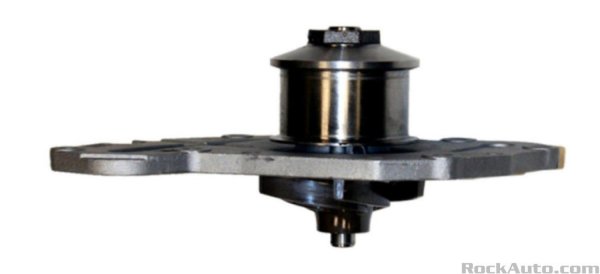

John/Horace Posted February 10, 2022 Report Share Posted February 10, 2022 Timing belt driven water pump pics. It’s hidden behind plastic covers on front of engine. Time consuming repair. Quote Link to comment Share on other sites More sharing options...
