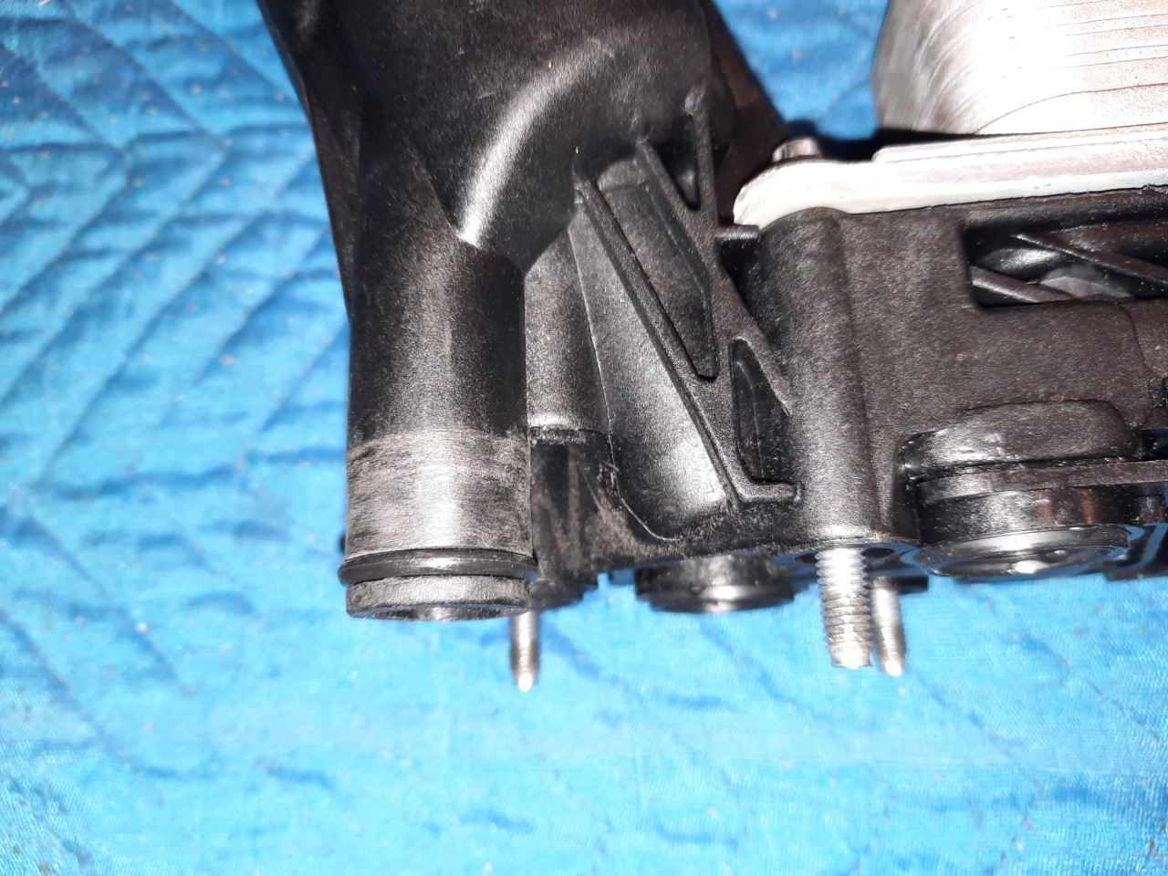

RebelPanda Posted March 1, 2022 Report Share Posted March 1, 2022 (edited) Hi there. Just to let you all know, I have visited the forums before but I have never posted so if I posted in the wrong area, I'm sorry! I have a 2014 Dodge Journey Limited with the 3.6L. It just tripped 200,000 miles yesterday. Here is the problem I have. The oil filter housing started leaking really bad. I ordered a new one and replaced. It came with all new gaskets and a new o-ring. After replacing, it didn't fix the issue. I went to the dealer and bought all new gaskets and o-ring (comes as a set). Replaced the gaskets and o-ring and it's STILL leaking. Added UV oil dye, It's leaking at the o-ring. Might be leaking somewhere else as well, but I don't believe so. I haven't taken the upper and lower intake plenums off again to go over the entire unit with the UV light. Figured I would ask here before doing all of that again. How do I get this o-ring to stop leaking? Honestly I'm at the point of either buying the Alum Dorman one (I didn't do that because the vehicle has 200,000 miles) or trying some RTV to seal it up. I have a another set of gaskets and an o-ring but I hesitate to change the o-ring out again because I honestly think it will just continue to leak. Can anyone enlighten me here before I push this vehicle off a cliff??? I took the liberty of including a picture pointing to the leaking o-ring. I don't want to start bad mouthing my Journey, after all it's got 200,000 miles on it! I know some people complain about Mopar, but I have spent less than 2 grand in repairs since 2014 on it. Edited March 1, 2022 by RebelPanda Left out engine size Quote Link to comment Share on other sites More sharing options...

tsteves5 Posted March 1, 2022 Report Share Posted March 1, 2022 @RebelPanda A few months ago, I used an aftermarket oil cooler and had issues with that exact same port that you identified. In my case, the diameter of the port was too wide and it wouldn't seat properly. I had to grind it down with a Dremel to get it to fit and seal properly. It's been working fine since then. 2late4u and John/Horace 2 Quote Link to comment Share on other sites More sharing options...
RebelPanda Posted March 1, 2022 Author Report Share Posted March 1, 2022 TSTEVES5, that worked out well for you then! I thing mine is the opposite. To small. 2late4u 1 Quote Link to comment Share on other sites More sharing options...

agm2112 Posted March 3, 2022 Report Share Posted March 3, 2022 Isn ´t there any kind of sludge, scratch or debris on the engine side ? It is leaking on the oil pump exit, high oil pressure. I solved my problem by using a Dorman aluminium housing. Quote Link to comment Share on other sites More sharing options...
RebelPanda Posted March 6, 2022 Author Report Share Posted March 6, 2022 Ok. I have an update for your all. First, thank you once again for all the advice, experience shared, and suggestions. I did purchase the OEM unit and got it in today. I drove it at highway speeds for awhile and I see no new oil leaking so I think my nightmare is OVER. I had added UV dye to try and determine where the leak was. Looks like the leak was from at least one of the round plugs that are "welded" in place Which happens to be almost right over top of the area I had circled (and also the red arrow pointing to). It does look like it was leaking from that place as well. So this is the end of my thread. Thanks everyone!!! Summer Solstice and 2late4u 2 Quote Link to comment Share on other sites More sharing options...
