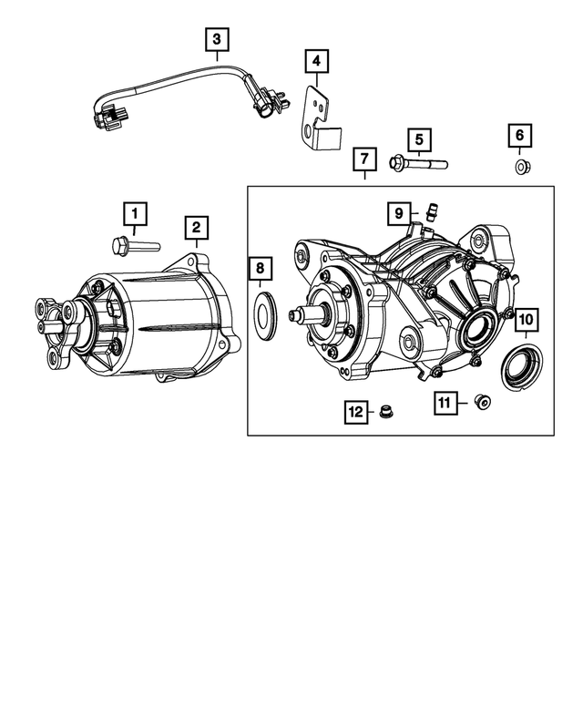

Also does anyone know what the proper name for the sensor that plugs into the rear diff.? I assumed that it would be a speed sensor but no automotive parts store can see anything. So I called Dodge and they have no listing or can even bring up a picture of a sensor for the rear diff. I have seen it on Moparparts canada says it's #3 then go to the number list and there is no #3
Specialized parts like that are probably dealer only. Dealer didn’t want to invest time in getting you a part number so you could buy it cheaper on line, maybe.
This site is decent for pricing and ships stuff.  Need to search for part.
https://parts.motorcitychrysler.ca/p/Automatic-Transmission-Assembly-WITH-TORQUE-CONVERTER-Automatic-Transmission-Assembly/78900680/R8090720AH.html
Not sure of part name,  manual calls is rdu or rear drive unit I think. Might be in electrical parts section. If plug is damaged you might be able to solder and heat shrink the connections. Plug is only needed for removal really.
Yup that's the exact pict I was looking at.

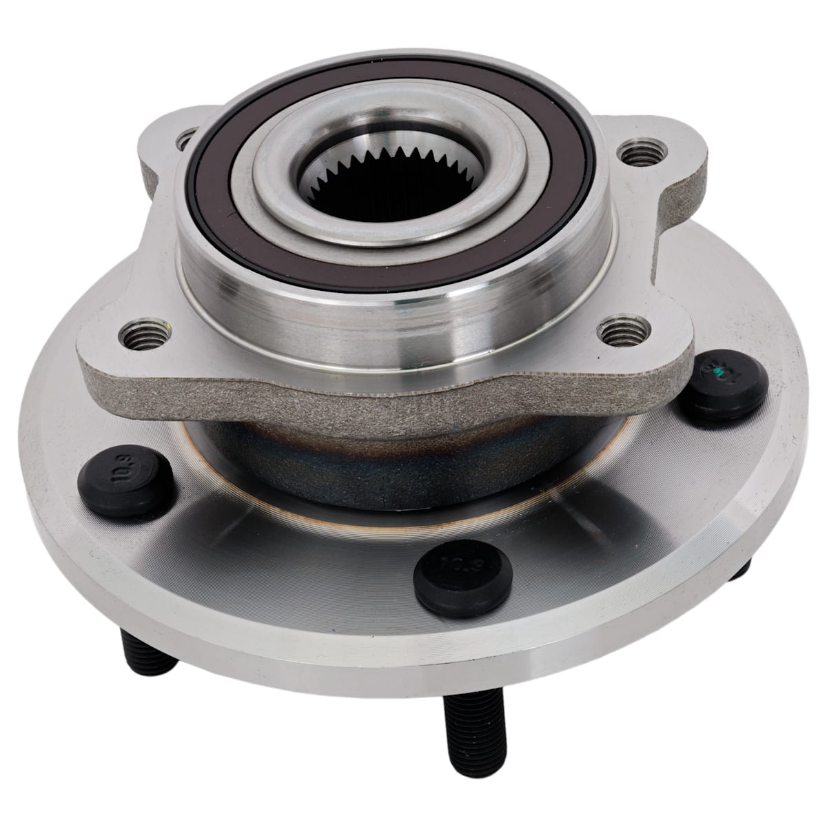

So the local garage scanner found 3 codes first on the list was that my front right tonner is gone. First I have ever heard of this part. They told me there that it's a magnet ring that goes in around the wheel barring different methods for different vehicals. So it needs a new wheel barring/hub. Then the other two codes say that it's failing to get a signal from both rear ABS sensors. He figures that because where I had both axels removed when it went into this fault. First replace the barring and go from there. It should solve the dash light issues.
actually the tone ring is built onto the cv axle at on all i have ever seen as it spins around ,the abs wire sensor  pickup sends the signal to the computer. i am sure that is how it has on journeys as well, that said your wheel bearing as well could be going bad and that as well can cause a wheel speed sensor to show as bad   depending on how many miles you have on your journey.....here is a link showing replacing a tone ring,,( i didnt even know it could be replaced but for the trouble and cpost a new cv axle would be the quicker and easier solution as well)
