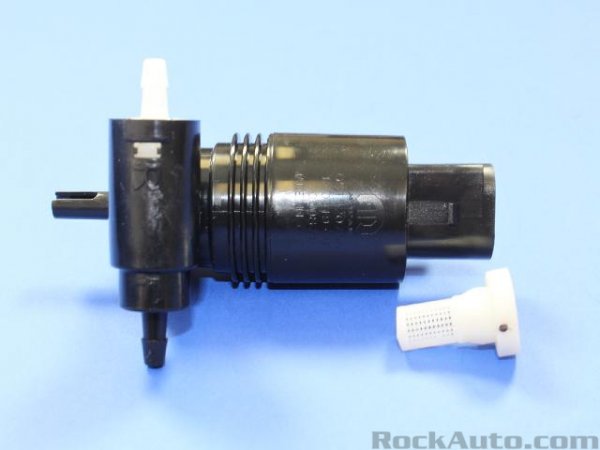

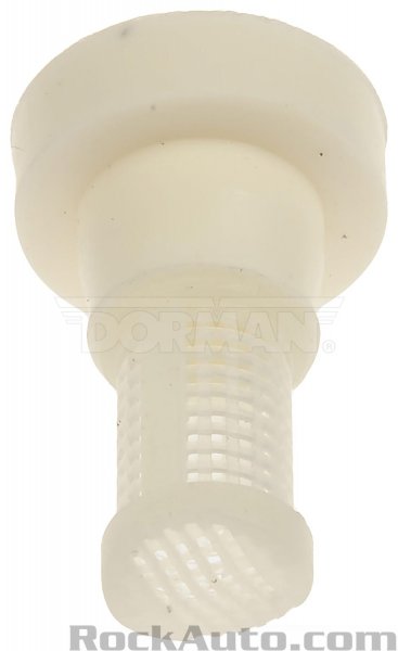

Welcome to the forum.  The washer pump grommet could be allowing tiny amount of air into system. Pump will cavitate from the air and not pump properly. Sitting over night allows the air to escape to top of reservoir so it works again.
Mopar pump comes with new grommet automatically, some after market don’t. Part can be bought separately.
https://www.rockauto.com/en/catalog/dodge,2012,journey,2.4l+l4,1502335,wiper+&+washer,windshield+washer+pump+grommet,11107
