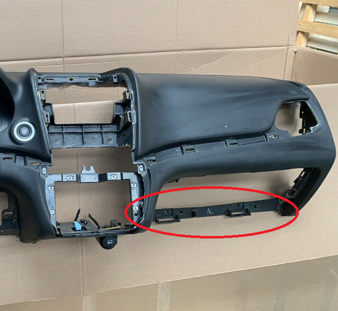

the only issue was a broken glove compartment hinge, So we went to a junk yard and cut the section out of the inner dash board,
went home cut out the broken one, bolted in the new one added some JB weld plastic on either end, And now it is as good as new.
a dealership wanted to charge me $800 to fix the problem.
I did it for under $10
