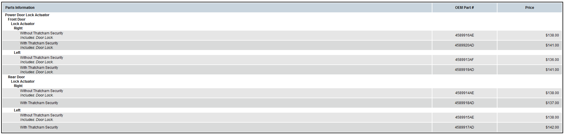

tsteves5 Posted March 14, 2022 Report Share Posted March 14, 2022 From AllData Quote Link to comment Share on other sites More sharing options...

tsteves5 Posted March 15, 2022 Report Share Posted March 15, 2022 On 3/14/2022 at 3:19 PM, tsteves5 said: From AllData Expand Sorry, my bad. I thought you were asking for door lock actuator, not the air door actuator. Above is for door locks. RF123 1 Quote Link to comment Share on other sites More sharing options...
