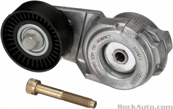

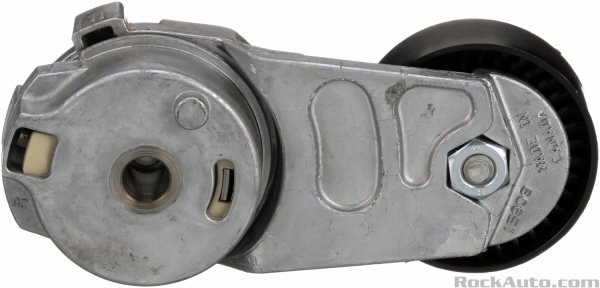

John/Horace Posted March 22, 2022 Report Share Posted March 22, 2022 (edited) Did the threads strip out with the bolt.? If bolt turned the wrong way, tensioner bracket could be damaged. Pic of threads might help. Often pulley has to come off so tensioner bracket mounting bolt can be accessed anyway. Make sure nut behind tensioner pulley is still there now. Edited March 22, 2022 by John/Horace Quote Link to comment Share on other sites More sharing options...
John/Horace Posted March 22, 2022 Report Share Posted March 22, 2022 https://www.rockauto.com/en/catalog/dodge,2010,journey,3.5l+v6,1444632,belt+drive,belt+tensioner,11659 Quote Link to comment Share on other sites More sharing options...
cnoke Posted March 25, 2022 Author Report Share Posted March 25, 2022 I had no idea that nut was behind there in the first place. THANK YOU! UPDATE: I called a mobile mechanic and he helped me drop the motor enough to replace the whole tensioner pulley mechanism... This was a success. I also replaced the idler pulley (super simple just do it anyway if replacing tensioner pulley.) and alternator which I was doing in the first place anyway. and new belt. We had to unbolt motor mount. on belt side. we also had to unmount Bottom undercarriage brace(forget name of part) too. so motor would drop a little more for access. we tried raising the motor and lowering. and raising and lowering several times. The majority of the problem is accessing the tensioner pulley to remove and replace. Thank you for your input and time and consideration on my problem! John/Horace 1 Quote Link to comment Share on other sites More sharing options...
