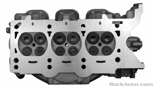

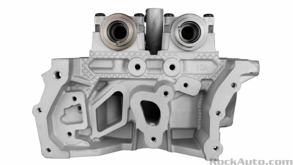

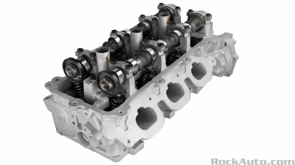

John/Horace Posted April 16, 2022 Report Share Posted April 16, 2022 (edited) I have never removed a Journey cylinder head. Man that’s a big job. Here is a few pics of a left reman head, hope it helps maybe. You need it for recore I assume, needs to be in good shape. Tapping with a brass mallet on a beefy spot might separate gasket from head. Stuff can get welded together by the heat. Use a good torque wrench on the reassembly. Edited April 16, 2022 by John/Horace Raiderfan717171 1 Quote Link to comment Share on other sites More sharing options...

John/Horace Posted April 16, 2022 Report Share Posted April 16, 2022 Bottom view here. Could be another fastener, can you study the reman head going on. Quote Link to comment Share on other sites More sharing options...
